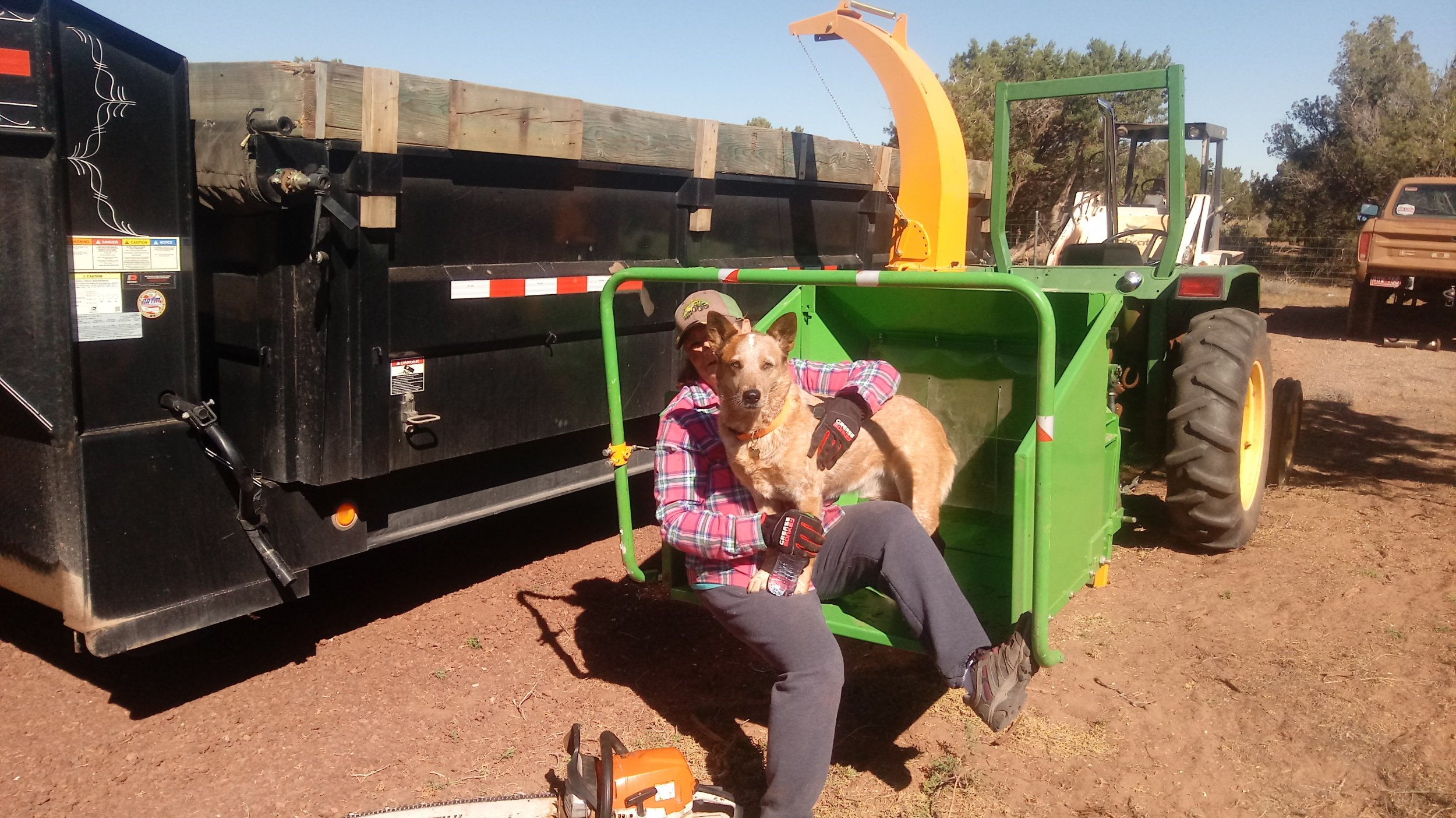

/ Chipper recommendation #4
I recommend one with two infeed rollers and a clam shell type flywheel housing. This is the one I have but use the tractor remotes for hydraulics. This one is self contained. I use a 33 hp JD970 but, like you, anything over 3" is fire wood.
BX72RSH heavy duty wood chipper

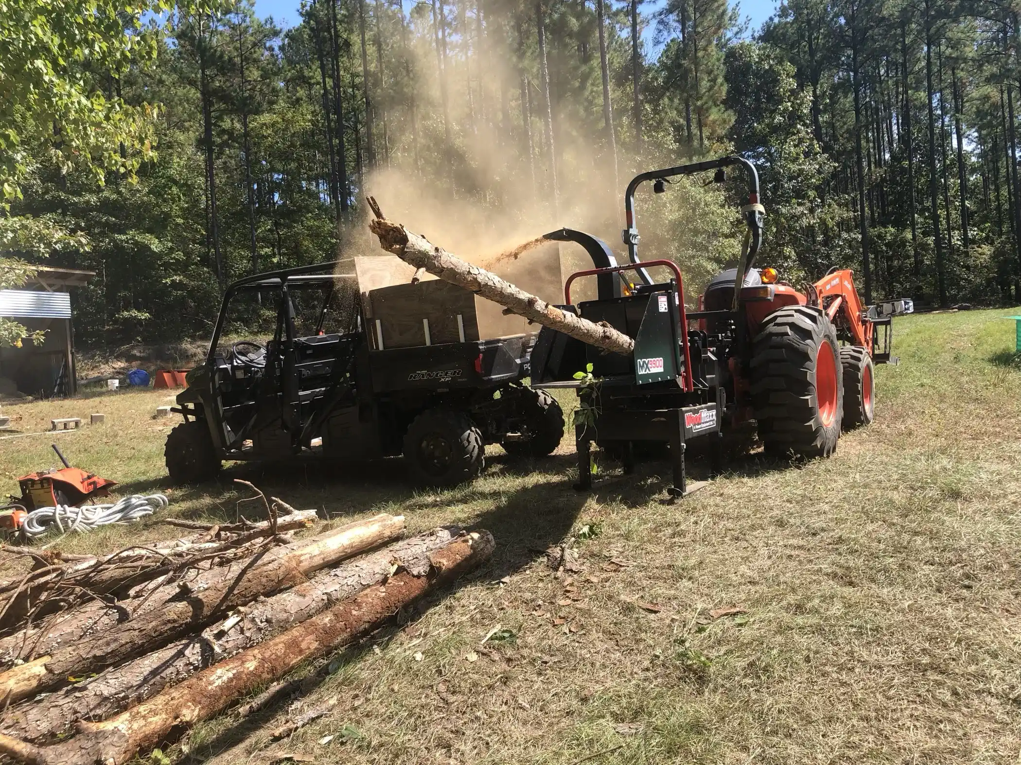

My chipping operation does not match what most are doing. I have 80 acres and it's covered with stands of Ponderosa pines. So...every other year or so - I thin and chip the stands of young pines. 800 to 1200 small pines ( 1" to 6" on the butt ) in one operation.
I - identify - fell - drag to piles - pull and chip from the piles. A single stand will end up looking like a giants game of Pick-Up-Sticks. Then I drag all the fallen trees to a pile. I will usually end up with ten to twelve piles. This project can take up to two months.
I have a Wallenstein BX62S. It's gravity feed and works very well. No limbs are ever trimmed - just feed the tree, butt first - into the chipper.
I've had two Wallenstein PTO chippers. First was the BX42S - now the BX62S. Wallenstein makes a superior chipper. The BX62S is powered with my 62hp Kubota M6040.

/ Chipper recommendation #9
Eric - that's the same way I do my largest pine trees. Huff the butt end up and over the lip of the chute. Walk out to the mid point - lift the entire tree - push it into the chipper. The majority - lift at the mid point and slide it into the chipper. The chipper pulls so hard when its chipping - it often frightens those who have come to help.
I've found I must wear gloves. After an hour or so of chipping - without gloves - the bark on the pines will abrade the palms of my hand to the point they will be bleeding. I wear heavy duty leather gloves. Aerostich - Elk skin ropers. Actually - I wear these leather gloves throughout the entire process.
