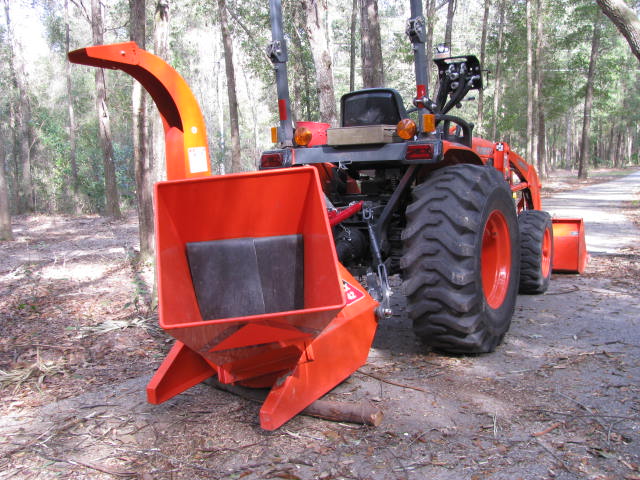

I ran a Wallenstein Chipper behind my Kubota B3300SU for two years. The first year chippers are fine. The second year when the blades begin to dull (Wallenstein has four chipping blades, cheap chippers have one or two), sap has collected throughout, and close knife/drum tolerances have opened a tad, chippers become maintenance intensive. My recommendation: Burn, do not chip.

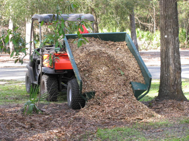

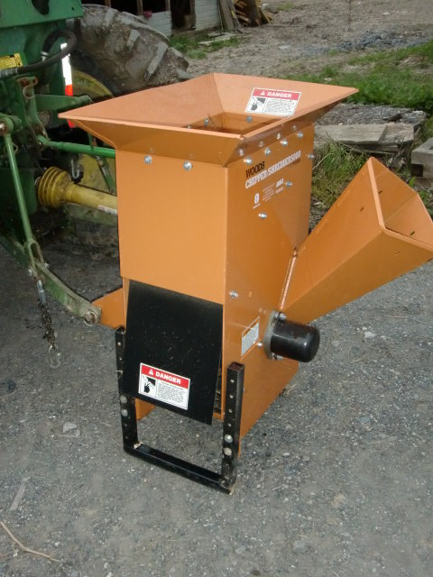

I've owned a Woods 5000 (rebadged Bearcat unit, can't recall the model number though) for several years...6-7, at least.
The 5000 is an outstanding machine for property clean up just as Mason156 describes.
I found I use the shredder more than the chipper (60:40 ratio is my estimate). The chipper capacity is 5", shredder will take up to 3/4" or so.
The only "downside" is mine doesn't have a blower chute. The chips drop below the unit. A blower (which is an option and some TBNers have them) would be nice, but not worth the extra $1000.
Mine, bought used, is PTO driven. It's rated for 15-40 PTO HP. I've ran it between three tractors with PTO HP ranging from 24 to 46. You can get a 5000 with an engine...
The picture isn't of my chipper/shredder. Just got this off the internet.
And do look for used chipper/shredders. I got mine of Craigslist) for a grand. Use Search Tempest too increase your search area.
