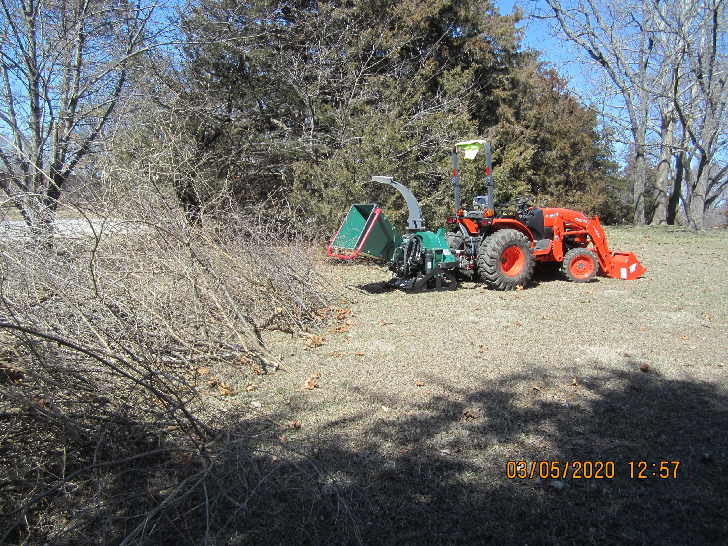

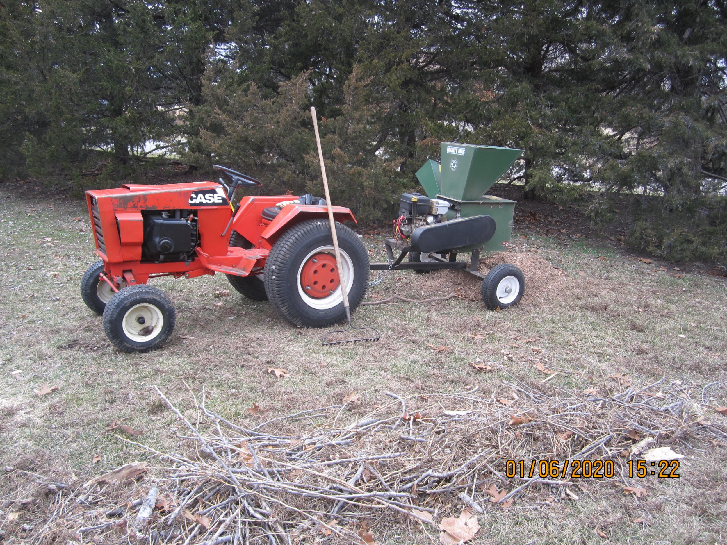

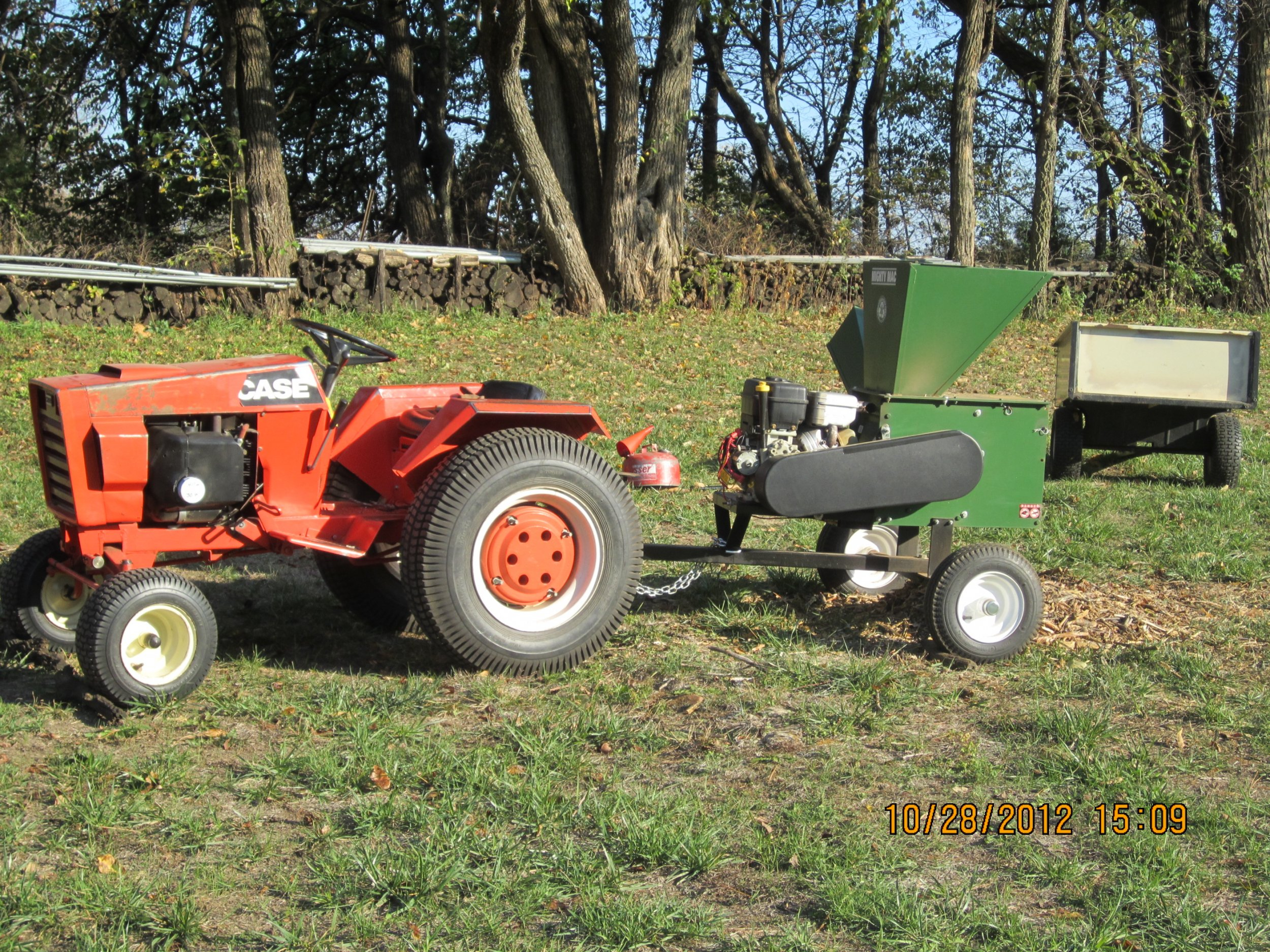

I've found that both machines that I have are useful depending on the job at hand. On large major tree work the Woodland Mills WC 68 is my go to machine. But through out the year there are small storms with minor tree damage that my MaKissic SC1650 is all that I need. Brushy stuff, garden clean up, piled up leaves, smaller windstorm brances seem to be a year 'round chore. The shredder is especially useful for this and yet, a 2-3 inch branch can also be chipped. And Yes, sometimes I need a large burn pile.
Cheers,
Mike
