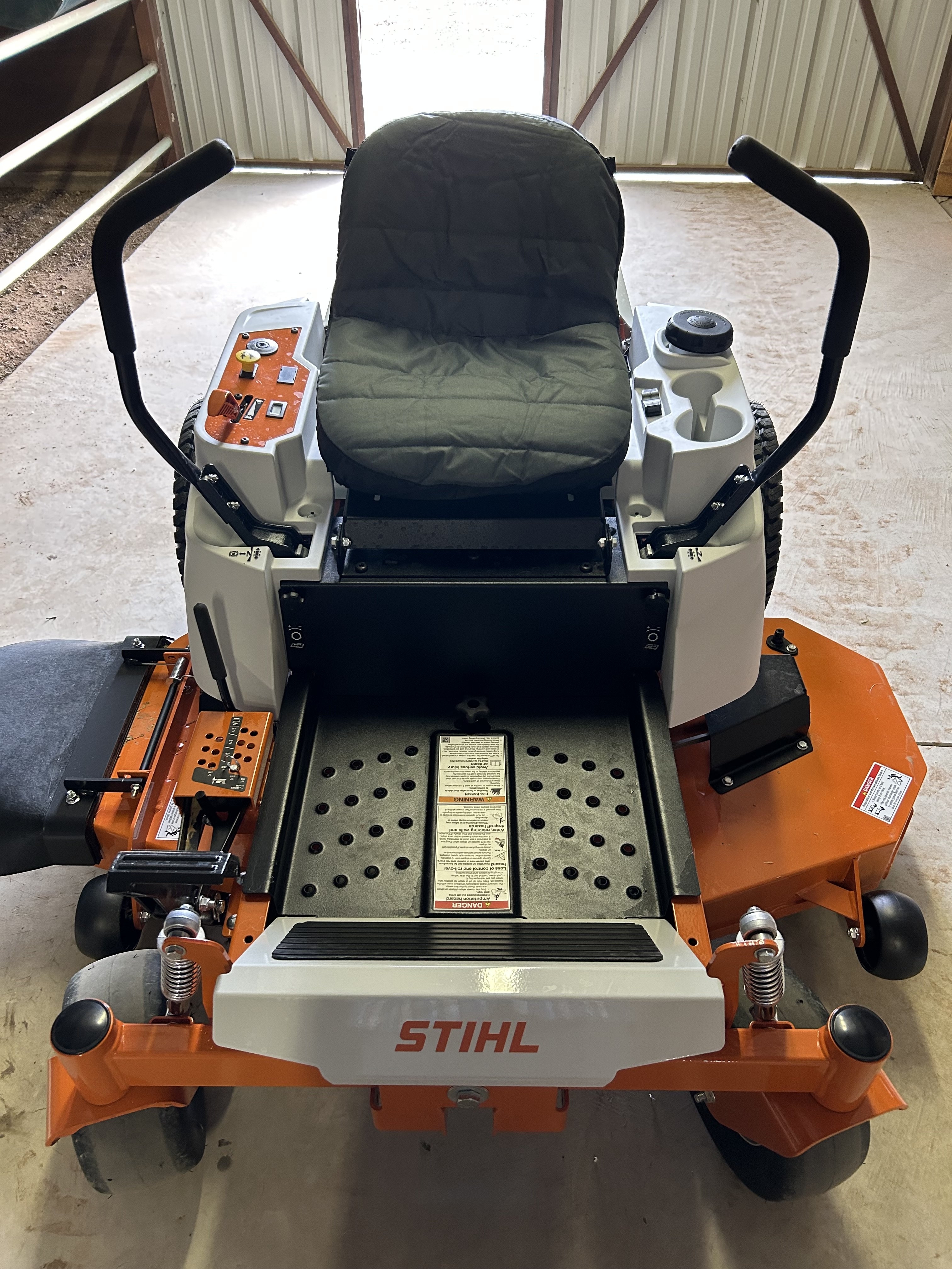

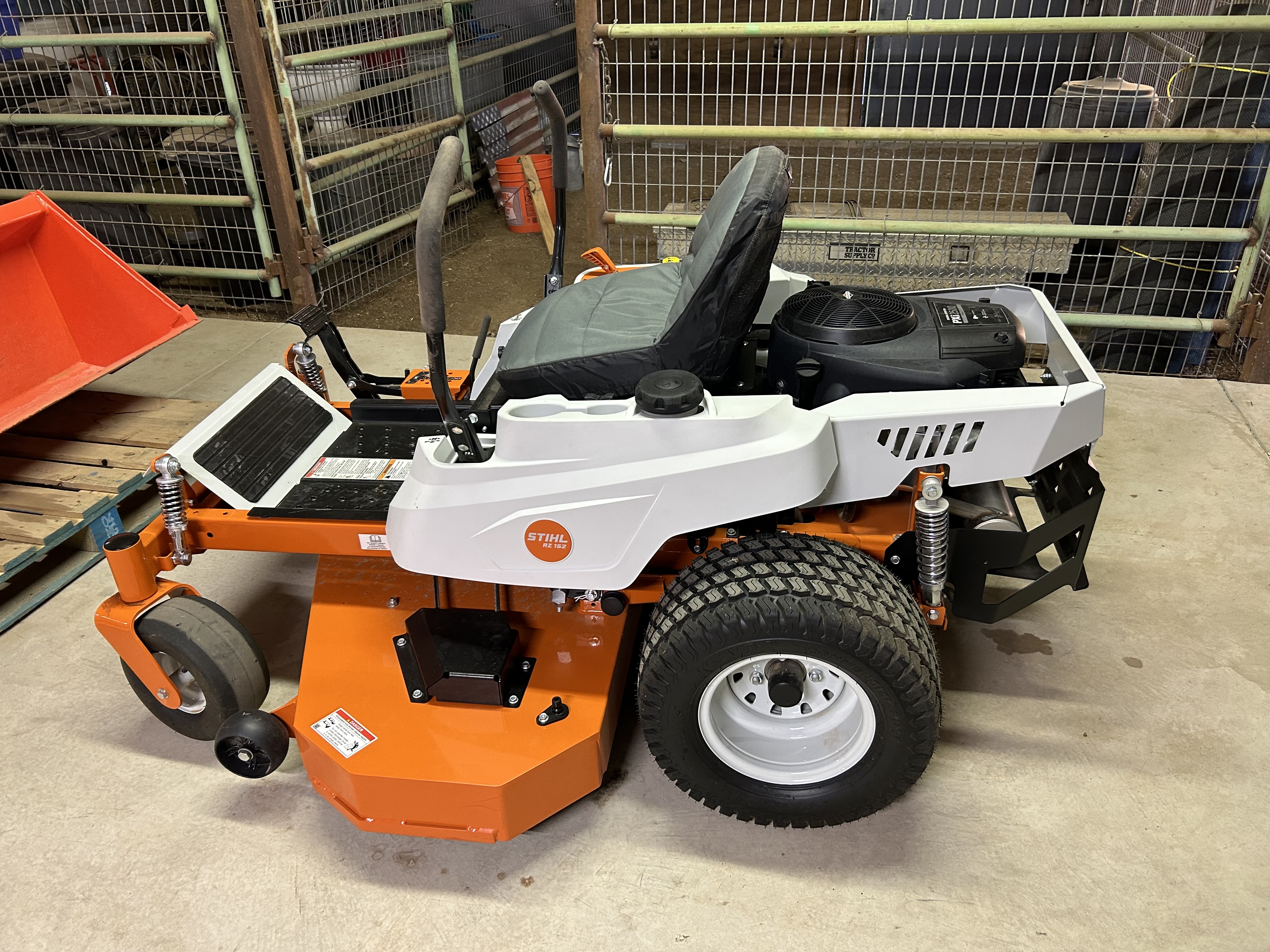

One bit of information. Stihl is selling the identical Ferris machine with suspension. It is simply a rebadged and repainted Ferris, but there are more Stihl dealerships than Ferris. The suspension is a game changer and I wouldn’t own a machine without it.

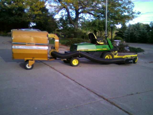

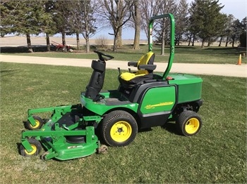

There are other "zero turn" mowers that do a very good job and serve other purposes. I Have a JD F-935 with an 78" front mounted rear discharge deck that handlesvery tall grass, leaves, sticks, etc. It can run my Winpower pto generator, broom, snow blower and pull a large dual axle trailer. I also have a JD 1435, runs a 72" deck, the broom, and my PTO generator. It can move at 12 mph (measured by my driveway radar sign gadget). Both are diesels with Yanmar motors. They both start on the second revolution after sitting for 5 months or more. The broom also serves my snow clearing needs on an 800' driveway and windrows leaves very nicely. both are 26 hp and sip fuel much better than my friend's ExMark with a Kubota motor. Her Toro gas equivalent uses a LOT of gasoline. (about twice as much by volume).
Both of mine have a steering wheel. Don't laugh, I drive them with 1 hand and can make use of the built in drink holders.
Around here F935s go for about $2500 and the newer 1435's for about $5k
