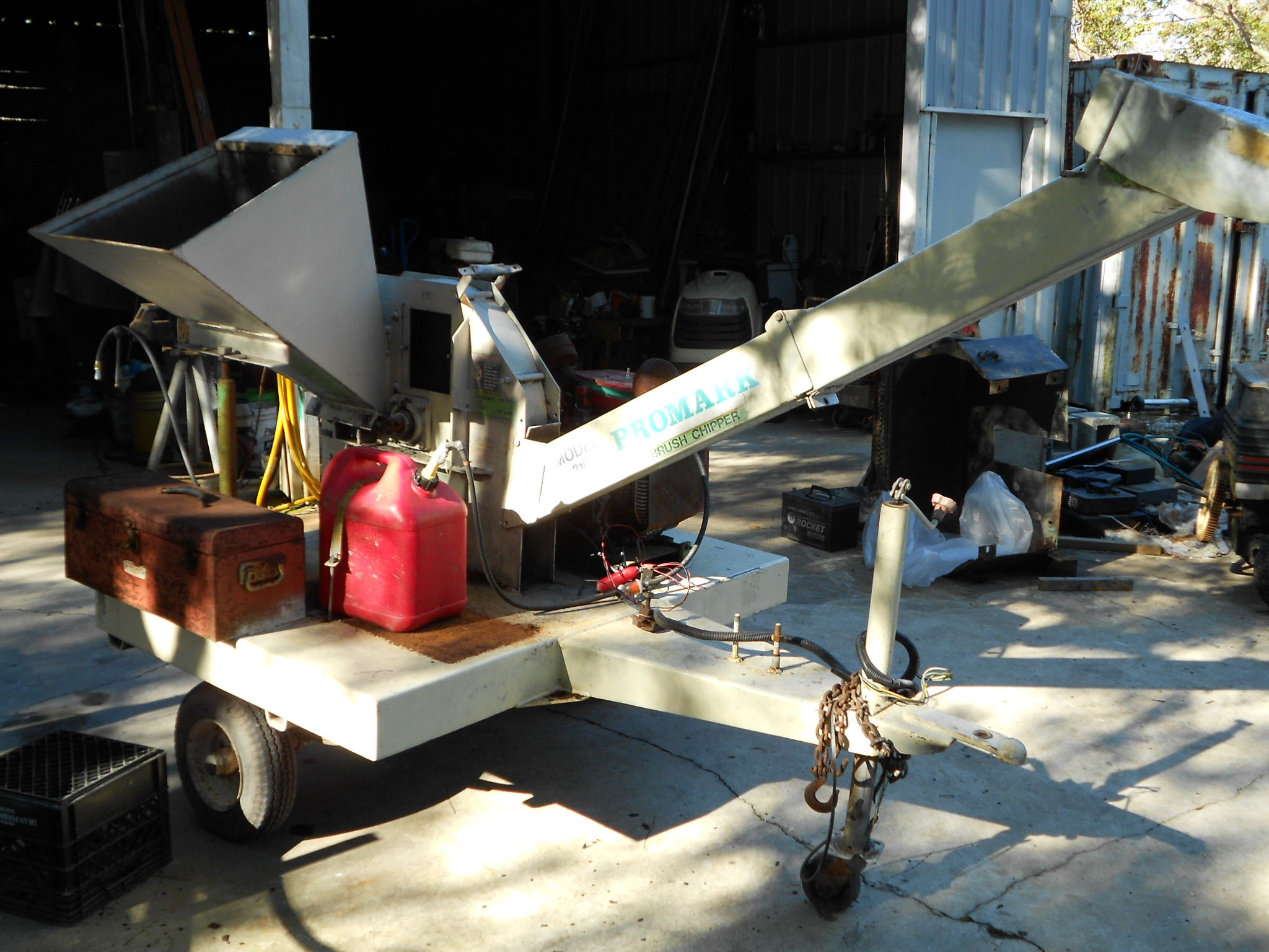

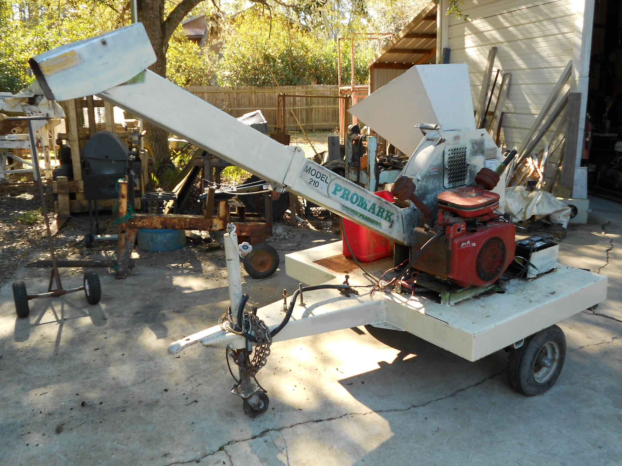

I had this one for a while. It had 8" capacity/chute with an 18 hp engine.
It had a 200 lb flywheel and used knives on it that went past an anvil with a .025 in. gap.
When running it would throw chips for over 25'.
It did a great job but loading anything but straight branches took some stuffing.
