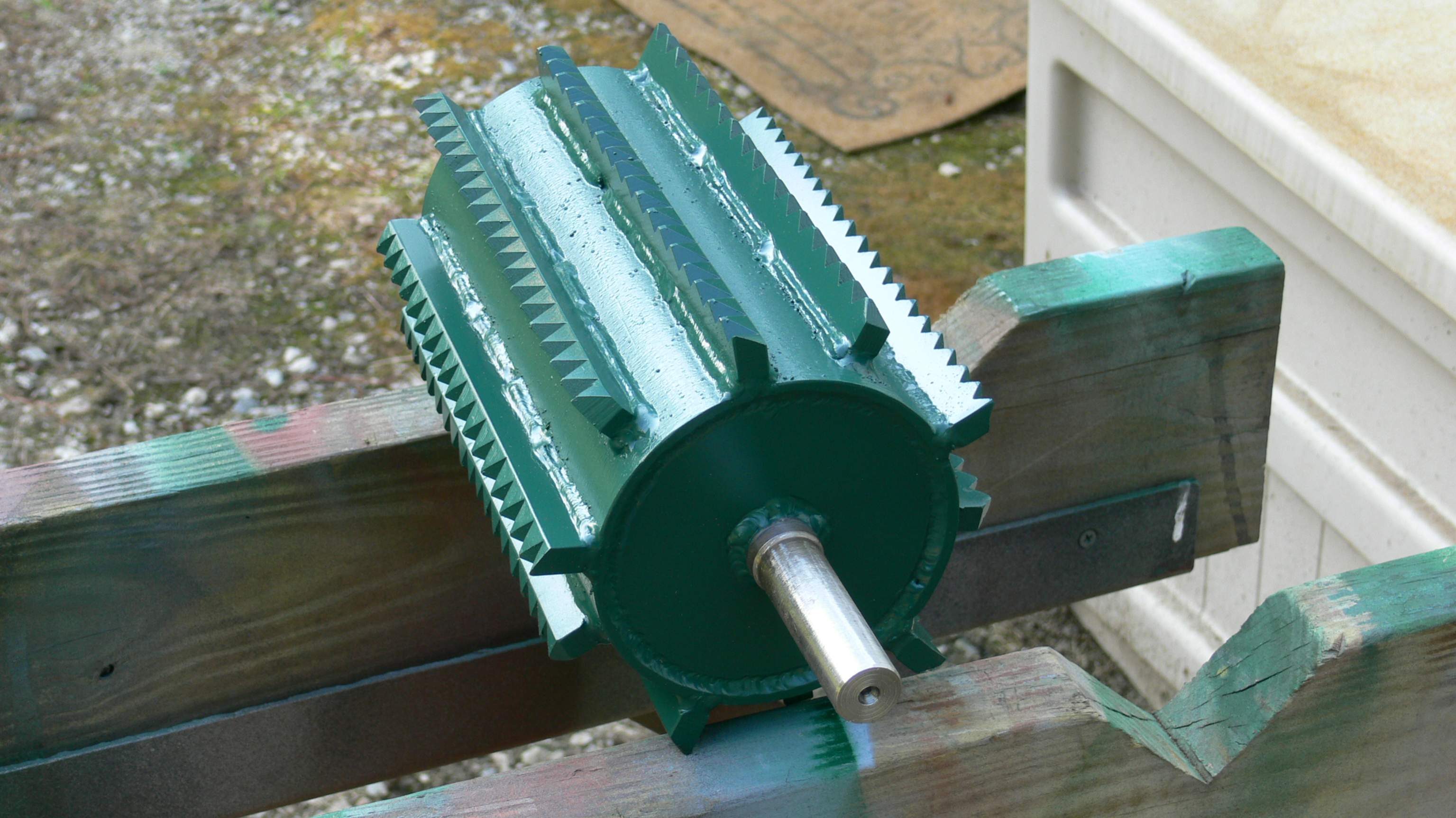

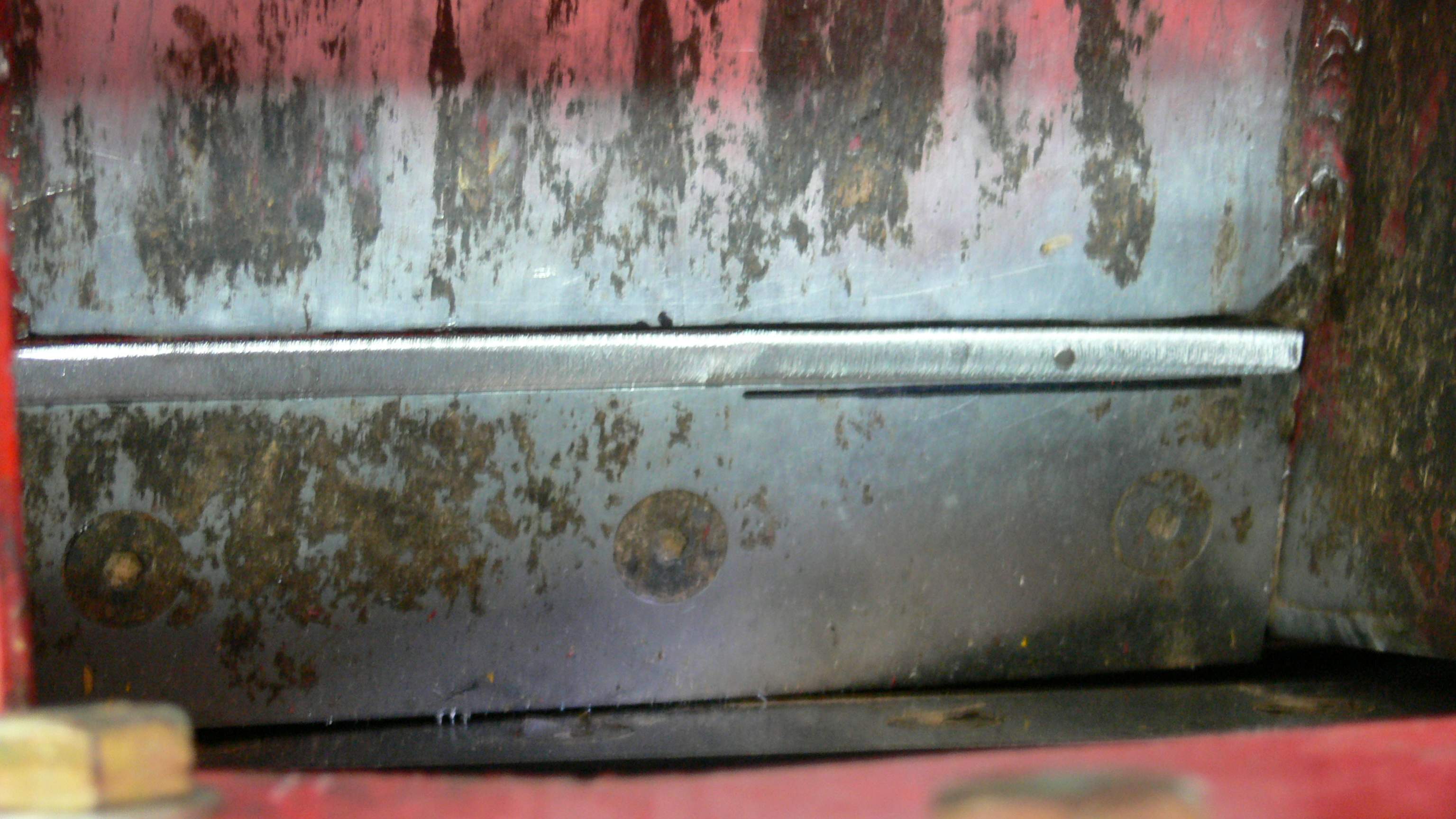

I have the same chipper also from Ranch Hand Supply. Great chipper for the money but I did make a few modification. First the feed drum would slip so I made a new one (picture 1). The bed knife - - - not sure what the proper name is but it is the stationary blade - - wouldn't stay close enough so a installed a spacer (picture 2). Finally I found that the blades got dull quickly - - I made some new ones out of D2 steel and had them hardened - - they stay sharp much longer now. I made a couple of other modifications but nothing big. I love the chipper now and use it all the time.

Holy Cow, that's a pretty impressive feed roller.:thumbsup:
I talked to a local fab shop here and it was going to be very expensive to make up new blades with better steel so I have 2 sets and the dull ones go out for sharpening when I change them out.

Nice job on the roller. Where did you find them teeth?? i wouldn't mind doing the same thing.

I second that... that new and improved feed drum looks awesome.:thumbsup:

grsthegreat - - I made the teeth from a bar of high strength steel. It helps to have a milling machine and lathe in the garage:).
The teeth weren't too expensive but - - - the D2 steel for new blades:(
