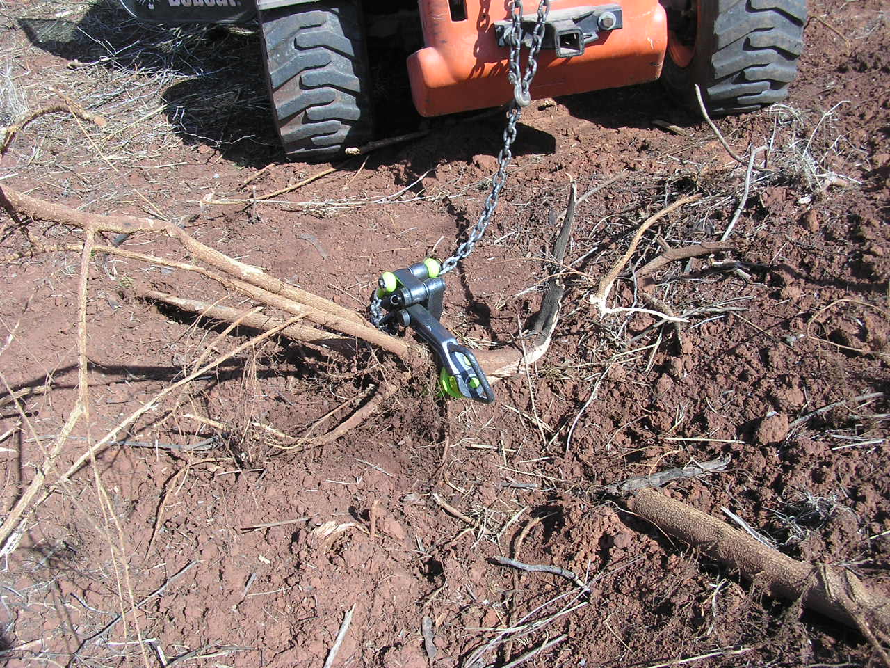

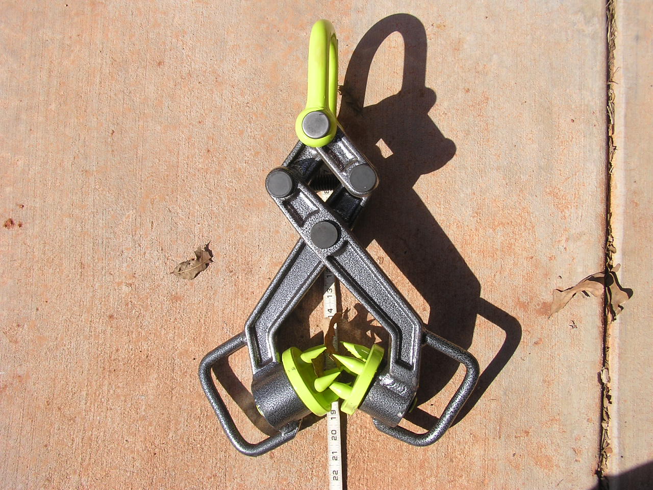

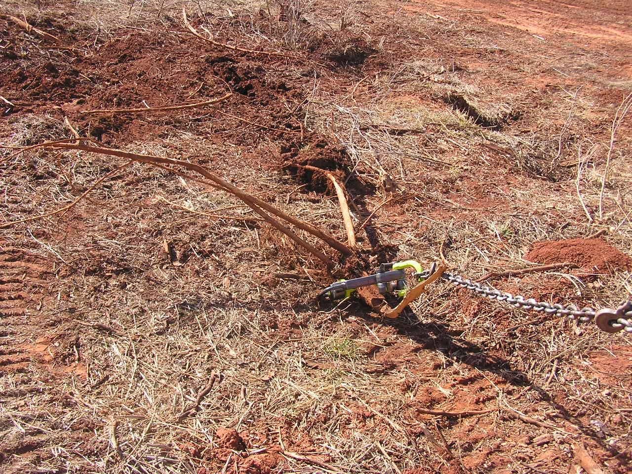

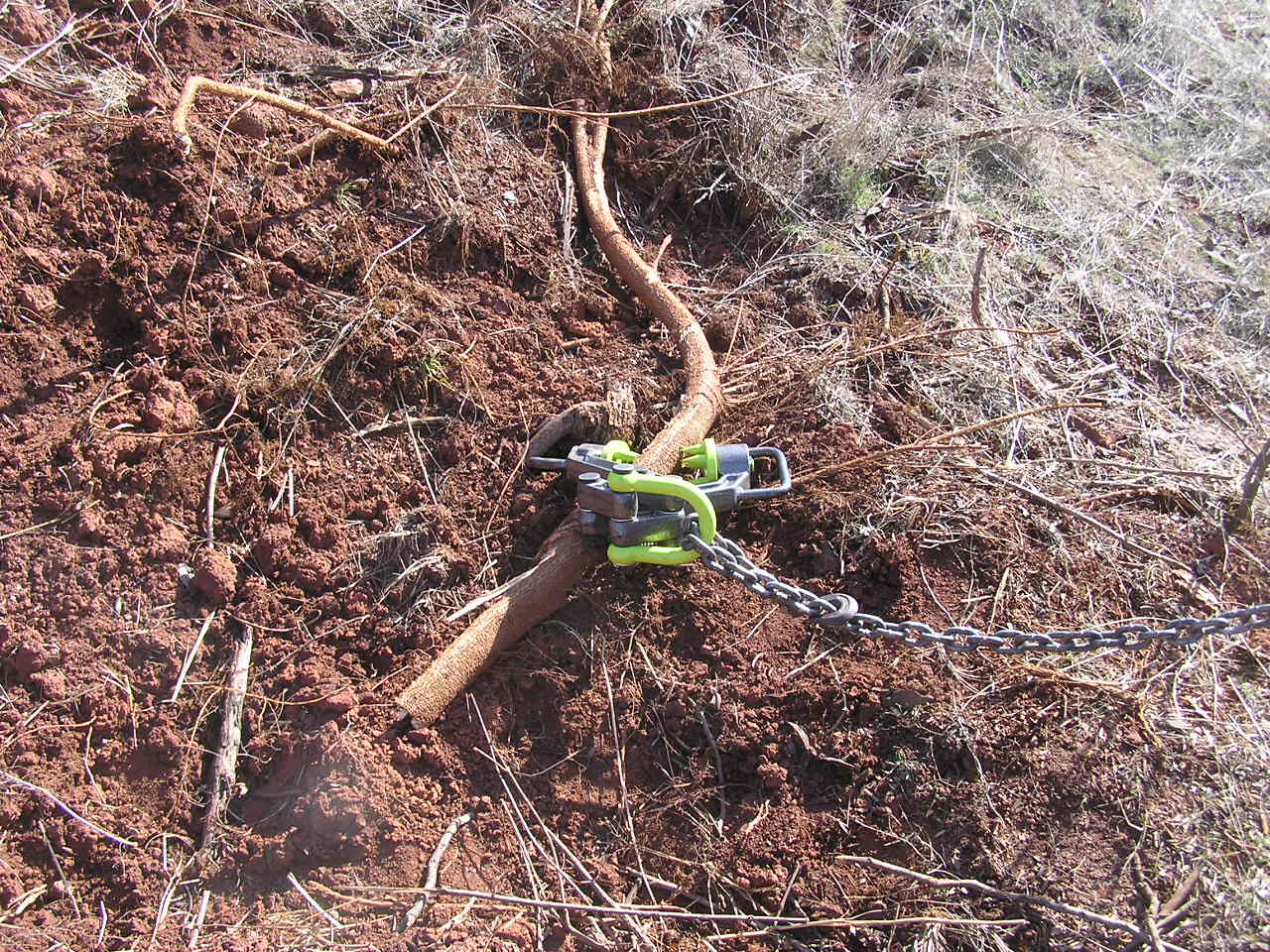

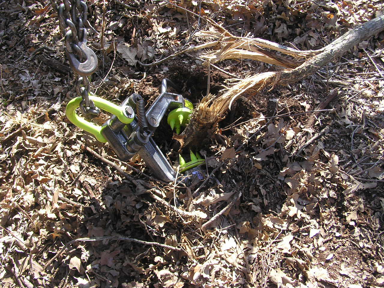

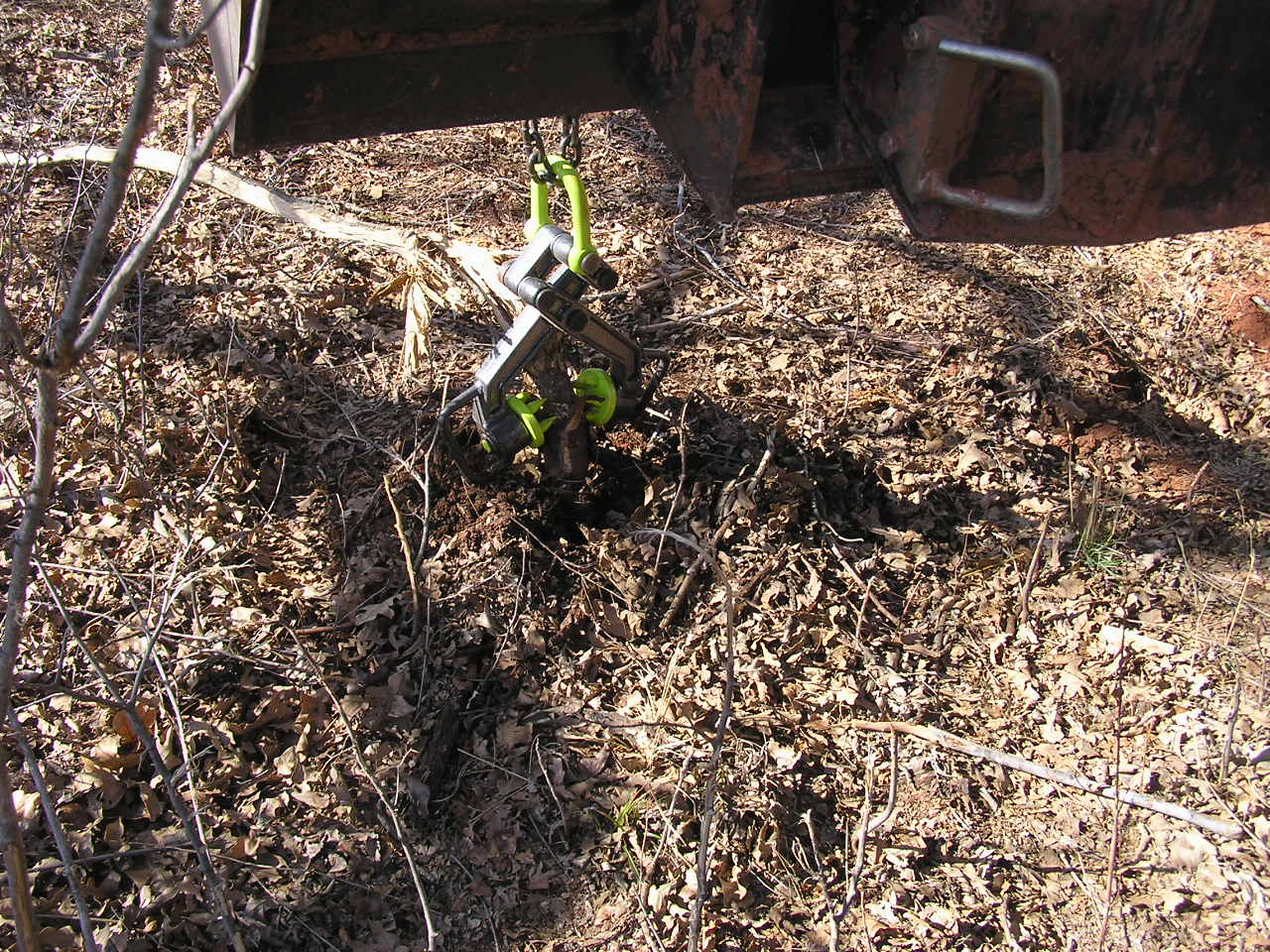

For pulling small trees, it's hard to beat a brush grubber. That's not a job for a choker.
   / Choker Cable Size Recomendation #17
A brush grubber is also great for stumps.

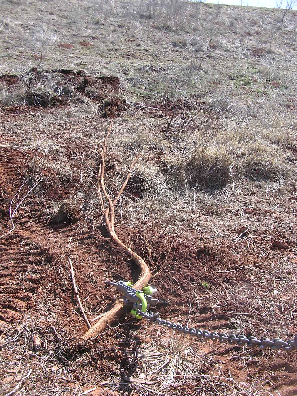

And roots.

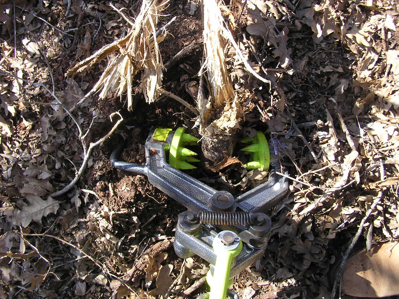

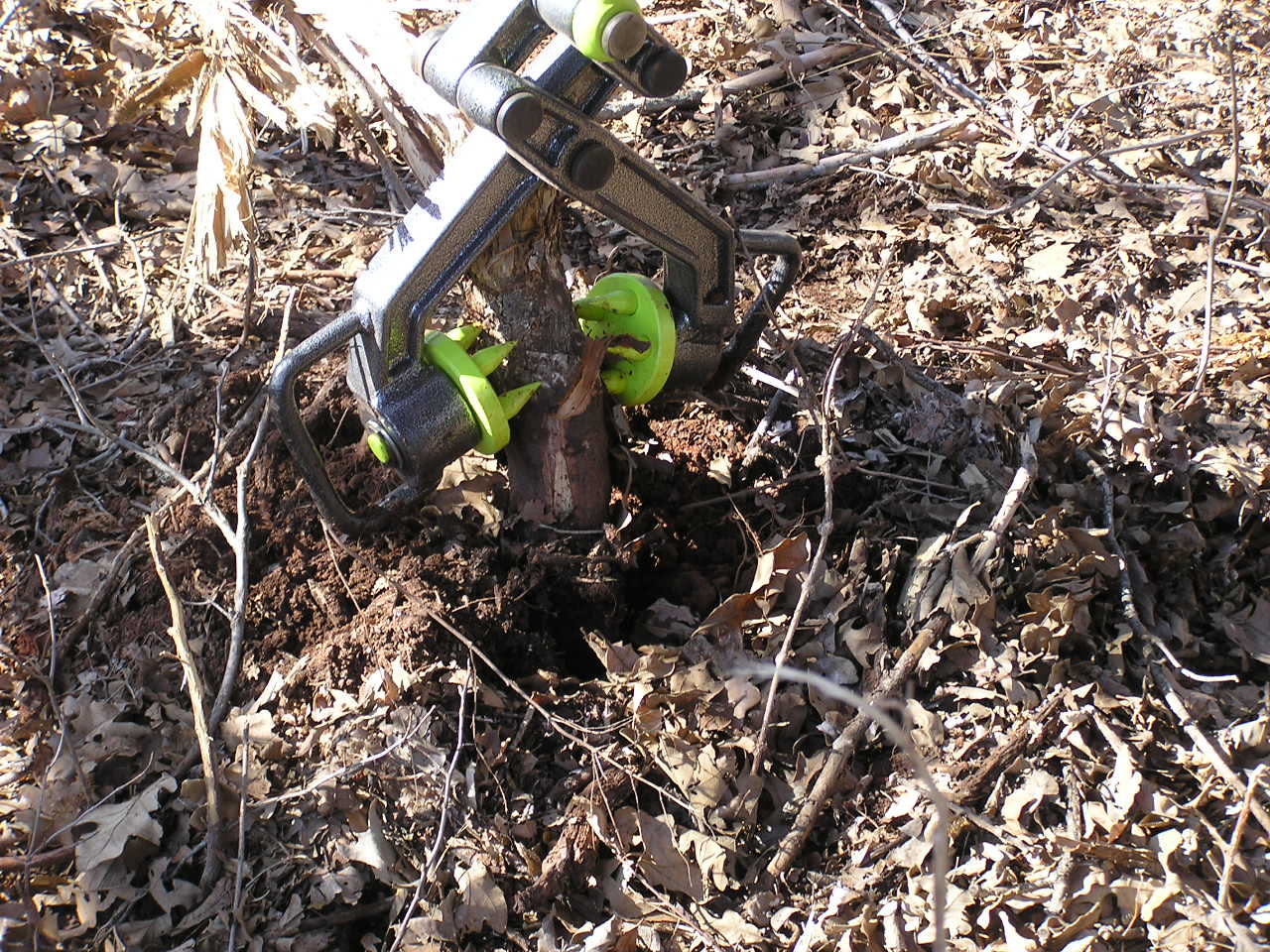

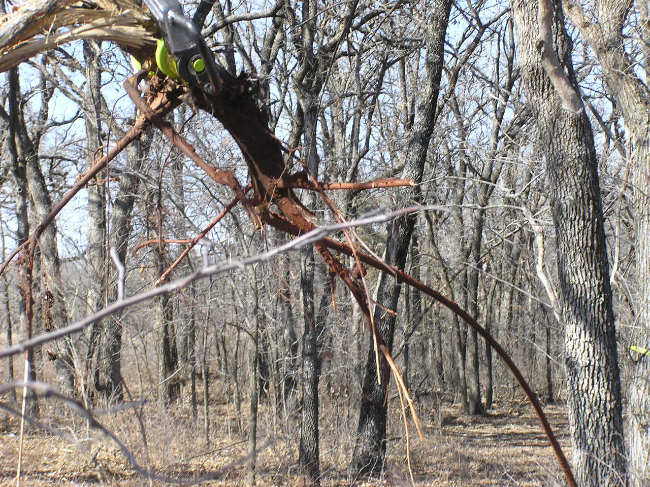

And a tree that the brushhog went over. It would be hard to get a chain on.
