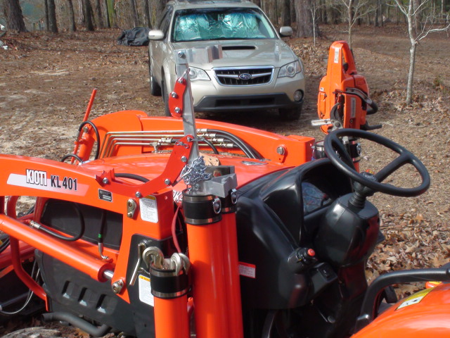

Another vote for a Brush Grubber. I have the BG-11 and prefer it over chain alone, as chain tends to slip to find the angle it wants to ride at, while the BG grabs where one places it. Although it does slip sometimes, usually due to loose bark or the teeth being clogged from a previous pull and not removed.
I carry 2 each, 10' lengths of 5/16" G70 chain with grab hooks for general purpose, every day lifting and tugging, and 1 each, 14' length of 3/8" G43 chain with slip hooks for the Brush Grubber. 5/16" is more than I require, but provides the margins I want and the 3/8" is just because I had it laying around and is a good length for the Brush Grubber.
Here is how I carry my chains, which makes them neat, safe and easy to access. Since, I replaced the 3/8" steel cable on my Jeep's winch with synthetic, I have the cable rigged in case I have to pull a downed tree that is hung up or something, but hope to never have to use it. I really do not like working with steel cable for the reasons already specified here by others.
