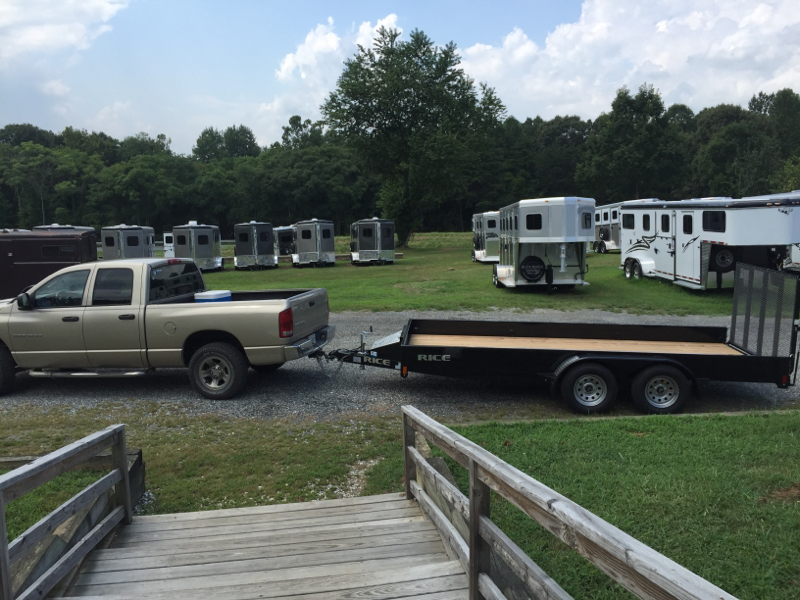

I bought the Rice Stealth 16 footer drove it home today. Put about 140 miles on it.
That's exactly what I have...Been very happy with it.
   / Choosing a trailer Rice, Mustang, Big Tex
#12
I'm happy with it so far. It tracks very well and rides smoothly even when empty. I'll be picking up a used UTV from the dealer soon and taking it to the property, 2 hours away, so I will get a bit more practice driving it.
And I'll break in that gate.

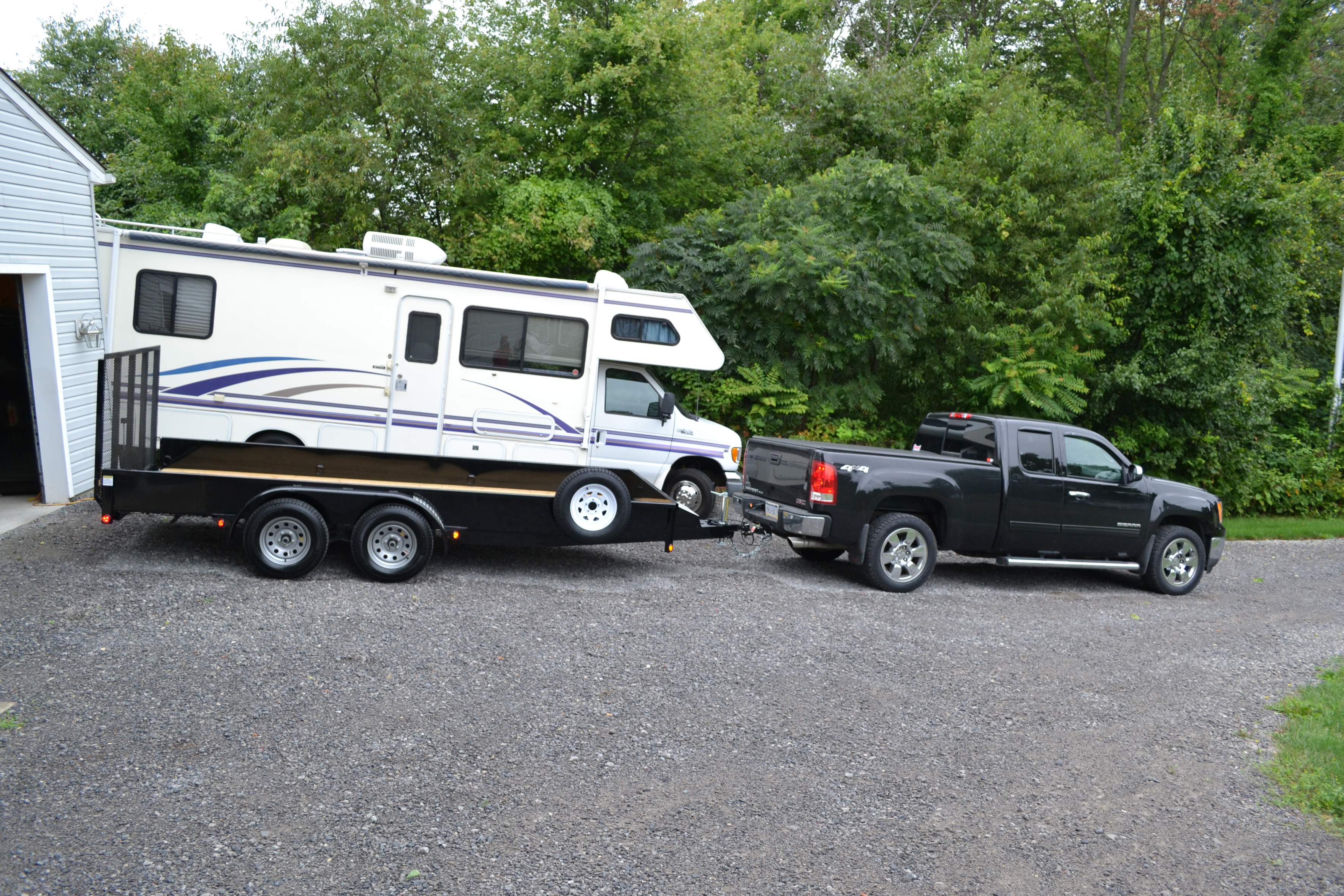

I just shopped for (& brought home today) an 18' tandem 5200# axle car-hauler/light-equipment trailer; thought I'd add an up-to-date post as these (older) threads did help me a lot.
in my area, i had dealers for the following; so i only really evaluated these:
  • big tex
  • mirage
  • pj
  • c&b
Design (best to worst)
  1. big tex
    1. Big tex seems to have the most engineered/complicated (in a good way) design from the ramps to the drop jack
    2. but i don't need the lowest deck, and the big-tex car hauler model 10CH has a sunk deck with ~4" tall 3/8" steel bar "walls" around the deck. Sure they're strong, but it seems like i'd destroy them over time setting things down; not worth the lower deck for me.
    3. C&B was a beefier build, no extra features but seemed very well thought out
  2. C&B - a little simpler than the big tex, but obviously more robust. C&B beat PJ here because the fenders are _plenty_ strong enough for a GAM (grown ass man - new acronym for TBN. Its a thing) to stand on. Can't believe the others don't do this. You walk all around it to tie-down for god's sake... let me walk on the fenders!
  3. P&J - pretty similar to C&B, the fenders in particular stood out.
  4. mirage - not bad at all. Had nice step-ups on the side. Just a simple design *but* less beefy than the C&B / PJ
Apparent strength / robustness
  1. C&B won hands down; not a _huge_ difference, but it was noticeable.
  2. PJ
  3. Big tex & mirage were about the same
    1. Note: I also considered (and might have purchased if it were in-stock) the BigTex 7k-axle "14ET" models; premium of ~$1800 more than the 10CH's priced below BUT dramatically more robust trailer. Maybe even worth the ~$1000 premium over the C&B
Build quality (mainly welds, paint) All had acceptable fir or PT pine decks.
  1. C&B - the only one i didn't find any real well defects (some globbing; but no severe under cutts, blow-throughs, etc. Paint was great too, they say (and it appears) they use a better automotive paint than the others
  2. PJ -
    1. So the Powder Coat - initially i was dead set on the PJ given it's guality build and powder coat - however, after reading several reviews about flaking, i realized that after _some_ number of years all the paint, including definitely the PowderCoat will require work ... on the paint this is just touch-up; but on the powder coat it flakes off, so to see/find (let alone prevent) where it's rusting, i'd need to sandblast it. Not worth it for a utility device, so i figured the trailer would after a few years go from looking the best to by far the worst.
  3. mirage & big text were the same - some weld issues (albeit NOT in the key structural areas), paint just OK
price (retail prices - i was able to negotiate ~small concessions on all ($100-$400) - but it's a bad year to get deals). all are pull-out ramps, flat deck between wheels (not deck-over) unless noted
  1. $4500 - big tex 10ch 18' (10k gvw, flat deck, pull out ramps, no spare, adjustable hitch
  2. $5000 - mirage 18', with spare, fixed hitch
  3. $5300 - C&B 18', no spare, fixed hitch
  4. $5500 - PJ 18', no spare, adjustable hitch (note, they also negotiated the most; albeit still not that much these days)
Sooooo ... I went C&B what won me was:
  • overall build quality
  • high-quality paint (much more spot-fixable in several years)
  • frame built locally in idaho
Hope that helps someone. Ask me a in a few years how it went! :)
