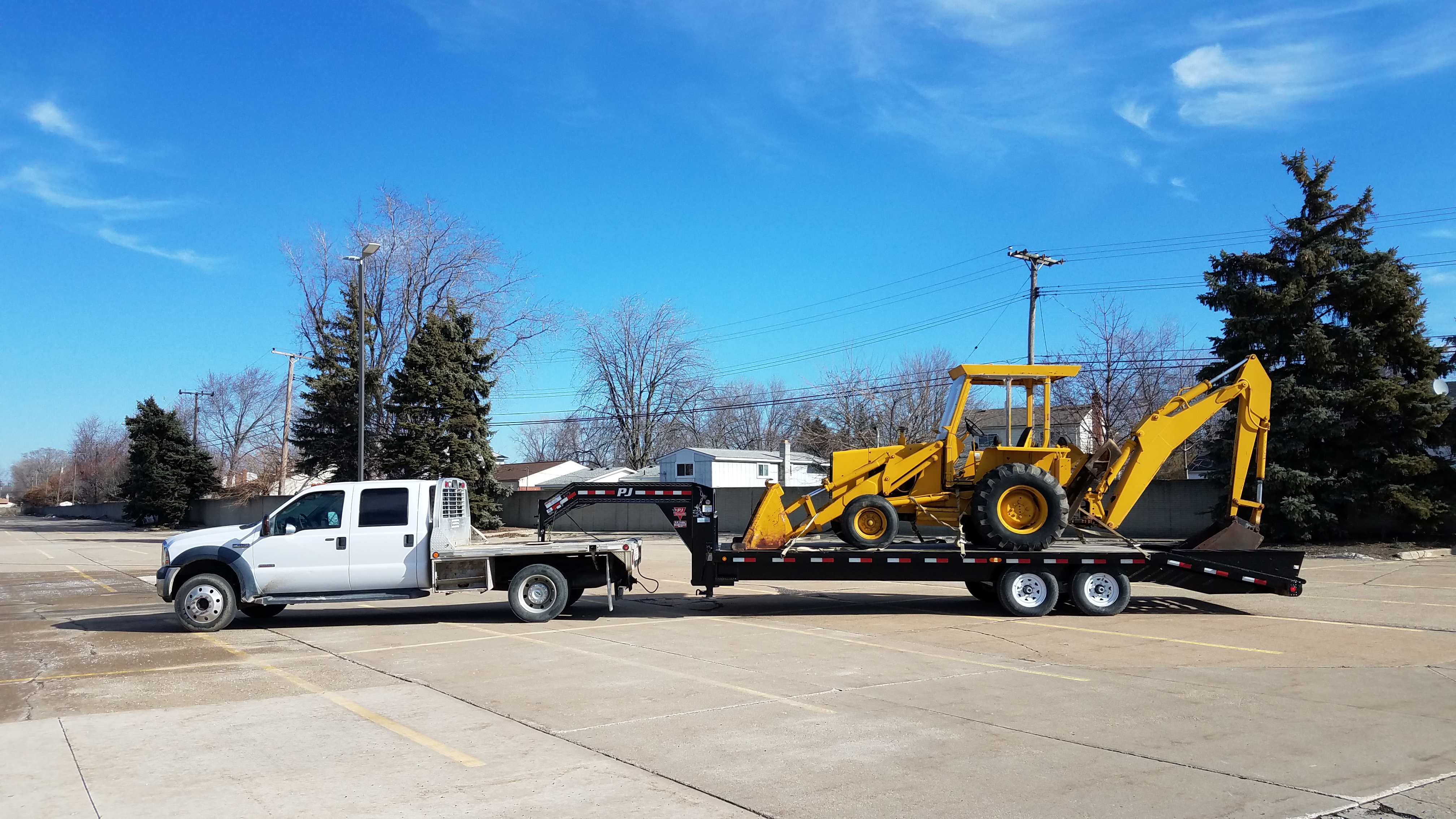

I have a 20' PJ equipment hauler, a 16' LoadTrail dump trailer, and i recently purchased a 25' PJ Gooseneck deckover. I compared this latest PJ to LoadTrail and BigTex, and ultimately went with PJ again. I think they offer a great value and quality construction. Next to the BigTex, the PJ was clearly the winner. I think I'm on my 3rd or 4th year now with the 20' PJ equipment hauler, and it's held up really well.

I finally took delivery of my 20' PJ this weekend. Two boards came damaged from the factory so the dealer threw in some stake-pocket d-rings, hub caps and shaved some off the price-tag. Defects are nothing to cry about. It's a nice trailer and not that much harder to maneuver than my old 16'.

You know how it goes on this site, if there are no pics, then it didn't happen. Enjoy the new trailer.
