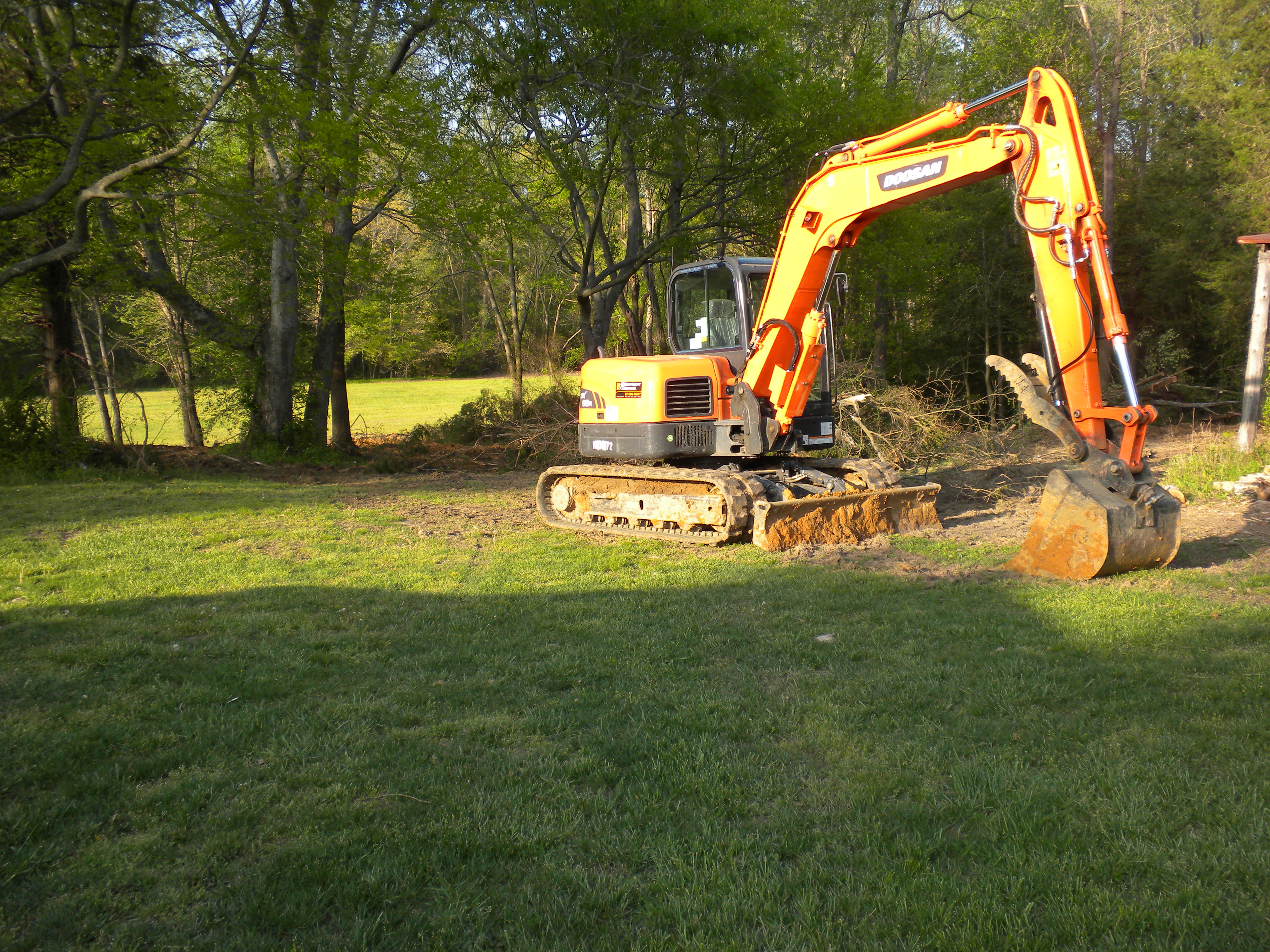

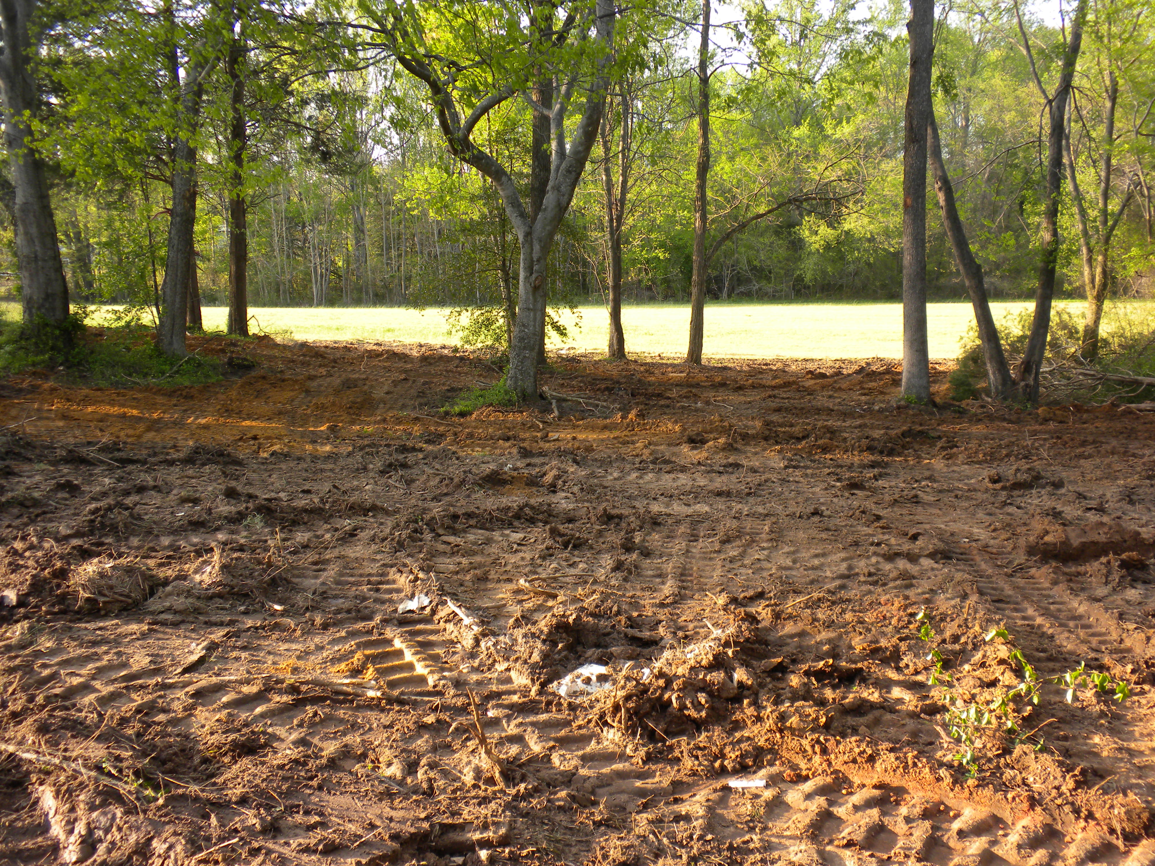

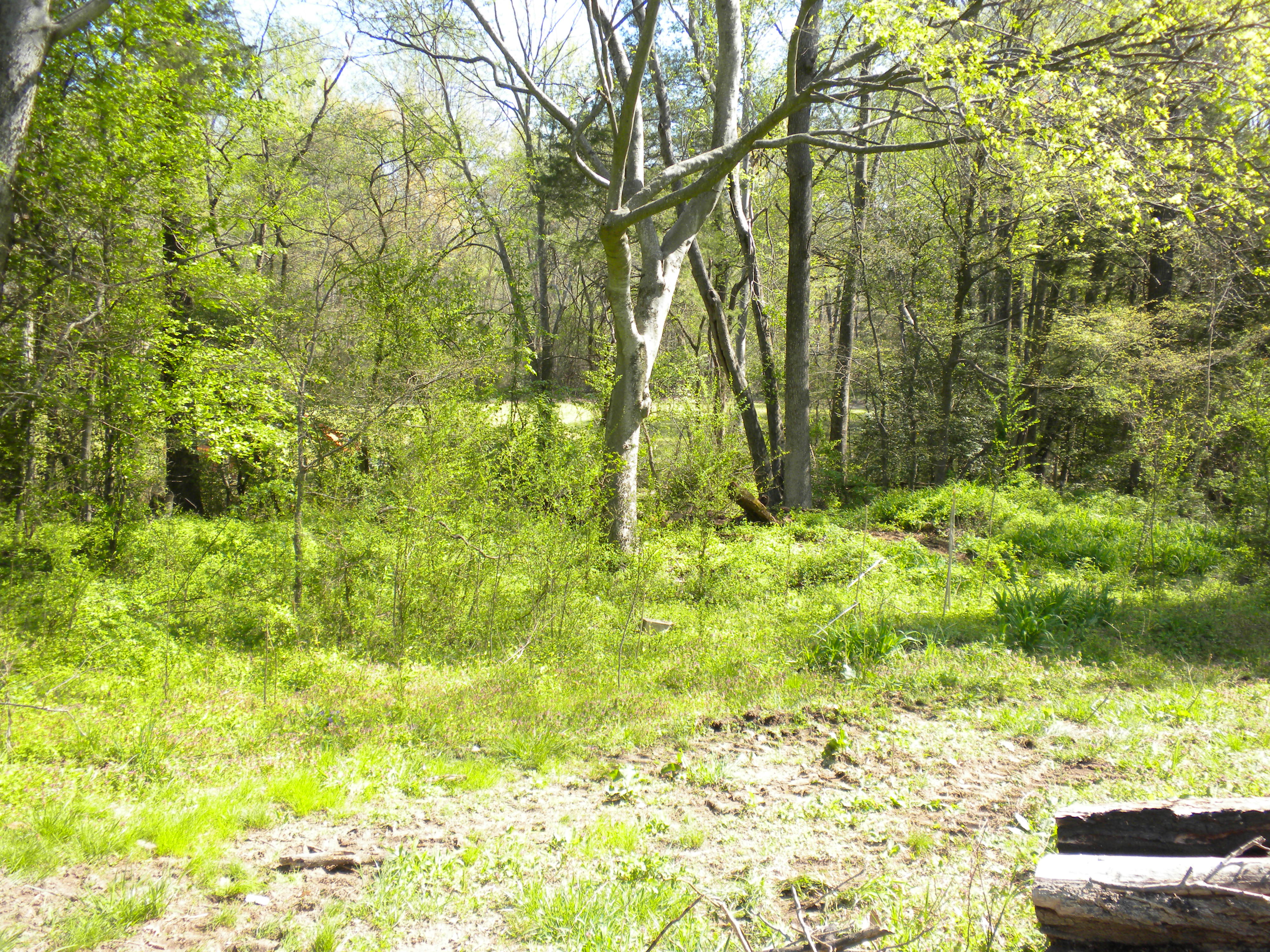

Tan,
I cleared a 1 1/2 acres behind my current property a couple of years ago and rented a mini-ex to do all the heavy digging and grading. I then went back with my tractor and graded everything out. Just another option to think about. I am not sure how overgrown your land is but I did a whole lot of work with that mini-ex that I could not have accomplished with my tractor. I attached a few before and afters pics to give you an idea. There was a big pile of junk back there (metal tin, bricks, rock,old rusted truck,etc.) that I needed to clean up along with a bunch of trees and brush.
