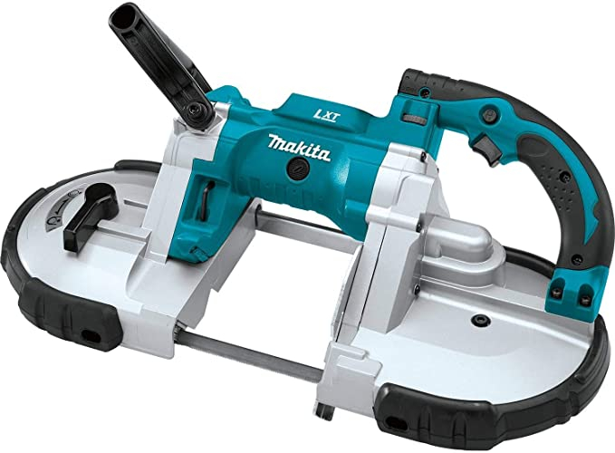

I used abrasive blade chop saws X years ago and glad they are gone. Today, its all cordless band saws and love them. We mostly use makita and they rock for $325. (do use regular band saws and ironworkers as well) If I had to buy one for home use, it would be a cordless band saw.
