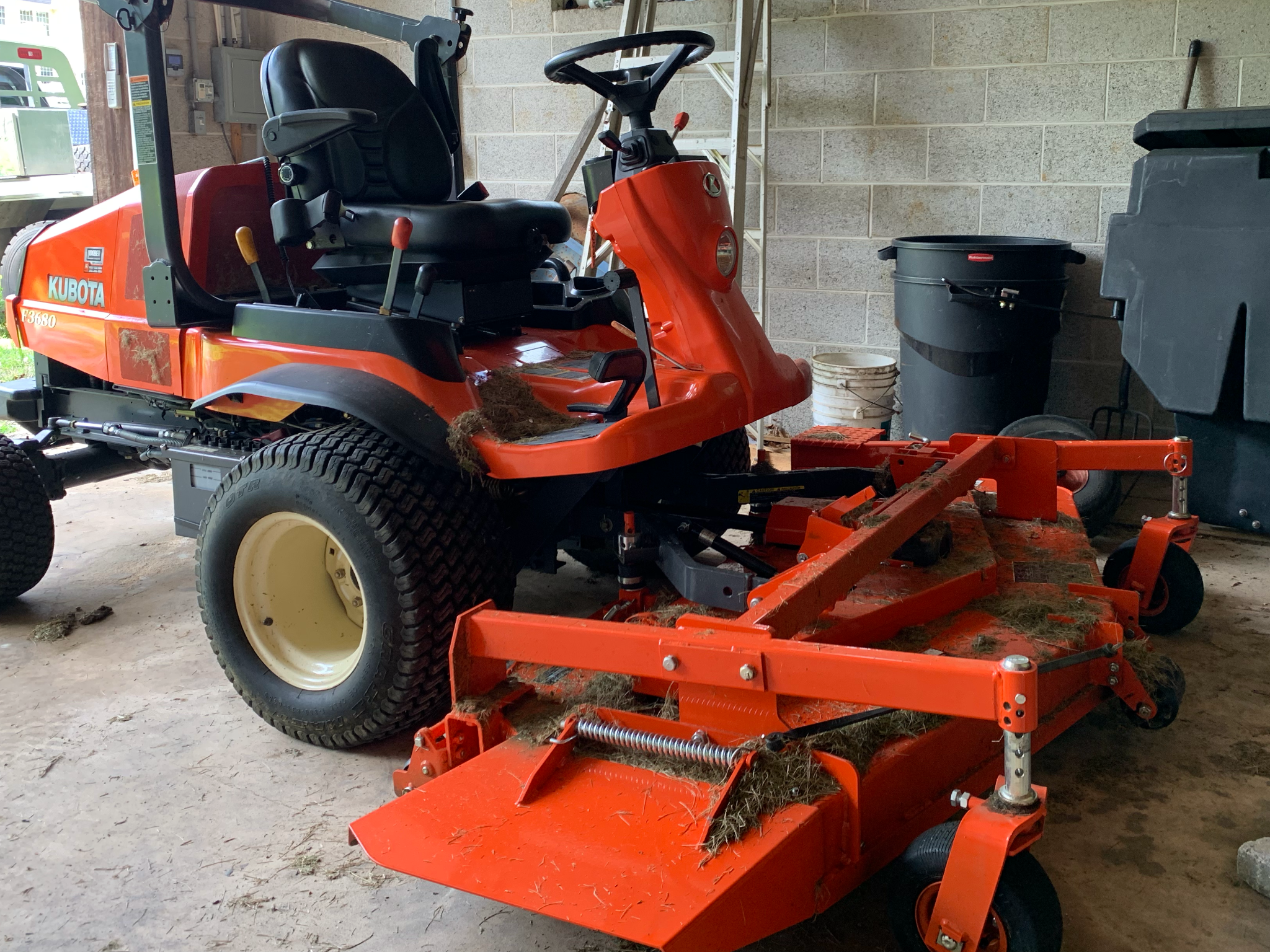

Here it is. It can really do some damage

Sorry, just trying to figure out why you need a chute in your F mower.
My two larger mowers have a rear discharge deck, and an old JD 300 with 42" side discharge had the chute cut off on purpose over 30 years ago by the previous owner, in order to fit into tight places.
Is it a safety issue due to commercial mowing?
Yes it’s more “unsightly” to be throwing a wide cloud of clippings to some of the residents at the community/farm we maintain. The chute-down gives a more controlled look of the clippings.
If it were my house, I’d pretty much let them fly and get rid of the chute.
It’s a $20,000 annual maintenance contract.

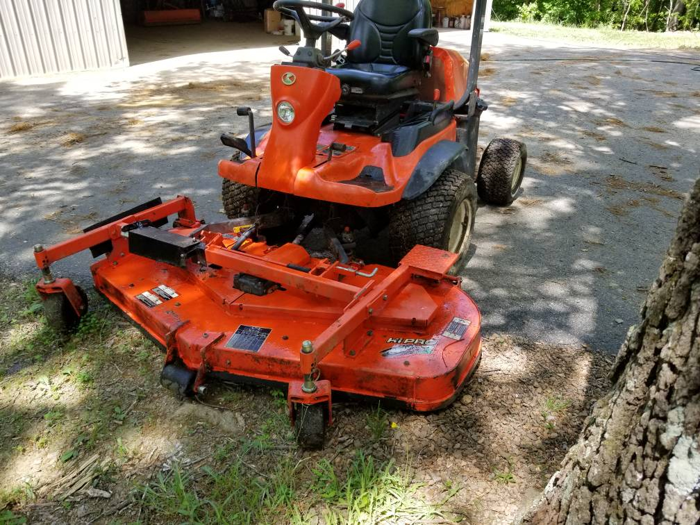

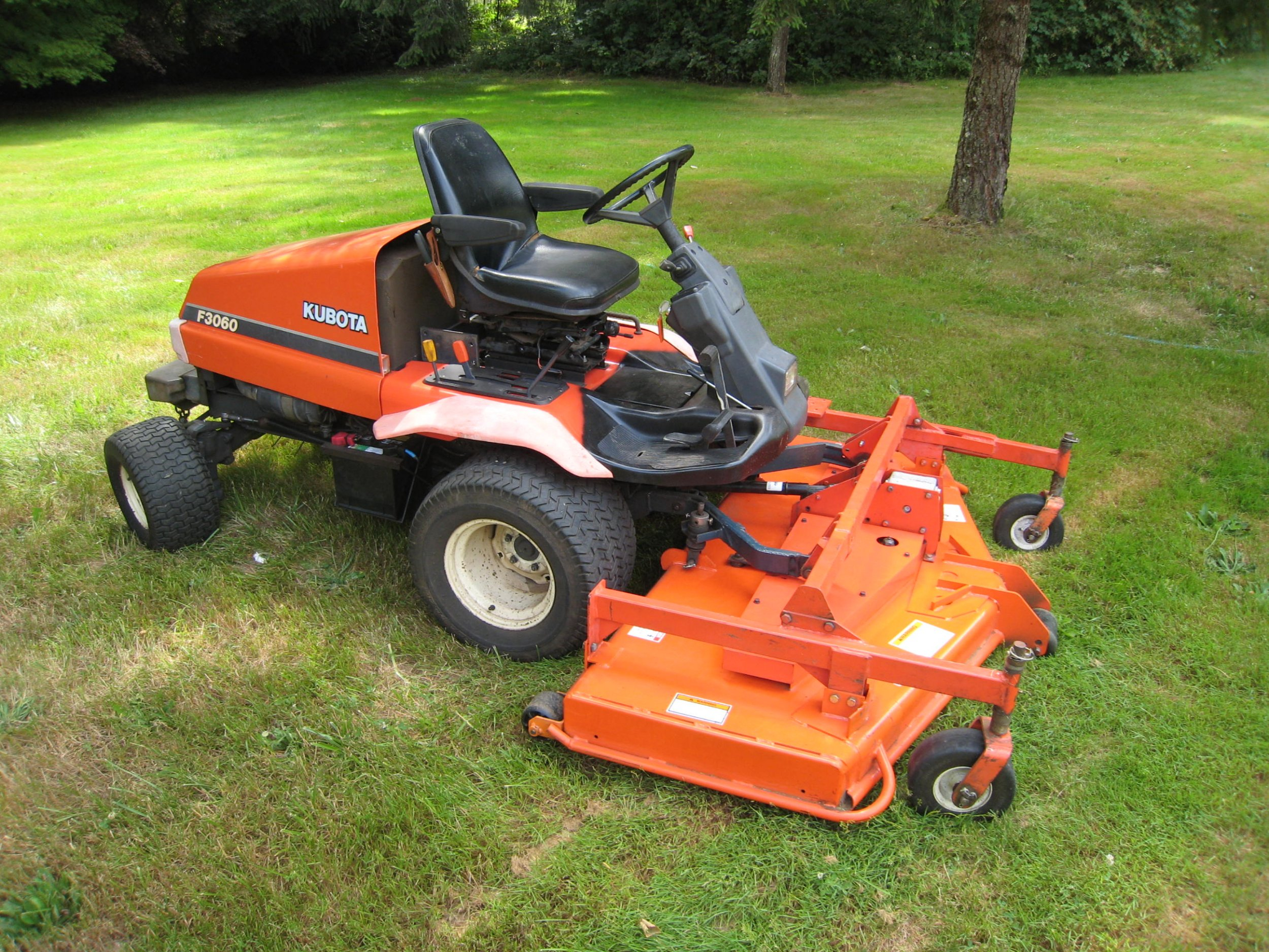

I know it's too late now, but would this type setup work next time?
PS. ROPS is not needed due to terrain of my property for F3060 so it's been stored away.

Not for me. After trying a rear discharge in dry grass, I found I prefer blowing the clippings rather as opposed to inhaling them, or wearing them on windy days.
I actually removed the steel chute and I found a plastic Exmark chute to use for now. Will try to find something else better soon.
