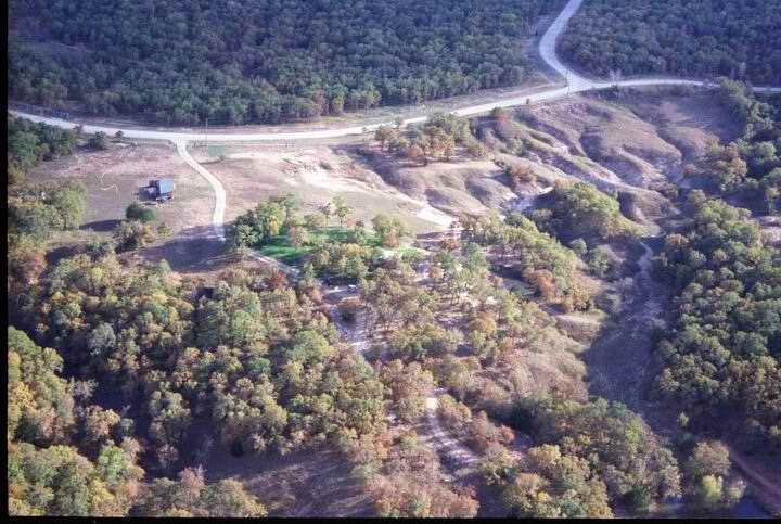

Maury, I know gullies (see attachment). I know of nothing that will make you safer around gullies than a hydrostatic transmission (or buying a flat piece of land /forums/images/graemlins/laugh.gif). On my tractor, the only time I use the brakes is if I want to change gear ranges while on a hillside or set the brake on one side to make a sharp turn. When you take your foot off the "go-pedal" of a hydrostatic transmission, the tractor stops, no braking required. You will not be sorry if you buy hydrostatic, any brand. I think you'll see what I mean if you test drive one.
