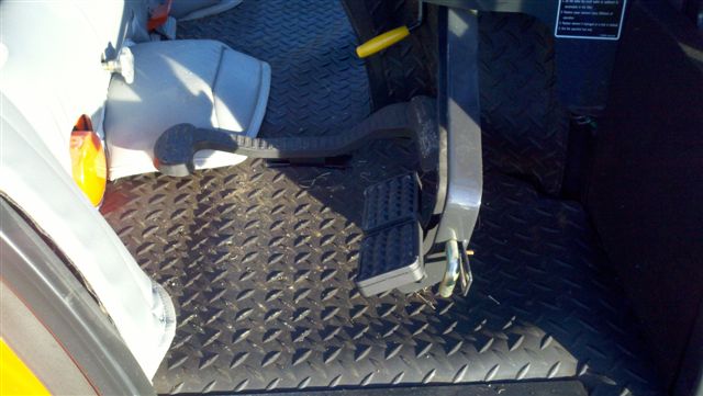

Sorry, I don't have instructions, my dealer installed the cab on my CK30. I'd stick with it and absolutely use all the sound proofing material they include. The end result is the cab is quieter than other 3rd party cabs, my JD 955 had a JDP cab and your ears bleed in it. Your CK20 comfort cab should be pretty good, but still to loud to enjoy the radio IMO. I paid $1000 for installation and my dealer struggled with it and had to come back to fix it. They complained about the instructions as well. I ended up talking to a couple dealers here on TBN and they sent me pictures of what it should look like and my dealer used those pictures to fix it. They had used some of the insulation incorrectly as well.

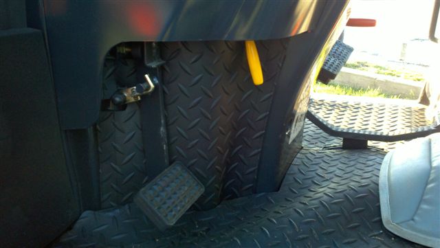

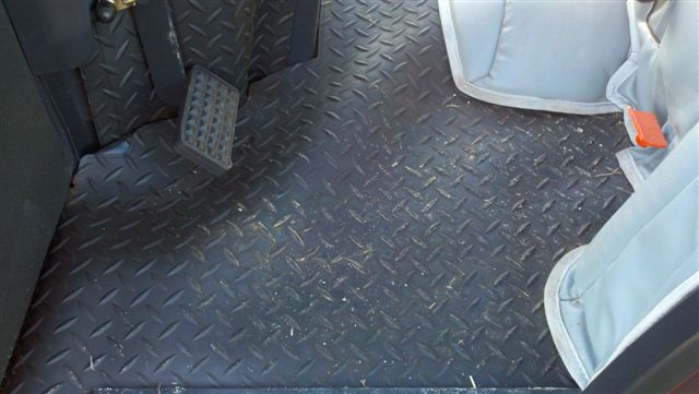

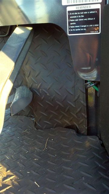

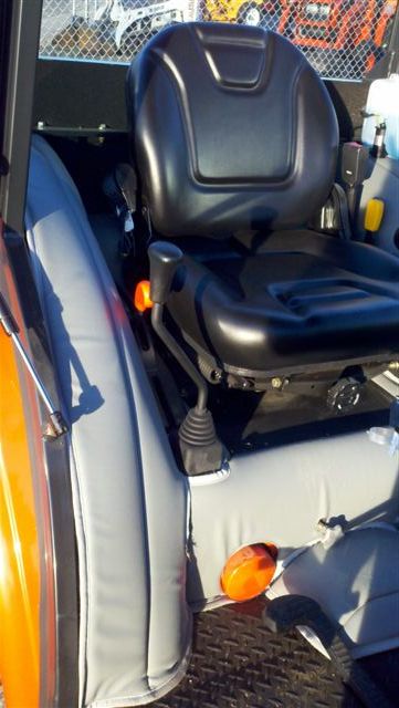

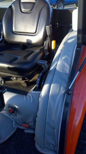

Here's my review of the cab, there are pictures from my cab and one other members cab. http://www.tractorbynet.com/forums/kioti-owning-operating/230081-new-comfort-cab-ck30-review-3.html
Here are the pictures the dealer/member on TBN sent me that my dealer used as reference.

Thank you so much for the reply. Those pictures do help. It's easier to look at pictures versus trying to read instructions that are vague at best. I called the dealer back and they said much of the wording in the instructions are lost in translation. I'm going to have another go at it this evening and I hope it goes better this time. The dealer also wanted 1300.00 to do the install and while that's a lot of money, it sure would save a lot of trouble. They told me they even have problems doing it and they do it all the time. Thanks again..... I also think that they give too much material and you never end up using all of it. I'm thinking there will be a small amount left when the job is done and the dealer said they usually have a small amount left over as well.

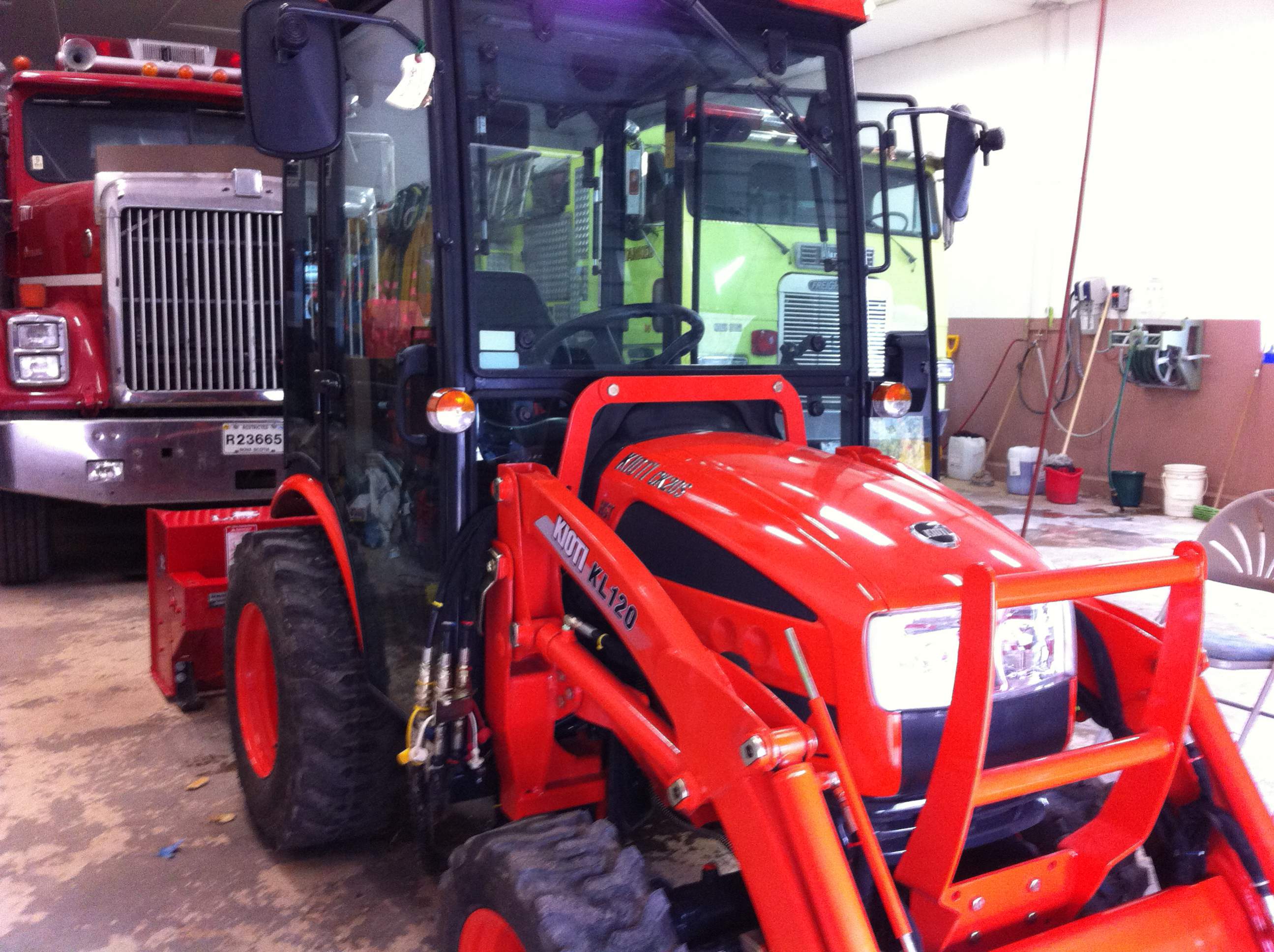

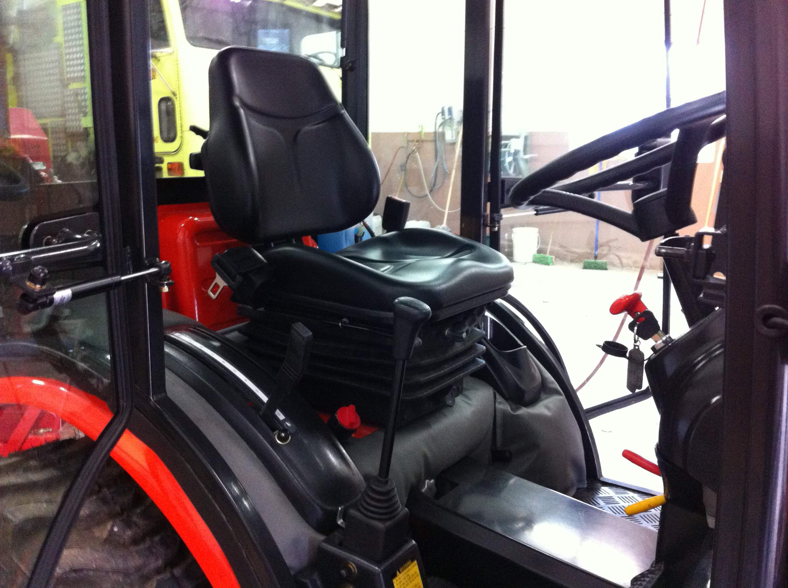

The heat is now working - there was air in the system. Yes, it's quite a job and there were several things missing from the cab kit but I hope the dealer is going to replace them for me. The only thing that's not working now is the rear wiper. I don't seem to be getting any power from the switch to the rear. I even managed to get the signal lights fixed today as well. Here are a few pics of the finished cab. Thanks everyone for the replies.inside cab.jpgoutside cab.jpg
