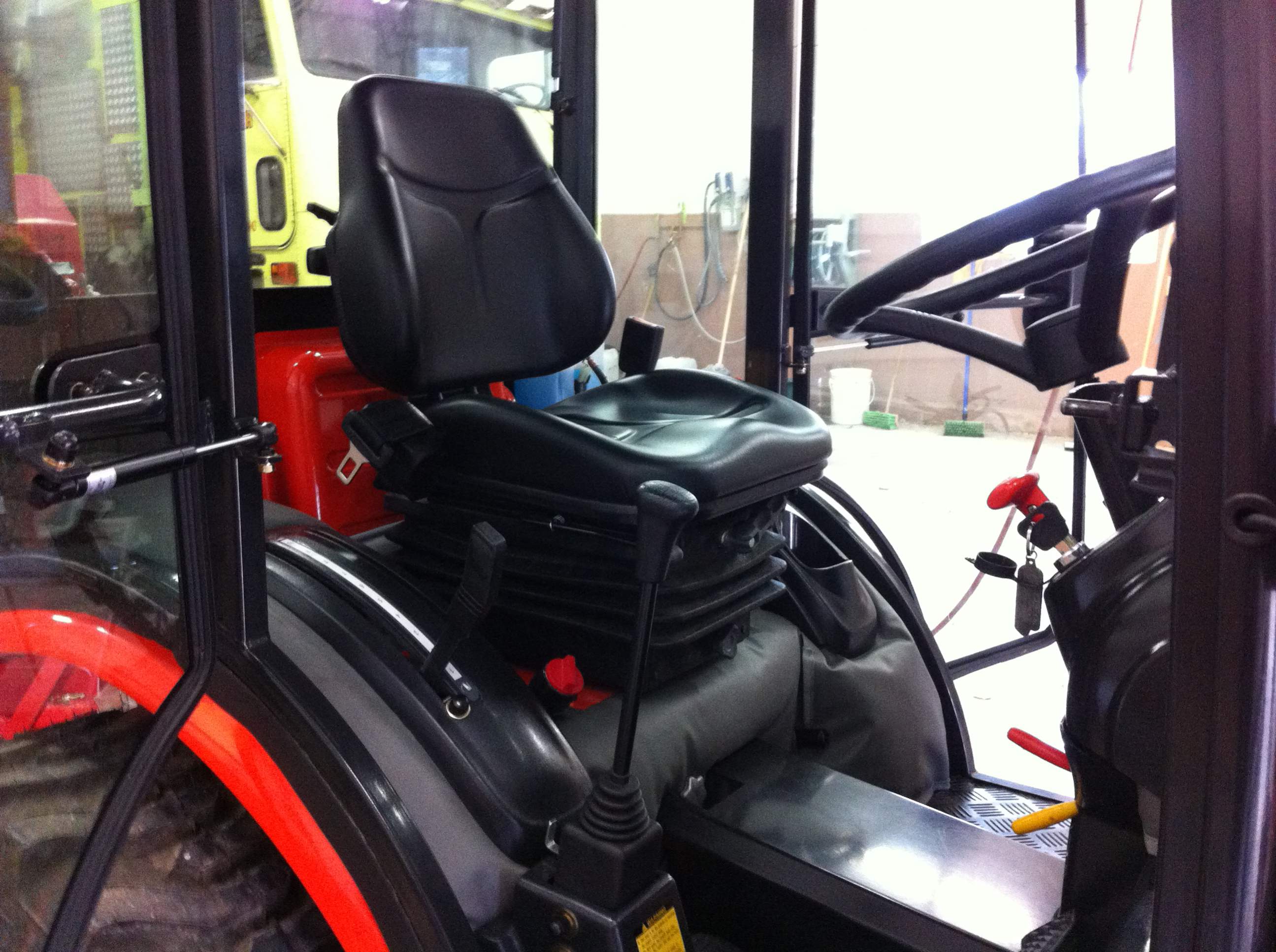

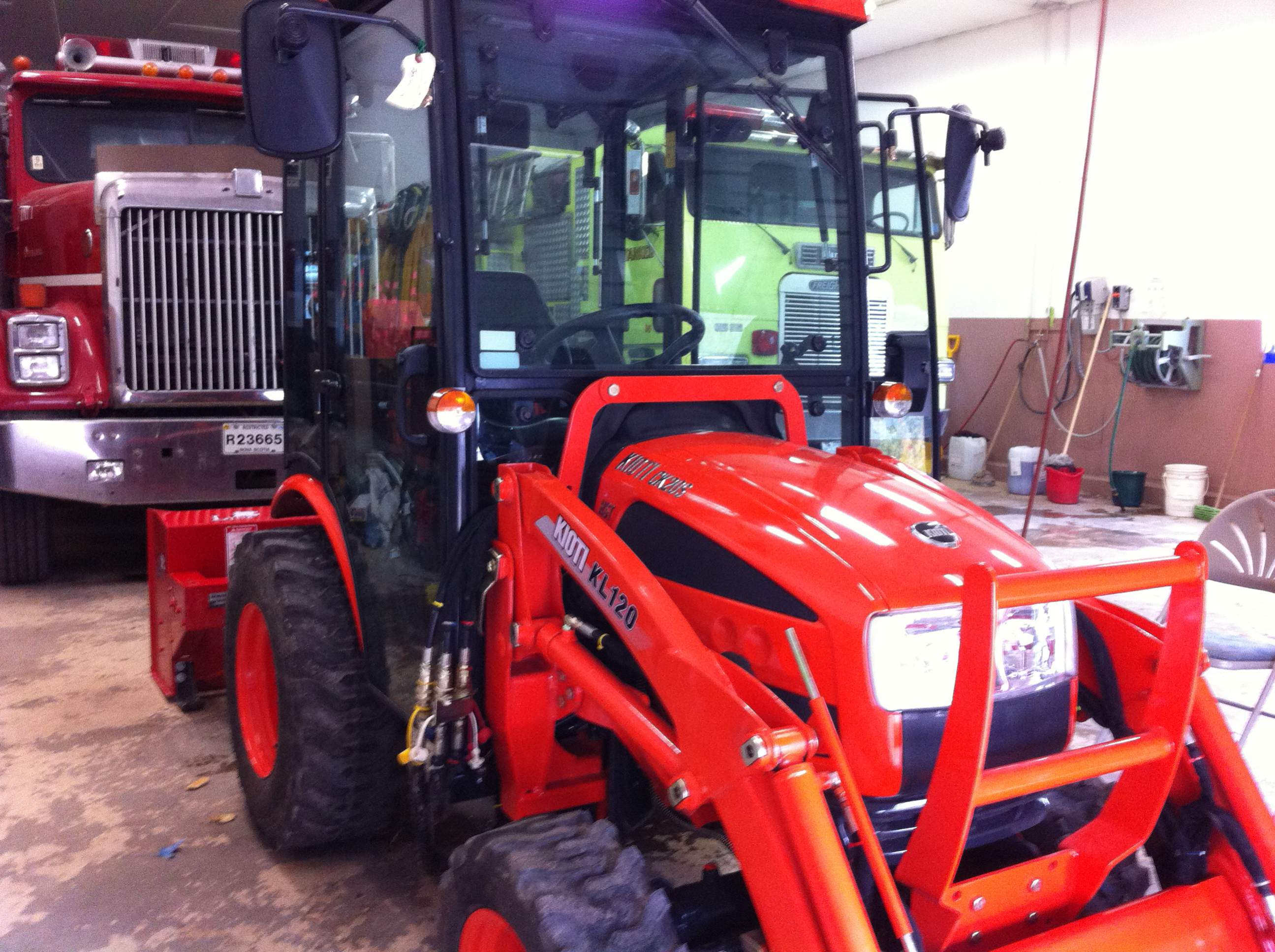

The heat is now working - there was air in the system. Yes, it's quite a job and there were several things missing from the cab kit but I hope the dealer is going to replace them for me. The only thing that's not working now is the rear wiper. I don't seem to be getting any power from the switch to the rear. I even managed to get the signal lights fixed today as well. Here are a few pics of the finished cab. Thanks everyone for the replies. inside cab.jpgoutside cab.jpg
