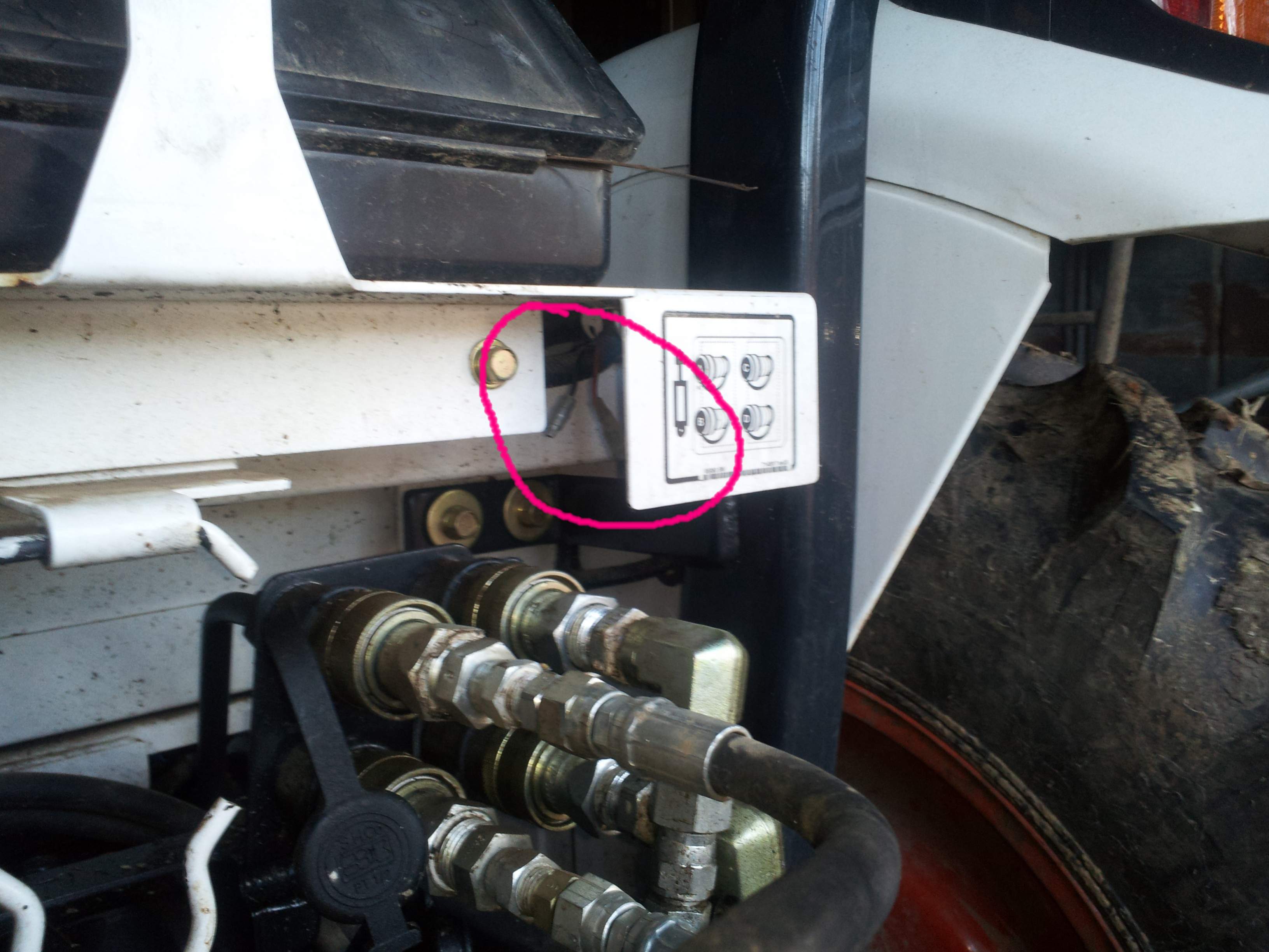

Here is where the wires are on the "white" version. Imagine it should be the same on Kioti.

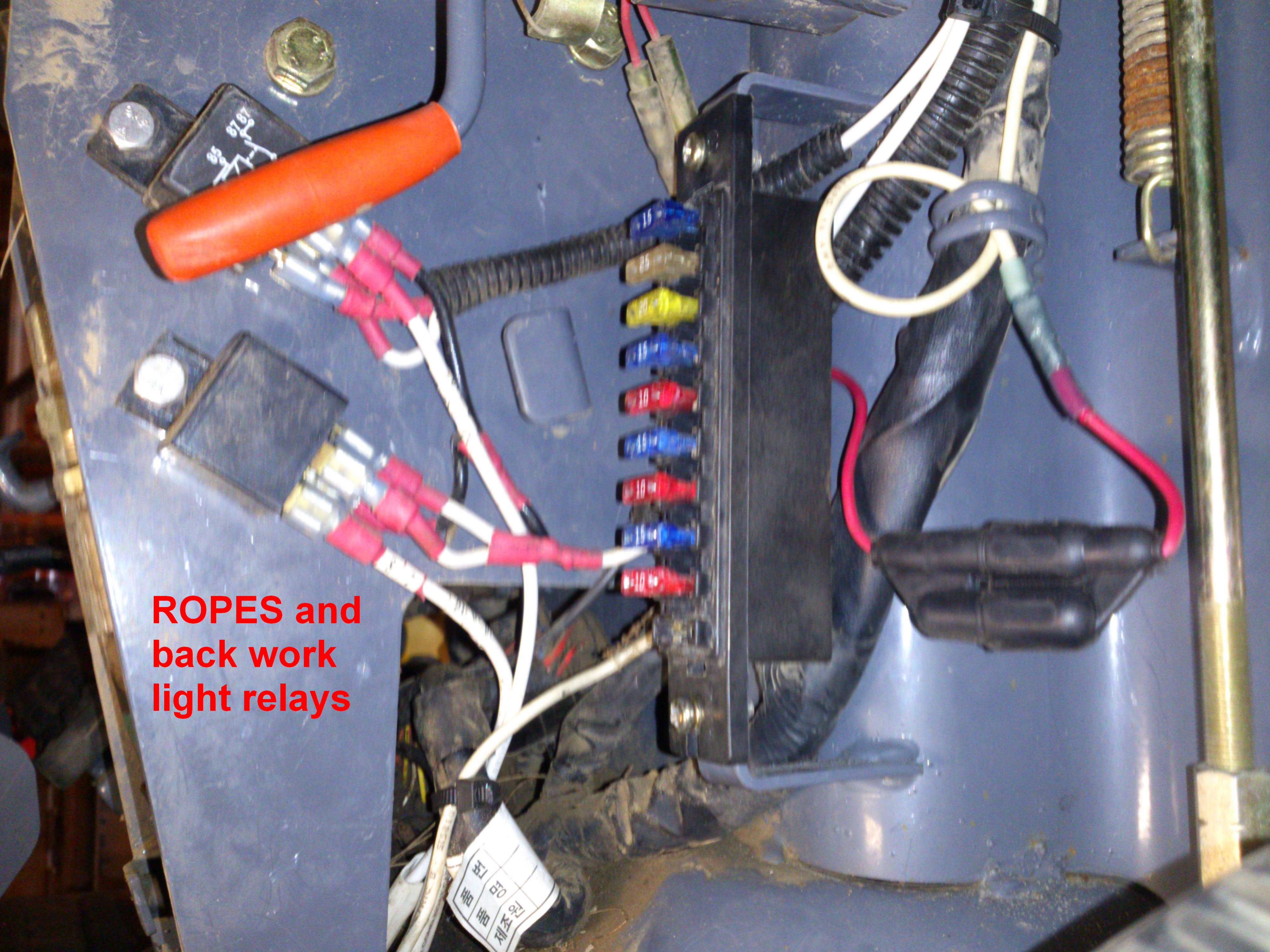

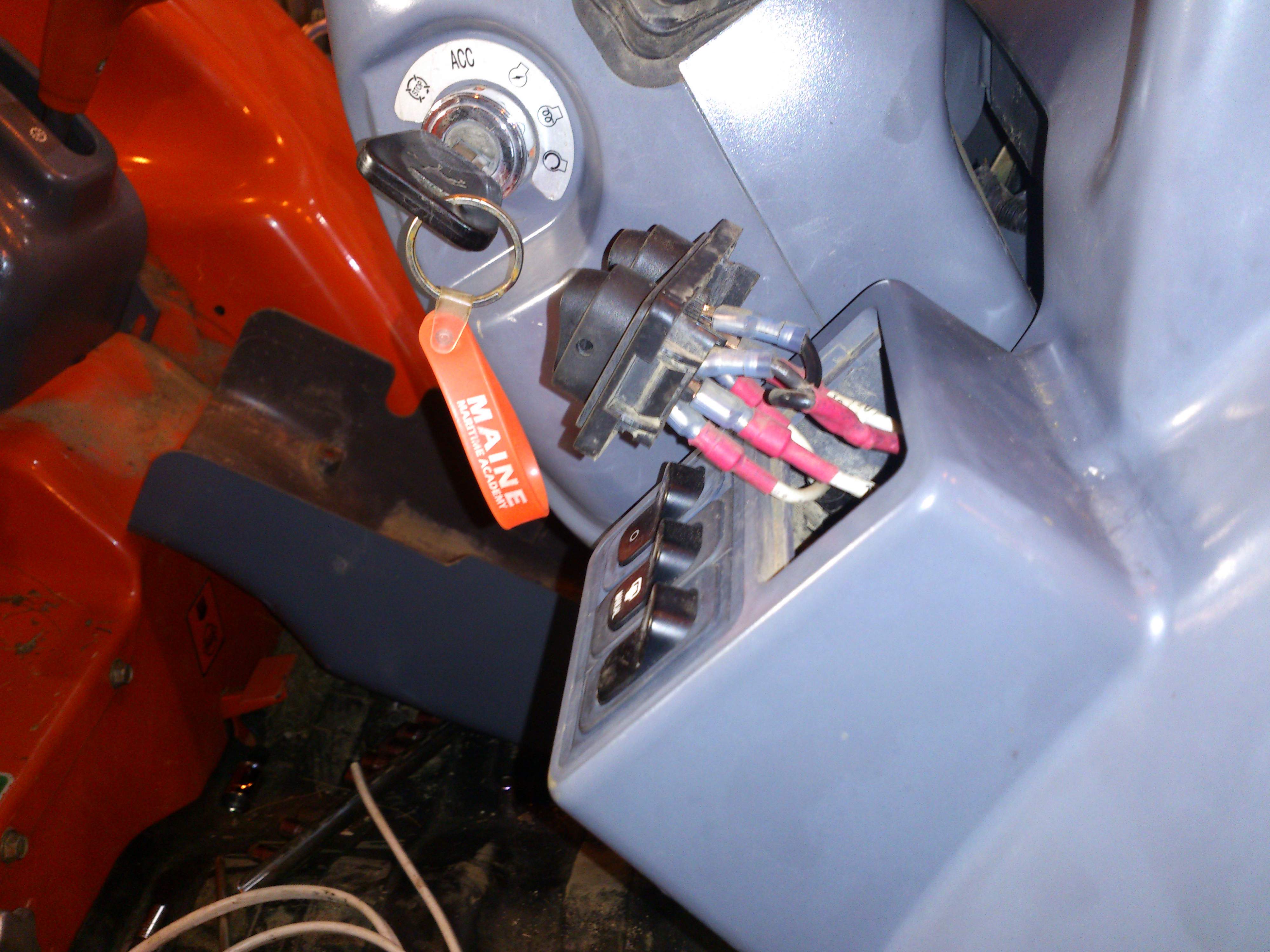

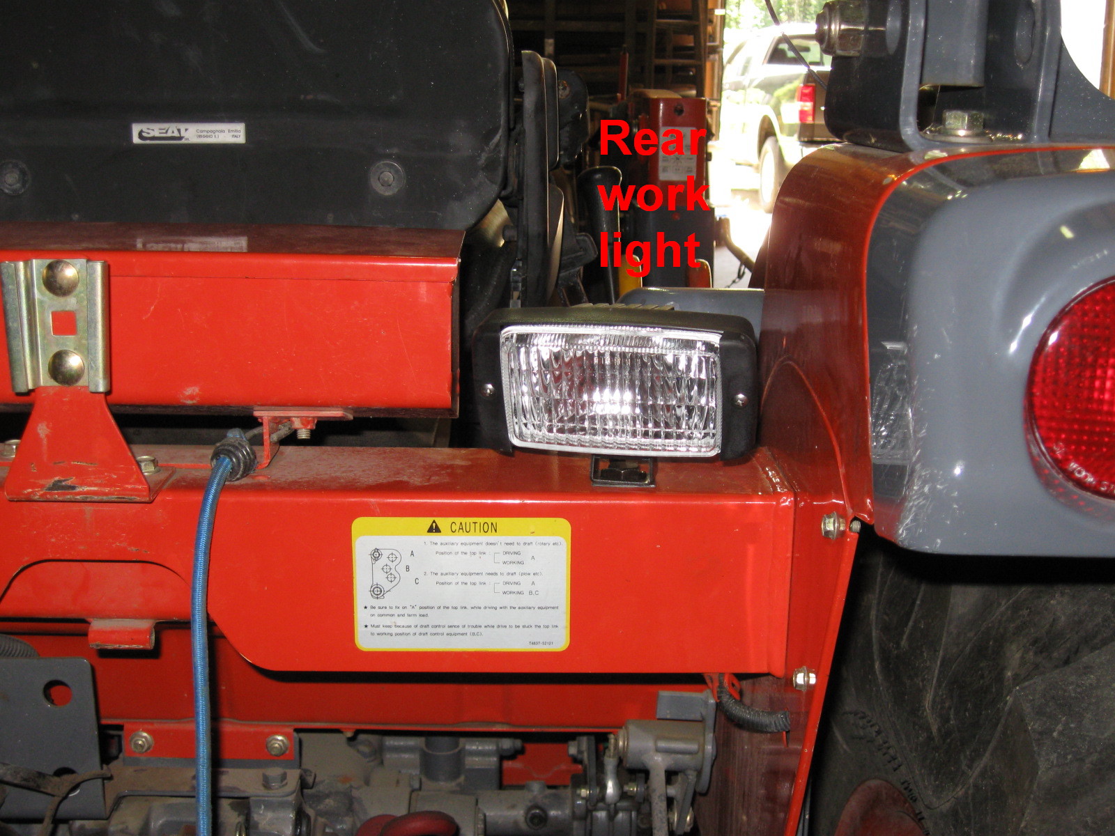

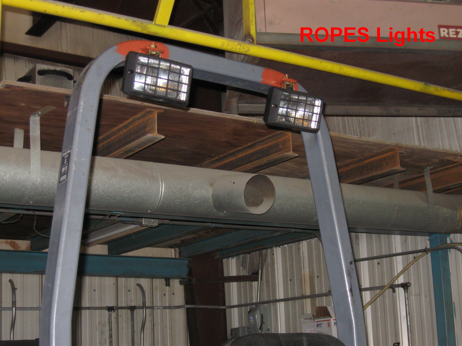

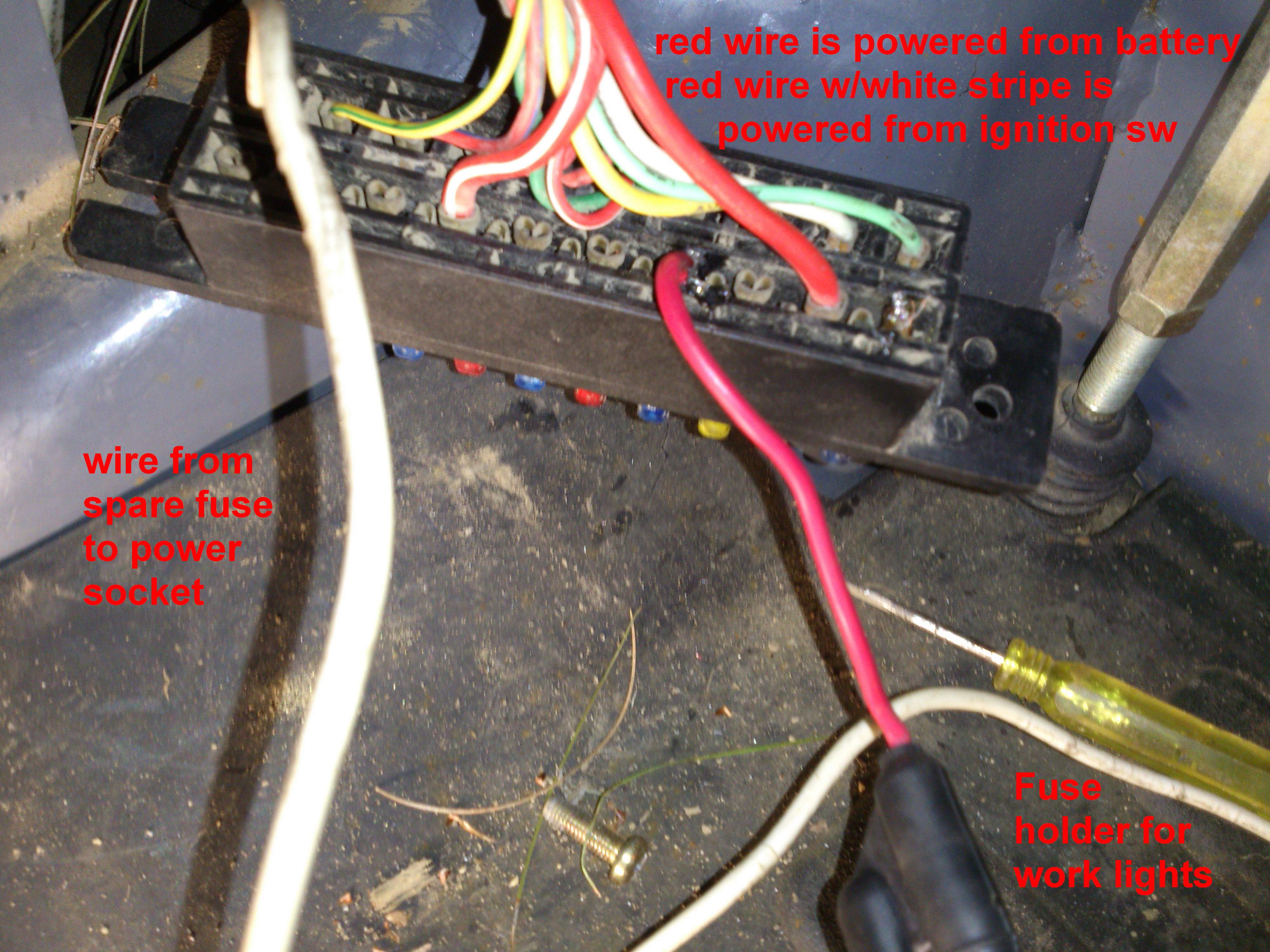

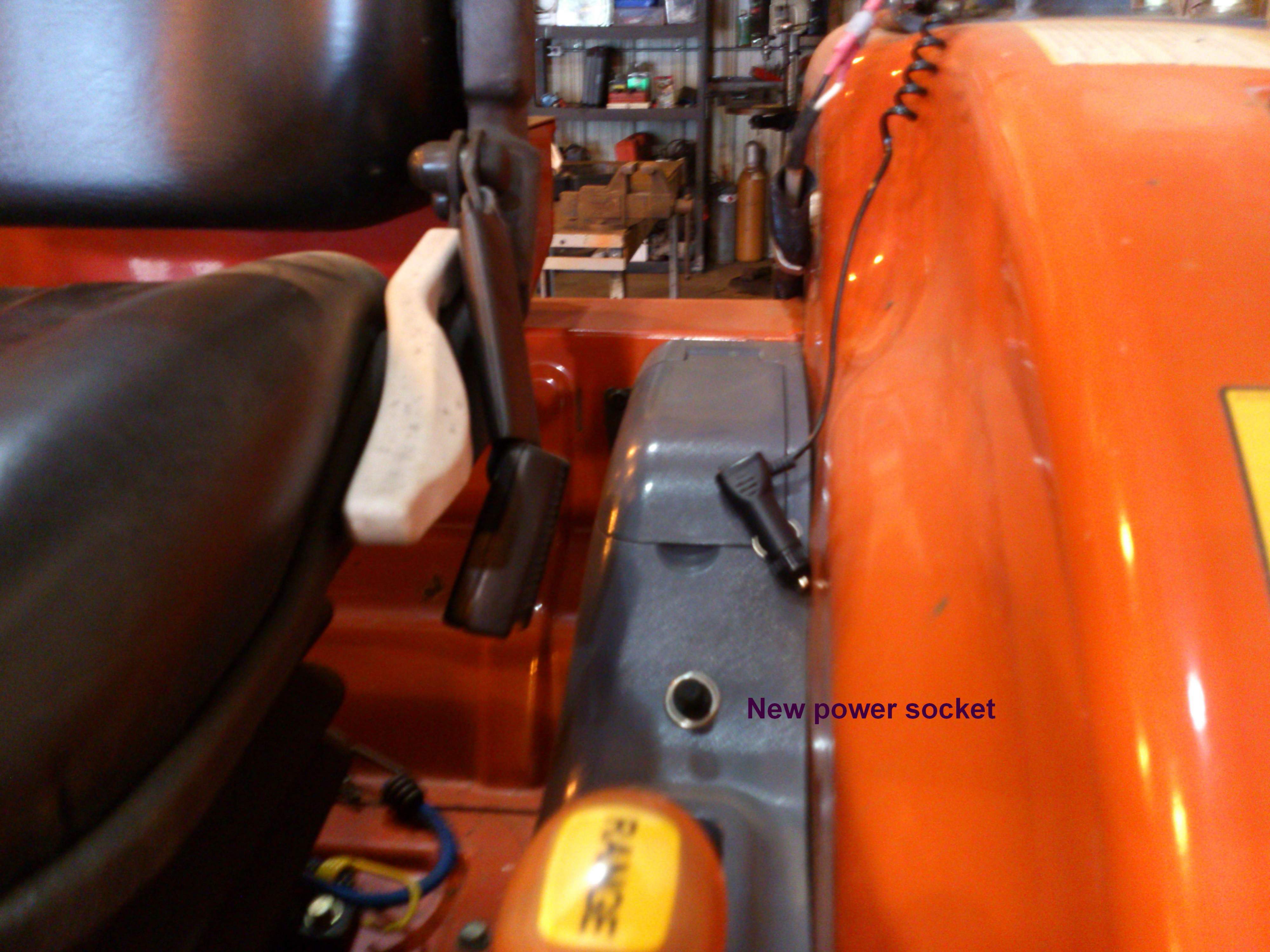

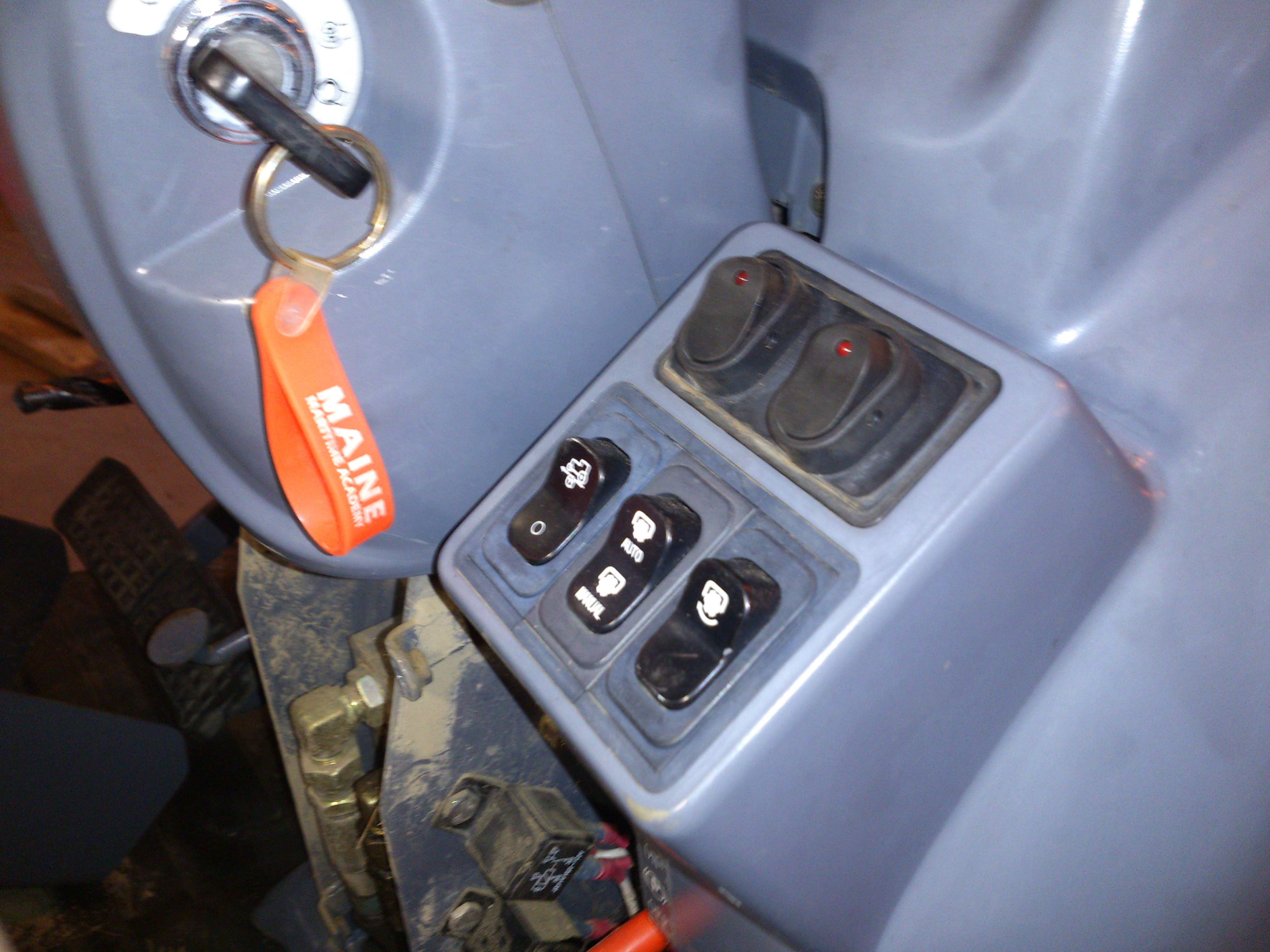

This is how I wired ROP lights, back work light, and a power socket on my 07 DK45SE HST. Don't know how similar it is to your CK27. I did not use the existing "hot" wire at rear of tractor. I wanted to save that for anything that comes up in the future.
I wanted the ROP lights and rear work light to be on own switches and powered off hot side of fuse block through relays. I wanted power socket powered through the spare fuse off ignition switch side of fuse block

Relays and switches are from NAPA. Lights I think walmart. They are 55w halogens that a lot of places carry. Power socket I had laying around. I use marine grade wire and connections. There is a big commericial marine store not that far away. They did not have any switches that were as well constructed as the NAPA ones. They have lived outside with the tractor now for a year with no problems.

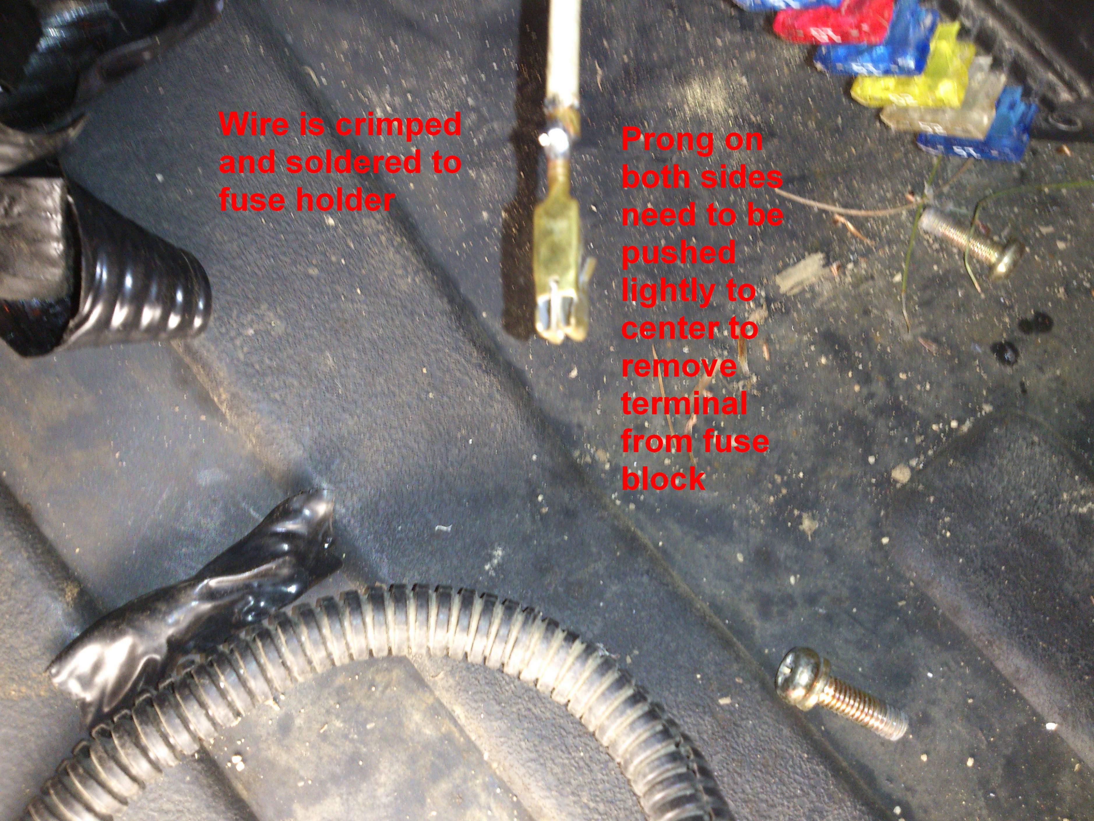

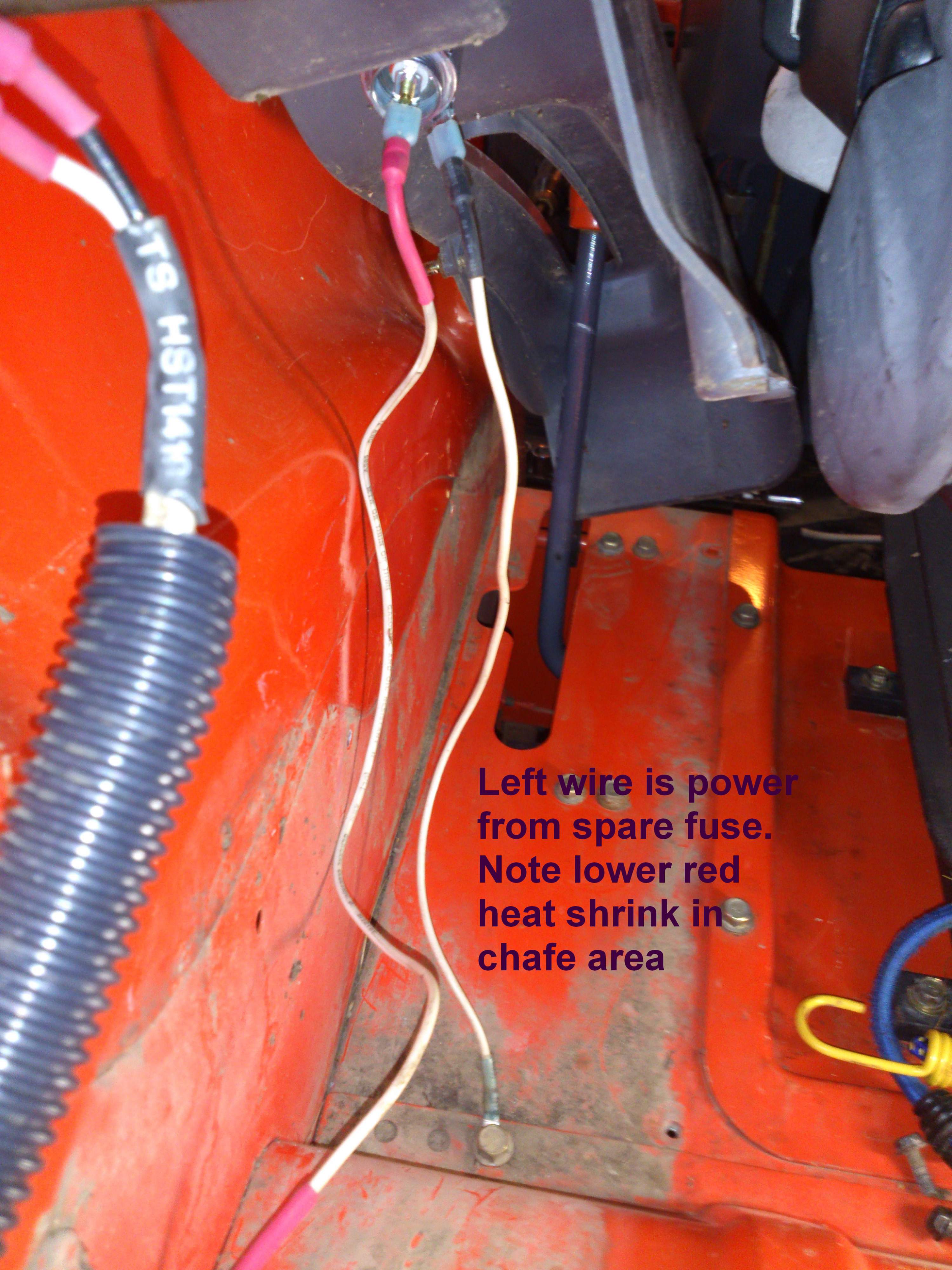

The switch plate is just the blank on the dash that was on the tractor. It is fairly soft plastic. I outlined base of switch on the blank. Drilled 2 holes with a drill close to diameter of switch outline. Then I trimed to the outline with an exacto knife. Switches are designed to push in hole in dash and latch.
As far as wiring the power socket, I used the spare fuse on the fuse block. I used 2 small screwdrivers to press the prongs in to release unwired connector from fuse block. I crimped and soldered a 14 ga wire to connector and ran wire underneath the tractor following existing wires to rear and then under left console beside seat. I attached this wire to center terminal of socket. Then I ran a ground wire form outside terminal on socket to near by bolt that was threaded to tractor frame.

Ok... Finally hooked up the lights tonight. Here are the results.
/ CK 27 lights hookup
#15
I used the male/female plugs on the back of the tractor. Those are activated with the ignition key only, so I installed LED toggle switch. The switch is red when the lights are off, and green when I turn them on. Used existing hole for the switch, so no drilling there. Ran the cables thru the upper pivot opening in ROPS... Wires will not get pinched unless ROPS are pushed all the way down.... Drilled one hole on top to pull the wires to the lights.... Not worried about that mod at all. Lights are LEDs from northern tool... 69 bucks each. I'm really happy with the brackets I got from messics.... 30 bucks each and ability to swivel the lights around. I will report on brightness in a few days. Overall pretty happy how this set up turned out.
