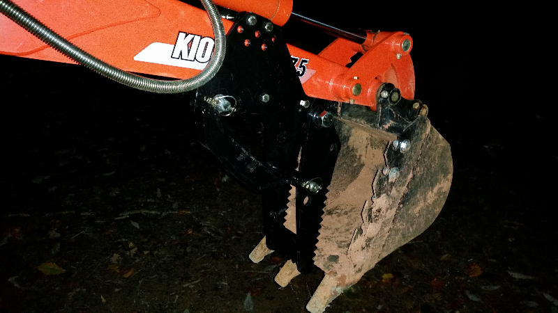

I understand now, the thumb is a fixed width that tightens at the top and needs to be widened to fit the 3 3/8" dipper boom of the KB2475.
   / CK 35 bolt on backhoe thumb #12
Exactly. It takes a very easy cut down the middle with a Sawzall and 1 pin. This is the cheapest way to put a thumb on the 2475 out there. And it works!

Couldn't you easily add a hydraulic to that mechanical and have it made?
   / CK 35 bolt on backhoe thumb #14
It kills me that it misses by 1/8". They also have weld on kits and assemblies.
   / CK 35 bolt on backhoe thumb #15
Due to the linkage angles it may be tough to convert. However, I will definitely be trying to figure out how to make it work.
Real world, it is about 1/4 - 5/16 too narrow. By cutting it right down the middle, it keeps the mount from shifting much.
I hope others will see this as a low cost opportunity to the other manufacturers. BTW, the thumb is built tough!
