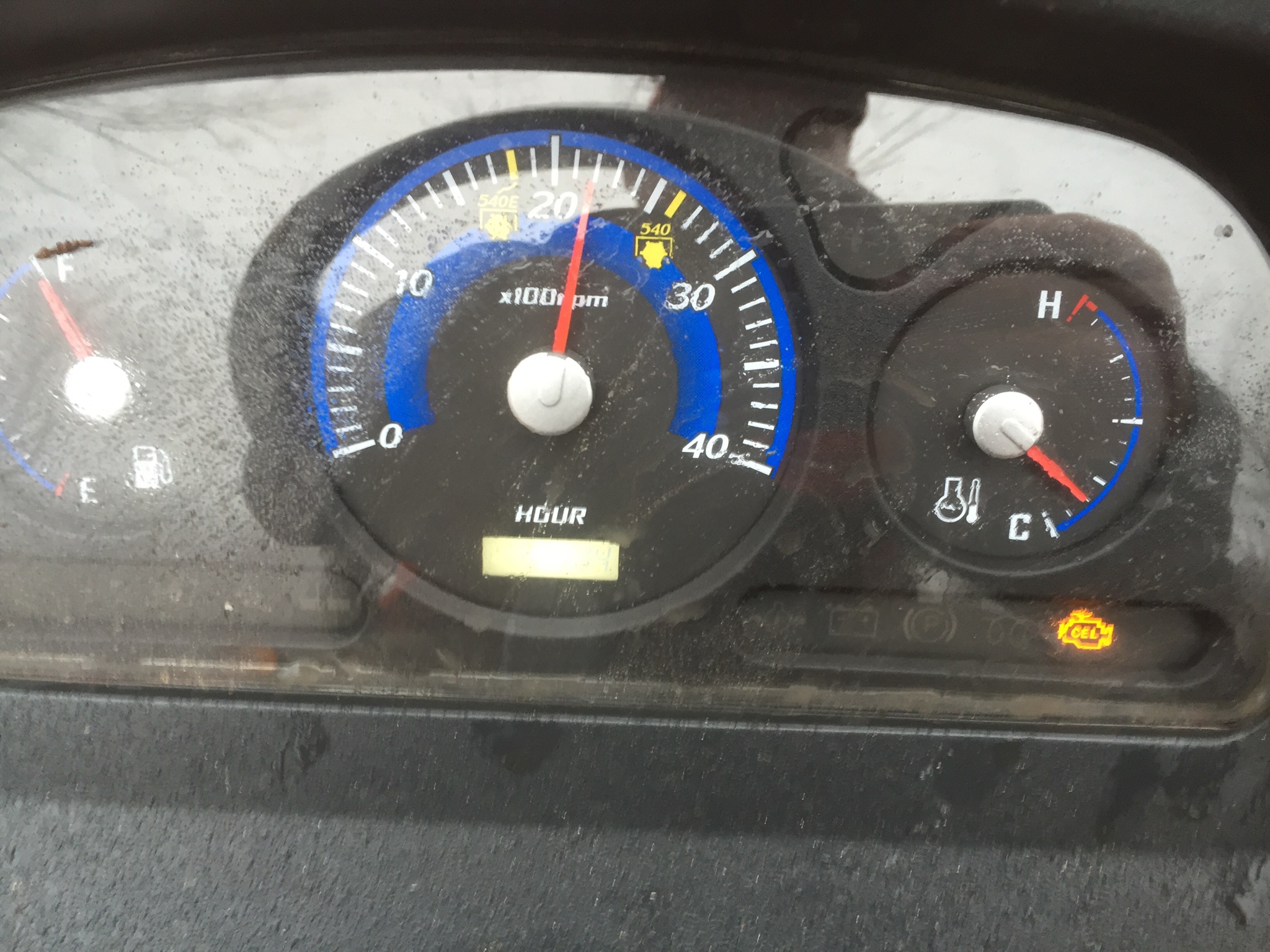

Kioti ck40hst
Hi everyone, posting here for the first time with a cel problem on my ck40. At about 50 hours the light would sporadically come on for no apparent reason. Sometimes within 10 mins of starting the tractor sometimes after 4hours and sometimes not at all. Same sporadic timeframe for when the light goes out as well. I called the dealer up, told him about and he sent someone out to ck the computer but it threw no codes. Of course the light didn't come on for him. They ckd with kioti and replaced, I think it was a sensor, don't remember for sure. Didn't take long and the light came back. Dealer came out and picked the tractor up and took it back to there shop. There they linked the computer to kioti where kioti tried to diagnose the problem. They had the dealer replace the wiring harness this time. Got the tractor back and a couple days later light came back. I've been really happy with the tractor and the dealer. I'm sure they'll keep trying and get it fixed but was wandering if anybody else is familiar with this problem or have any advice? The tractor now has 155 hrs so I use it alot and hate to keep having down time while its at the dealer.

Hi Guy,
I've got a very similar problem here. I'm at a little over 100 hrs on my CK4010 and have it in the shop for the third time for this CEL problem. I believe they tried a similar fix to yours, reprogramming the computer, cleaning the EGR valve, etc. Did yours ever get fixed completely?

As far as I know mine isn't fixed yet. As far as an update since I made the original post here........in February when it was relatively cold I had an issue with it smoking and sputtering. Cel light was on. Dealer wasn't sure but after the smoking/sputtering problem they changed the fuel filter. I also pulled, drained and cleaned the fuel tank and recovered the screen that I accidentally knocked into the tank the first time I fueled it up. after that I haven't really used the tractor but I doubt any of the above fixed the cel problem. Here soon I plan to put some time on it and if the cel problem still exsists I'm going to call the dealer back. It sounds like quite a few of these tier 4 tractors are having the same problem so I hope kioti figures out a solution soon. Mine comes on randomly and always goes out after a restart of the engine but will usually come back on within a couple minutes. Please keep me posted if you get yours resolved as I'm desperate as well
/ Ck 40hst check engine light #6
I got mine back yesterday and so far so good. They put in a higher temp thermostat, cleaned the EGR valve, bypassed the EGR, and updated the software. Time will tell if it really fixed it. I'll report back if it happens again.
/ Ck 40hst check engine light #7
I had the same thing happen as Skold they put in a warmer thermostat and EGR valve it fixed it so far I have 35 hrs on it now
/ Ck 40hst check engine light #8
I got mine new in January CK3510 same thing at 15 hrs. get a warmer thermostat and check that EGR valve, kioti should have a recall for this problem. The dealer fixed it for free, they know all about this they said they had three others with the same problem that week.
