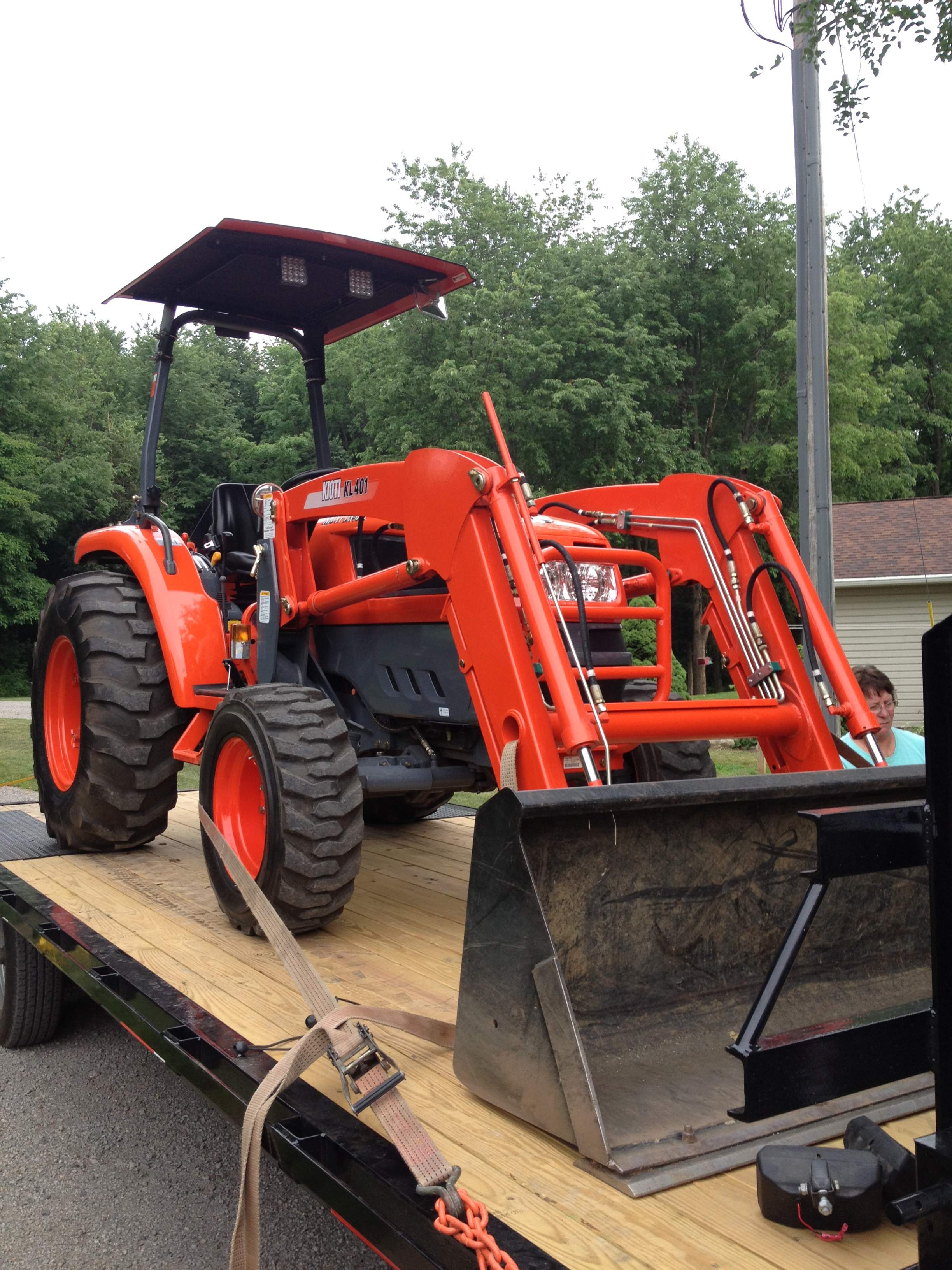

Done Deal! I'm now the proud owner of a new Kioti DK40SE Hydro. It was delivered this morning. Sad to see my ck getting towed away, it was a good tractor. The DK is just a completely different animal. No comparison. Bigger, Heavier, the loader is massive. And the hydrostatic trans. wow! I'm old school, wouldn't hear of a hydro before. My knees just can't take the wear and tear anymore. I was outside playing and learning in 10* temps all morning. Just love the Hydro. Now I understand how most would never go back to gear drive.
I want to be clear. The CK35 is a great tractor, just came up short on the loader capacity. Comparing 1100pds to 2700. Six foot wide loader on the DK compared to 5'.
My deal was the ck gear with 150 hours to a DK hydro new, just uncrated, and 10k.
I know I took a beating, but I won't look back. The Tier 3's are getting scarce, I'm lucky to have found one. This particular tractor came from Vermont. Almost 300 miles away. NJ, Pa. dealers just weren't interested in the trade. They said the dk was unavailable. I just turned 62 two days ago. Great BD present to myself.!!

That is great, but you need to post photos! ;) How are we supposed to enjoy the experience???
/ ck dk trade #40
Yes and ooze envy???
