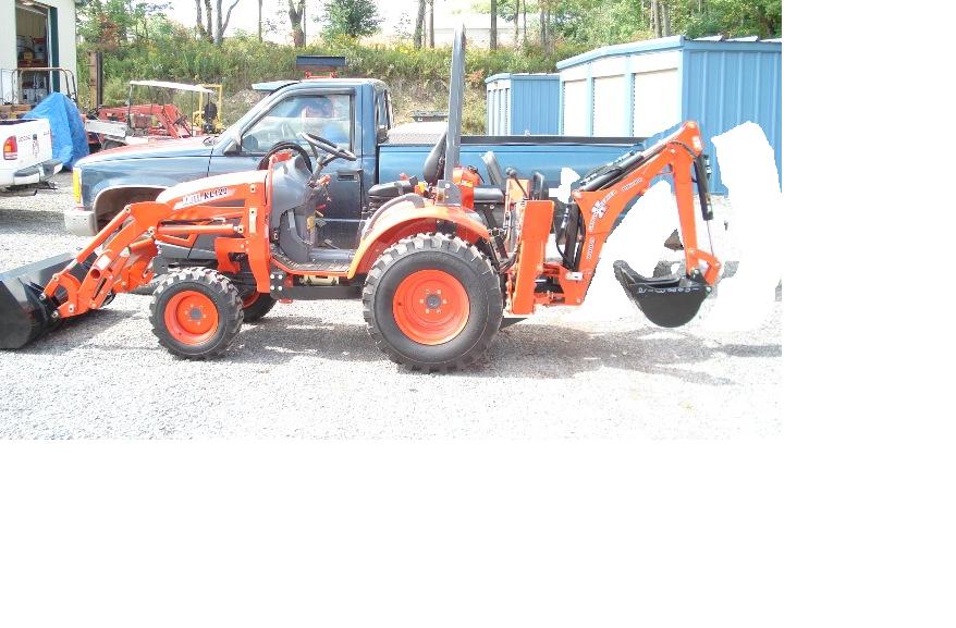

I think I am going to end up going with a CK20, but with a custom Hoe sub frame.
I will probobly go with a Woods BX70 and a custom subframe to get the outriggers about 1-2" off the rear tires. this would put the BH seat where the fuel tank is.
Has any ever moved the fuel tank on a CK20 ?
Thanks,
Slack

/ CK20 fuel tank relocation ?
CJ,
Thanks for the picture, that is just what I am looking for,,, Minus the 1 foot between the outriggers and the rear tires.
I looked at the woods manual online, I could take 1' out of the bracket between the BH and the 4pt subframe and it would be perfect except the BH seat would be where the fuel tank is. So I have to figure out what to do with the fuel tank ?
Nick
Simple alteration in MS paint,
but here is what I am after, I really do not want to purchase a Kubota 2320, but they have the whole backhoe thing down.
Nick

Yeah, Nick, that CK20 fuel tank is a big problem. Like you, I would not
want one of those subframes that stick so far out back.
I have owned the CK20 and it is a very impressive smaller CUT. My B21
is about the same weight, but with an excellent integrated hoe. Very
nimble, too, due to the short wheelbase. I think you should get a used
B21.

If you are bent on really doing this......What if you raised the operator platform so that the seat is on top of the fuel tank? I just don't see where you might move the fuel tank and still be safe.
/ CK20 fuel tank relocation ? #20
The Kubota B2150 suffers from this fuel tank location, too. This photo is
of a b/h seat support modification so it clears the tank. For the CK20,
this could be done, and maybe a custom lower tank can be fabbed.
