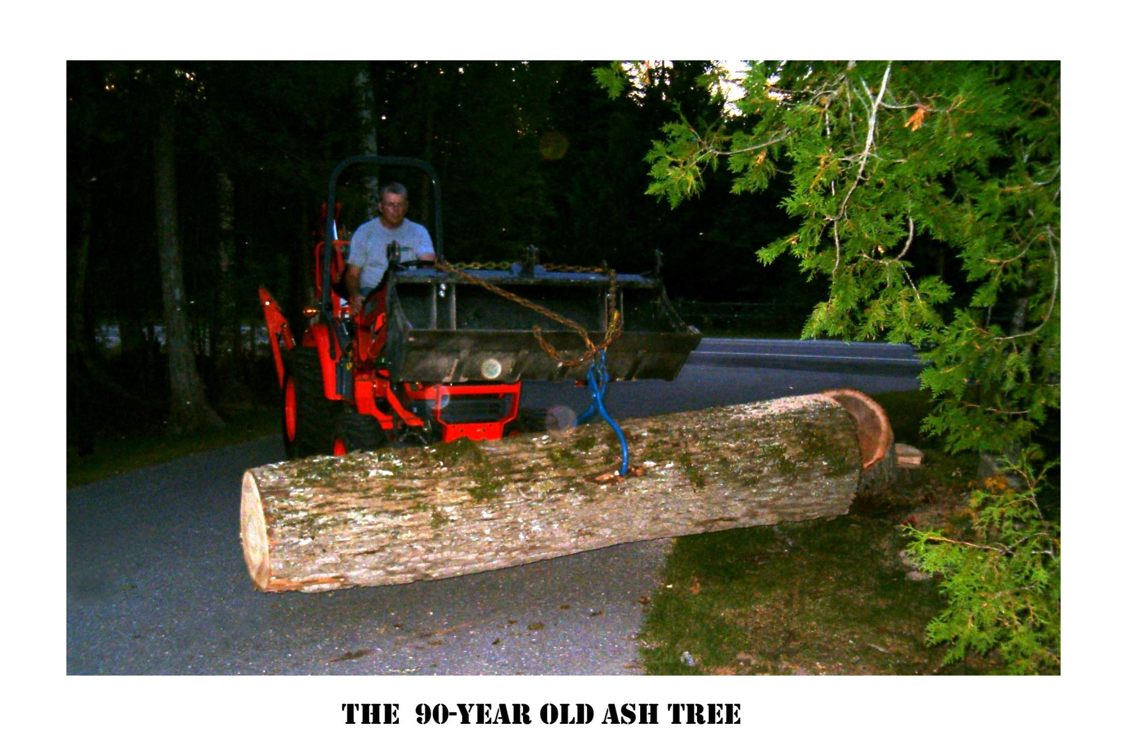

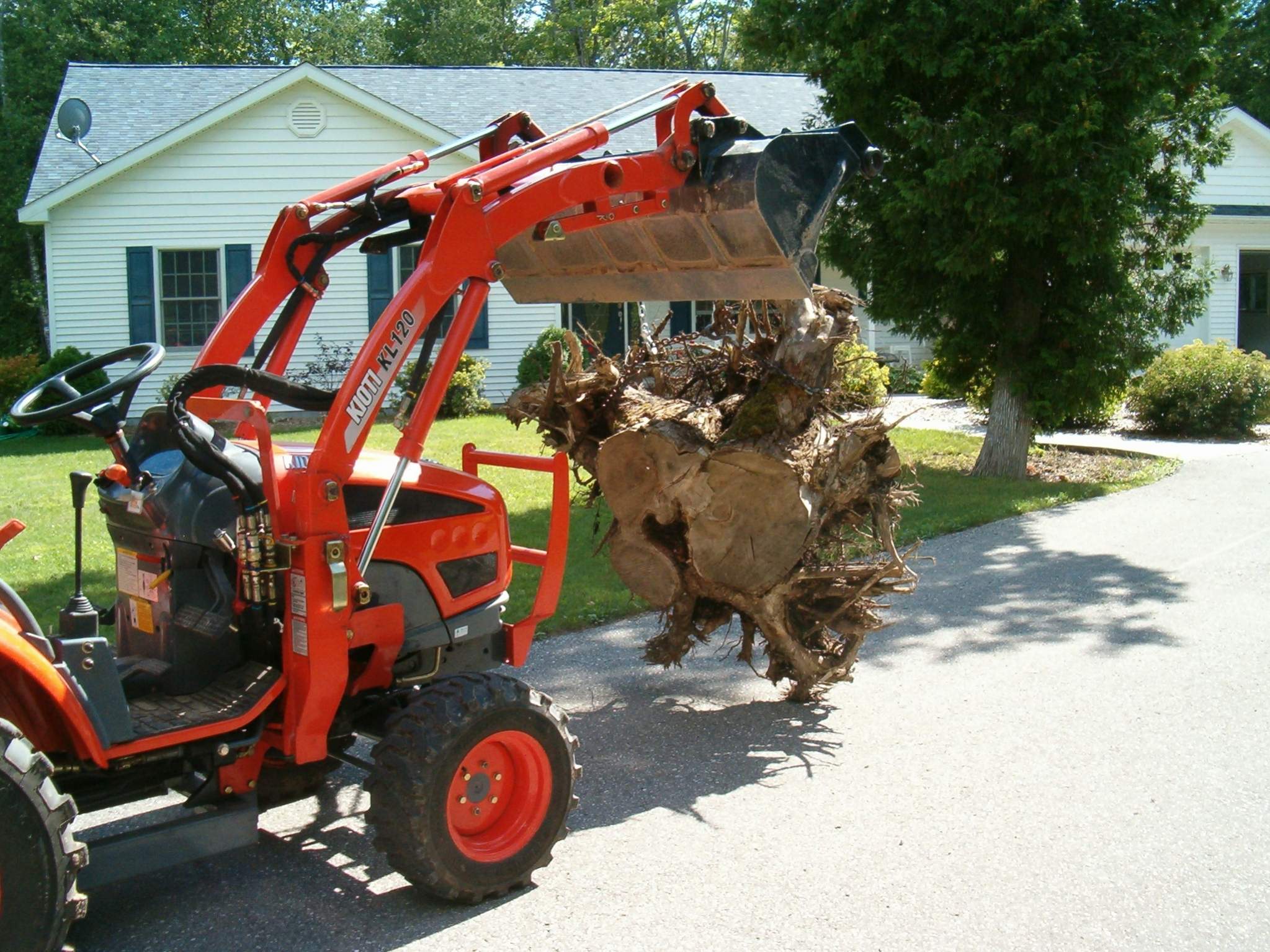

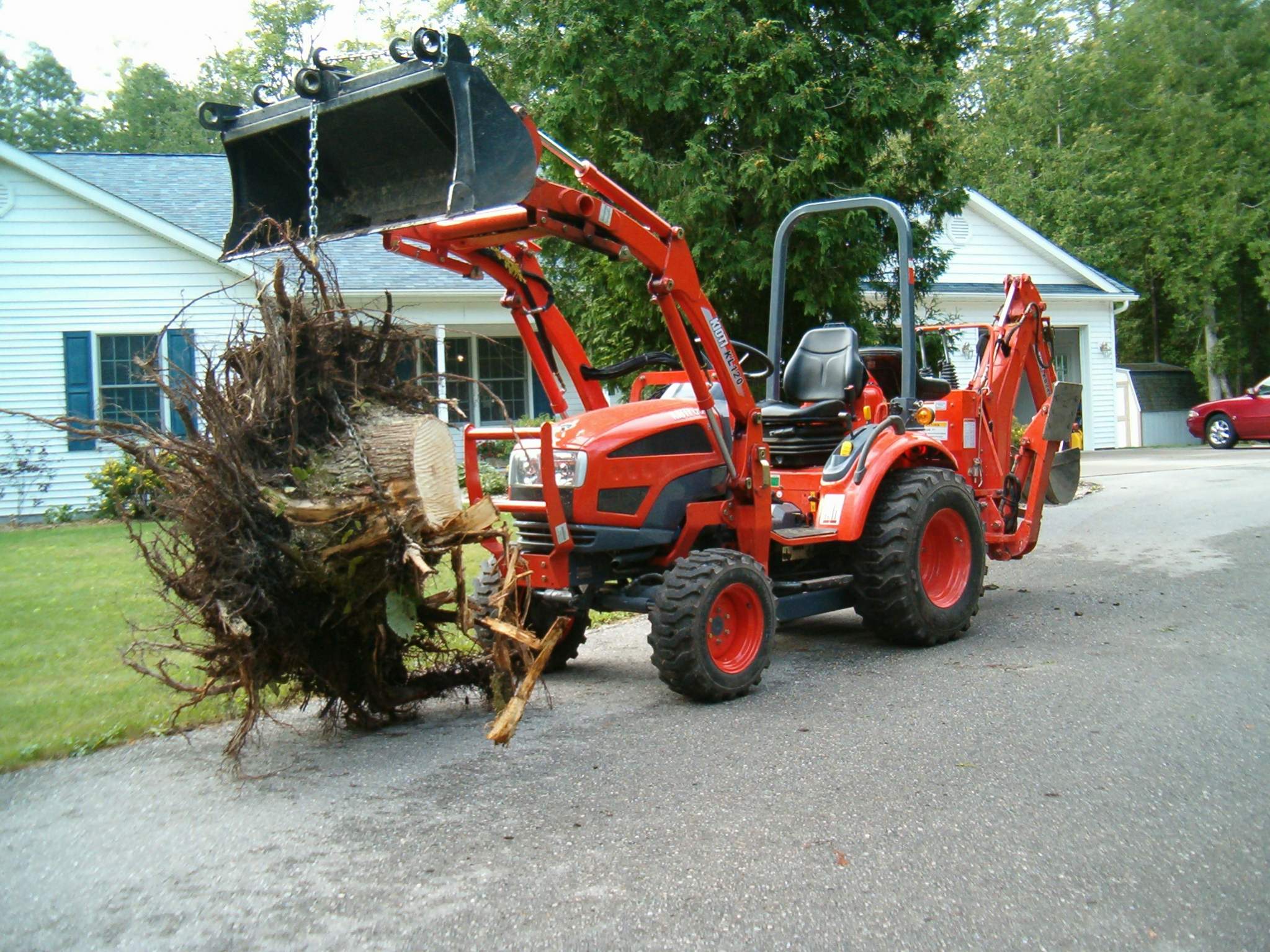

I have darn close to 800 hours on my CK20. It runs a five foot rear blower kicking snow out of sight, Has probably dug 80 stumps with the backhoe and never met one it could not handle. I've picked up fallen mature maple, Ash and White Pine tree's that I have cut by the butt section and skidded he whole tree out of the woods. It's been just the tractor for me and I would do it again.
