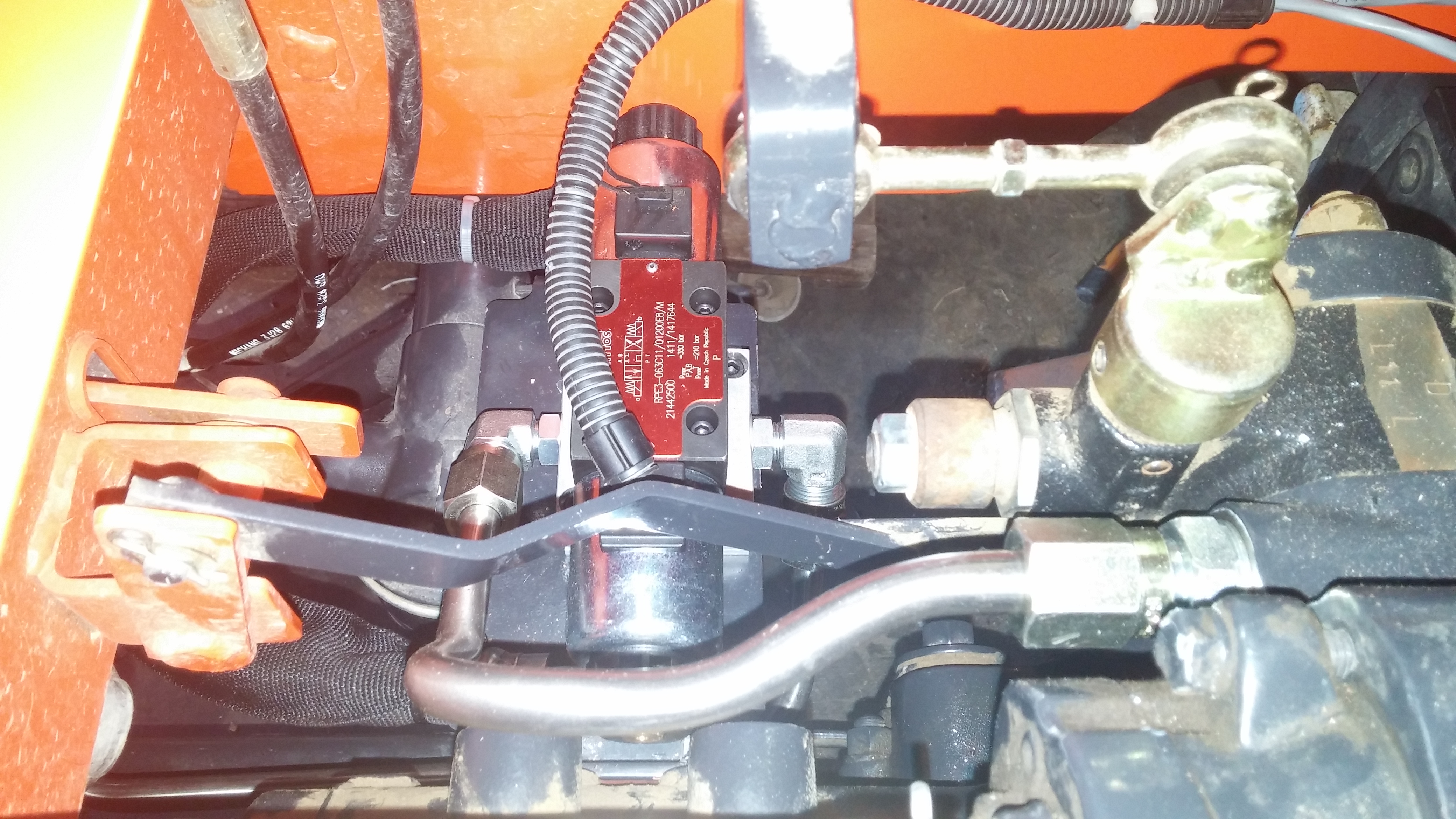

Realistically it would cost you probably around 400 to do anything else like having a dealer tie into the power beyond with fittings and hoses. Think of it that you have increased the desirability of your tractor. If you ever decide to sell, you might get that 400 back and you can always use it for many other things like a front grapple or 3pt tilt if your situation changes.
   / CK25 Hose Kit
#12
So could anyone point out the line I would have to modify to get the power beyond function. I went through my service manual but seem to be more confused than ever.
   / CK25 Hose Kit #13
If you take up the seat it is the steel line that comes up from the loader valve to the rear end and ties in right next to the 3pt down speed adjustment unit here is a picture of mine where I replaced the line with a 3rd function valve.
   / CK25 Hose Kit
#14
Thanks for all your assistance and the photo. I was able to get everything done, and working great because of your help. Much appreciated. My final cost for the setup was $76.00. Thanks again!
