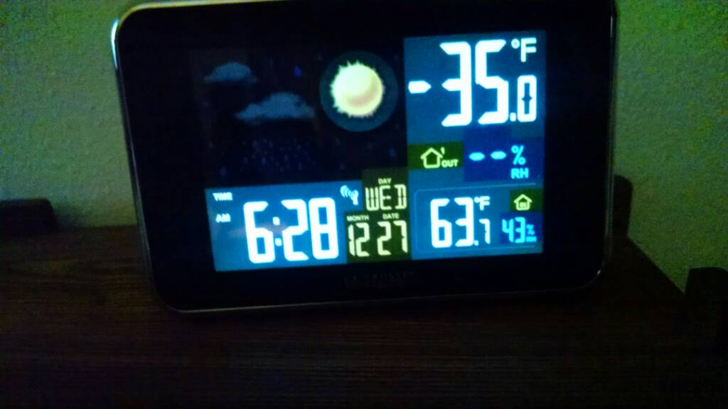

You might need to run number 1 fuel or mix some with the number 2.
I'm not a big fan of additives.
It's been below 0 for awhile now here in northern Minnesota. I'm fortunate to have a heated garage to keep my machine in. If I had to keep it out, I would just use straight no.1 IMG_20171227_062846270.jpg

It's been below 0 for awhile now here in northern Minnesota. I'm fortunate to have a heated garage to keep my machine in. If I had to keep it out, I would just use straight no.1 View attachment 534129
