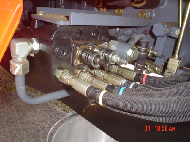

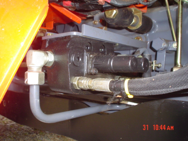

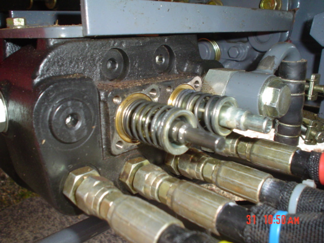

Just took off the two end caps as suggested. Did not see anything unusual.
Put some grease in it but no difference. Will change out the two cables when I get them from my dealer. The main problem is that the joystick, ONLY when pushed forward from the middle position, does not want to return, so the loader will keep going lower even when you have released the joystick. This is not in the float position. All the other potions, back and left, right, the joystick comes right back. If anyone has other info kindly post.
With the caps off, your's looks nice and clean. Way much better than mine was. I guess you have one third eliminated and soon two thirds with the cables. The last thing is the cinimatic(spelling) kit. That's the one with the three balls and a pedestal type thing that the actual joystick is bolted through. Maybe one of the original plastic balls are worn and binding in one direction. The front/back or raise/lower is the one on the left of your picture. The outer one on the block. It should be as good as new when your done.
