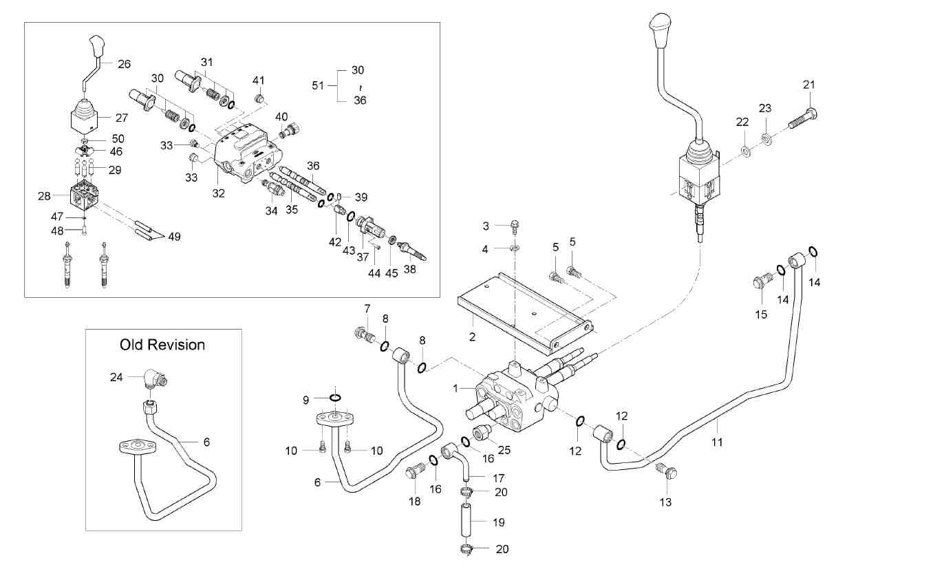

Follow your loader cables down to the control valve. On the end of the valve towards the front of the tractor, you'll see two caps held in place with allen head screws. Remove the outer one and you will see how the detent works. Similar to male and female ends of air hose fittings. The cap has three tiny balls in it (like the female end of the hose fitting) that will wear out and then the float just won't hold or if the float is hard to engage - you need grease in that cap. Very simple to take care of unless the balls are shot, then the float won't hold - I know from experience..........and the new cap is over a hundered bucks. Good idea to keep your balls greased:)
   / CK30 FEL Joystick repair #13
Maybe this will help some of you guys out...

Just wanted to throw a little update on this. I tried greasing the detent mechanism but my float was still very hard to disengage. Next step I took the cable and detent mechanism off and pushed the spool out the detent side. I worked the edge that catches the detent balls (part 36 in the diagram) with a very fine file then polished it with some emory cloth. I took maybe a few thousands off and rounded it over a bit. Works perfect. Obviously you'll want to be very careful and not take too much off or you'll be using a bungee to hold the float. Reminds me of a buddy in high school who used a bungee to hold his VW van in gear...

Check those caps on the hyd. block under the floor as Hodak mentioned. Mine was an easy fix after a little cleaning and more grease. It works like new now.
