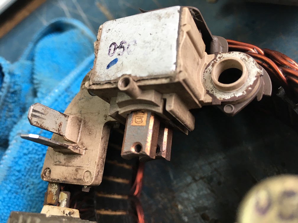

It was a mess. Cleaned it all up but I think the reg itself is cactus.

/ CK30 HST Alternator #6
Very nice job with the cleanup! Good luck with this. Please keep us posted.
Yes, i am totally mystified as to why the brushes were such a mess. Where did the goo come from? The motor has no oil or coolant leaks whatsoever. I have it running again but unfortunately I am suffering a back injury at present and can not follow up until I heal. Flat on my bed at present.:(.
/ CK30 HST Alternator #10
Strange amount of gunk on those slip rings. Even if that bearing seal failed and grease leaked out still would not account for all of that. Impressive sized slip rings though.
Hope you and your alternator feel better soon.
/ CK30 HST Alternator #11
I think (maybe) that gunk was actually ground up brushes and slip ring. I have absolutely no experience with Valeo alternators, but I have worked quite a bit on Delco, Autolite, Prestolite, Motorola, many with 100,000 miles +, and I have never seen such wear on slip rings! I have seen such wear on generator brushes & commutators, and it is a very similar amount of gunk build up, albeit off to the side, not right where the brushes ride.
As deep as those grooves are, apparently it is not unusual for Valeo, and there still can be a lot of wear left - although if they got that way in 600 hrs, what chance do the slip rings have of making it another 600 hrs?

That does not appear to be wear on the slip rings. It appears to be machined grooves. I haven't seen that before either but the edges are too clean and sharp to be worn away especially in the bottom of the groove. I looked hard at that. (yes it is unusual)
Luckily the retaining pin holes were still in the brushes so I was able to get them back in safely without damaging them but not sure how they will come out 'next time'.

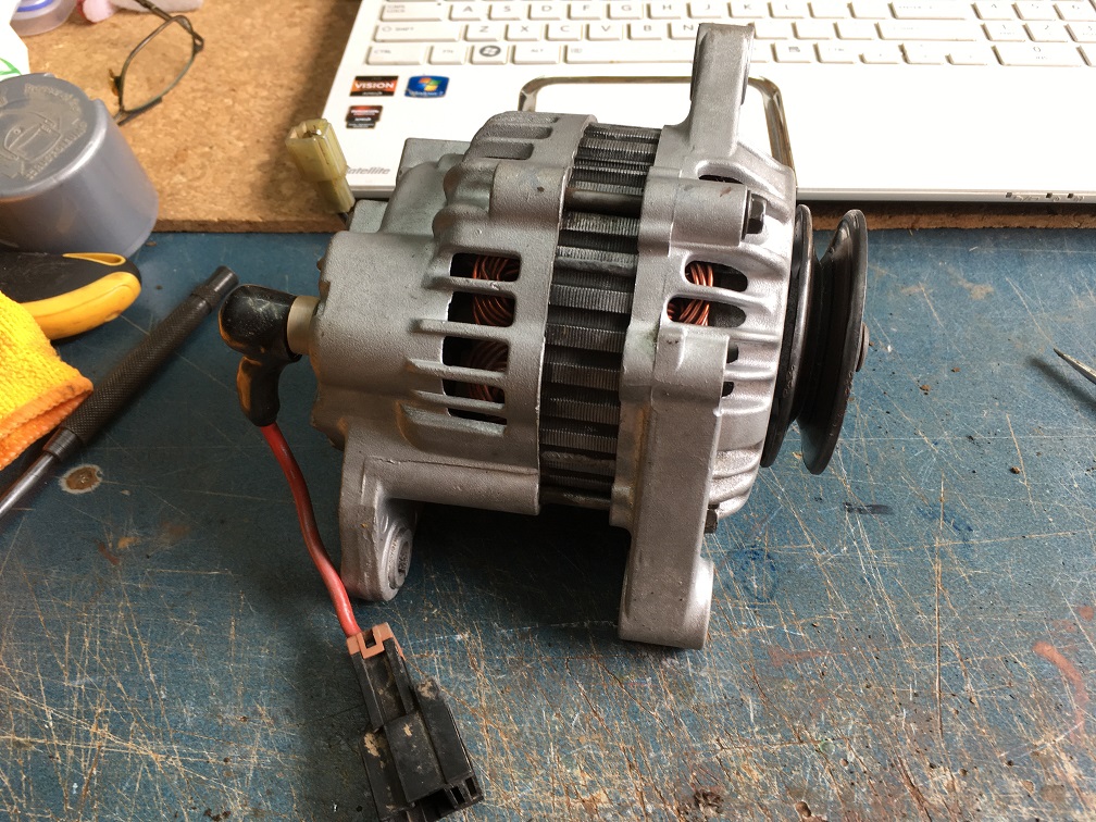

#14
Back again and the operative word is BACK. I have been out of commission so only just managed to get back to my Kioti today.
Yesterday I called in to see my neighbour who has a number of wrecked cars lying around. 2 of those happened to be 1980 series Ford Lasers
One had the alternator removed so I did a comparison and it looked promising. Slightly larger diameter but the brackets were pretty much the same.
It was also a 60 Amp rather than a 50 Amp like the original.
Neighbour told me it came off his car and it had been working OK and I couldn't argue as he gave it to me for nothing.
I had to extend the Sensor and Warning Light wires and fit the earth wire from the original. The Main Battery wire I had to remove the silly big connector and fit a normal insulated washer and nut.
The only other mod was the bottom main bolt goes in from the rear instead of the front and had to be shortened 1" The Ford had a thread in the front bracket where there was none in the original. Much better as you don't have to loosen the radiator stays to get the alternator on and off now.
Incidentally it is a Mitsubishi brand Alternator. It also has an internal regulator.
The pulley was also the correct size but I could have used a slightly longer fan belt. It would have been easier to put on.
I found the reason for the goo in the old one. Not easy to see, but the Oil Cooler in front of the radiator has been seeping at the top pipe on the RHS. The fan has been dragging the oil back through the radiator and into the alternator. As I said, It is hard to see unless you have good light and have your glasses on. :)
Anyway, all working well. It's charging at 13.8 volts.
