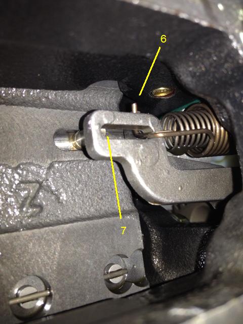

You got it....governor lever won't move until you start it and centrifical force takes over and moves it towards pin and pushes it to idle. If it was working properly and you turned key on and solenoid released...you would see that pin move all the way to governor tab then turn key to start and when it starts you will see the governor move the pin back to idle. When my first one went it was stuck exactley like yours in the off position. Teeth on gears in pump broke off and jammed it up.

So the 1st lever close towards our view is the throttle? That doesn't appear to touch or be in any position to ever touch that pin on the rod in the pump... Now that 2nd lever hiding in the back there the govener I believe you're saying that still doesn't touch the pin on the rod but I can see how it could do that... Unfortunatly, that pin doesn't move at all.
As for the tube piece I figured that's what you were referring too... I see another post here http://www.tractorbynet.com/forums/kioti-owning-operating/230395-ck25-will-not-start.html
mentioning to remove the stop solenoid... What is the dangers in removing this I see some words of caution...
btward: Hopefully, this excerpt will explain how the linkages are intended to work:
http://kittrellcommunitywatch.dyndns.org/Kioti IP operation
The figure is confusing because it makes it look like the rack pin goes in the slot of the throttle lever, which is not the case as dlw has explained.

As I understand it, the rack pin should be inside the slot of that lever and the spring acts on the lever which acts on the pin. ...
Disregard my previous opinion/thought. dlw has actually been inside these things and I'm sure he's right.
I was confused by an older version of the linkages. I now understand the IP rack is spring-loaded to the front so the forward position is established only by the stop on the governor lever (unless the stop solenoid or manual stop lever pushes the rack to the off position). The throttle lever (slotted one with spring) interacts directly with the governor lever (under front cover where you can't see it) to establish the position of the governor lever where it limits the forward travel of the rack pin.

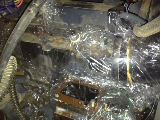

First let me say thank you so much to everyone on this forum for your help. This is truely an outstanding forum!
Update: I called the dealer closest to me (50mi) and basically he told me to get lost because I didn't buy my loader from him which was $500 more from him than another dealer that was 100mi away. There's a lot more to this story but I'll save it.
So I called the dealer I bought the loader from and while he said he wasen't sure there was anything he could do he felt for me and said he would try. I'm 39hrs and one month out of warrenty. I purchased used at 32 from a private party. Mark the sales rep at the dealer I'm working with (Miller Equipment) called back today and said Kioti is going to replace my pump! He passed me off to the service department to work the rest out. I told the gal how thankful I was and mentioned to both of these people the forum and how many troubles we are having with these pumps.
She said bring the tractor down and they'll pull it out inspect it if that's the cause have Kioti send the replacement. I told her unfortunatly and that I understand this is my problem. But I do not have a truck and trailer capable of towing my tractor and told her the cost to rent/fuel etc. She said she will talk to her tech and see what she can do. The dealer will be charging me for the time which works out to around $340, for inspection/install.
I recieved a call back telling me to pull the pump and mail, they will inspect it and if it's the pump they will send out a service tech to install a new one in the tractor! Apparently, they have to install it themselves for the warrenty. They mentioned timing etc, but I see no timing after taking out the pump. Nonethesless I am a pretty happy camper at the moment! I do have to pay for the service call too. So my total is around $700 which still sucks for a tractor that hasn't even reached break in but what can you do? I thanked her over and over.
Below is a picture after I was done. I wrapped the whole thing in ceran wrap. I was a bit nervous taking the fuel lines off the injectors. That paint flakes right off. If something gets in there is there anything keeping it from falling inside the injector?

btward and dlw: Thanks for all the photos and description. I always understood how the IP was supposed to work (previous experience with marine and auto Diesels) but the Kioti control linkages had me confused. Between the photos and description on this thread, I feel sufficiently educated in case I fall victim to Zexel IP failure on my DK45.
/ CK30 Injection Pump #33
That's Awesome!!! Glad you found someone to help!!!!! I didn't take my lines off of injectors just moved them enough to get pump out but if you have them covered you should be ok. Let me know how you make out and when you get it running!!!!!

That's good to know. Sounds like the same exact problem then. I probably have some broken gears as well. I mailed it off this AM. Dealer should get it tomorrow or Saturday. Fortunatly, I have two weeks off starting next week. Unfortunatly, the dealers mechanic is on vacation for a week too. :(
I should have done what you did concerning wiping it off. I saw a small paint flake at the top of two injectors. I got it out with a toothpick. dlw1501 to shoot some carb cleaner down into each injector to get anything that might be in there out. Think I'll end up doing that to be on the safe side.

Update:
I have a confirmed pump failure. Sorry for the delay here. Dealer confirmed it was broken gears. Kioti is stepping up to the plate to replace the pump. Unfortunatly, it's still going to cost me around $700 for the repair. The shops time to diagnose the pump, and send out service tech to install it which they have to do. I live 100mi from the dealer.
They are suppose to be here Wednesday to do the work. Looking forward to a running tractor again and inserting the pins on my loader for use!
