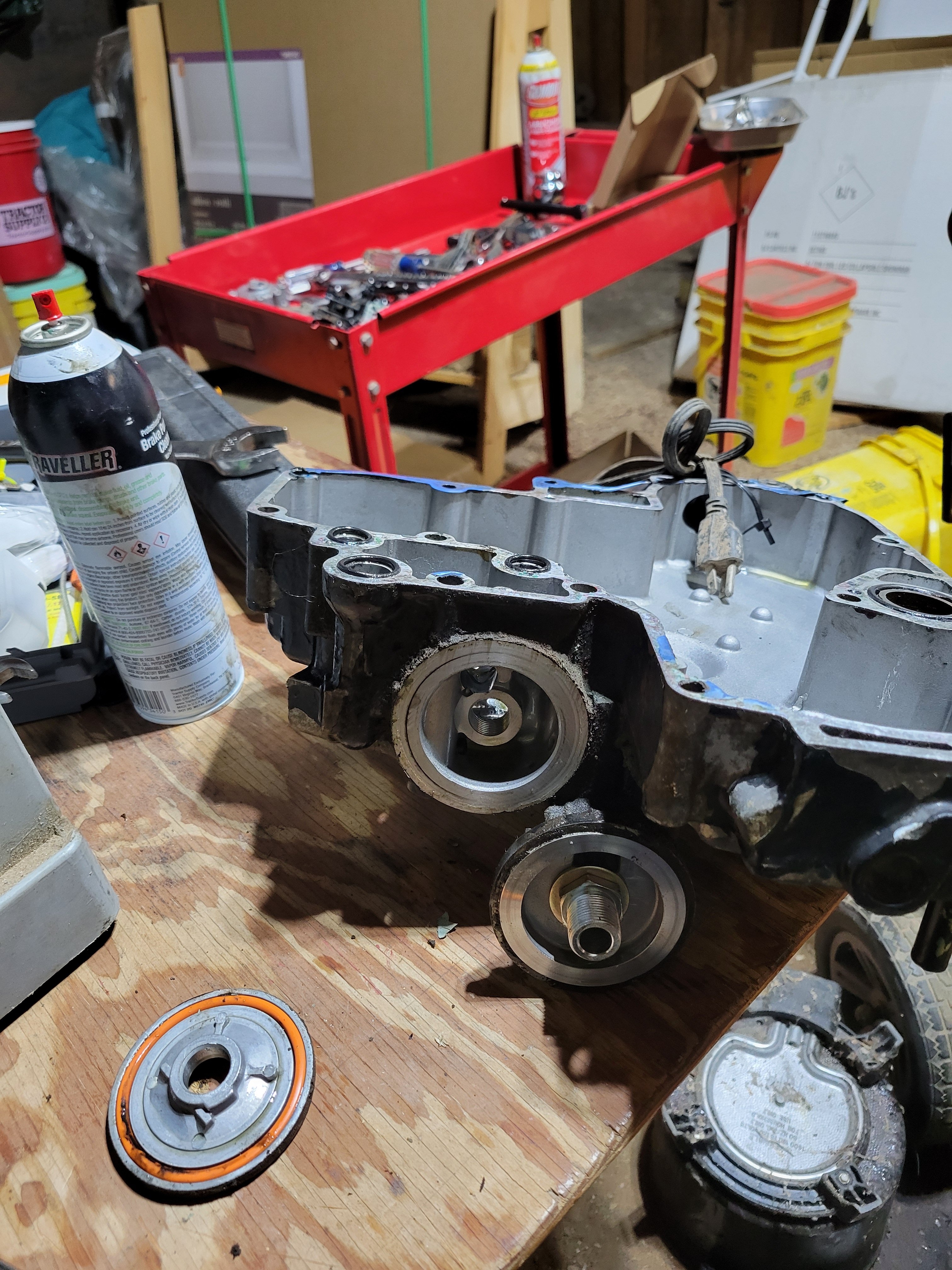

Can anyone help me locate the oil pressure regulator spring and ball? The service manual I have is not clear exactly where it is located, but says to service it. One parts diagram appears like it is behind filter housing but want to verify before I remove it. I have searched the net and cant find anything.

Your engine is similar to my daedong 4a200 in my mahindra. Did you find anything? I am going to take the filter housing off in the next couple days to try to find mine. I have started a separate thread for mine
   / CK30 Oil pressure regulator #3
I wouldn't touch it. No need to service it, you're just asking for problems, just regularly change your oil and filter, and you will be all set.
   / CK30 Oil pressure regulator #4
Its probably just behind the oil filter under a cover held on with a single bolt. You will likely need to pull the whole gearcase cover to check/change it.
