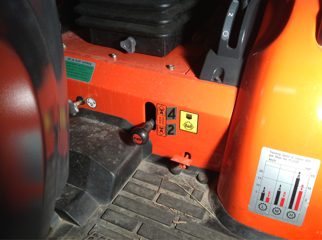

IT seems that half the dash lights on new CK35HST do not work. I have noticed that the 4wd and pto lights do not come on but they have spots on the dash. I looked at the pto and 4wd levers and linkages and did not see any switches or wires that I expect to see. Anyone with a newer CK35 have working 4wd and pto indicator lamps? The dash seems to be working fine other wise, the glow plug light comes on when you turn it on and the parking break light also works. The dash looks to be used across many models and was wondering if Kioti just dose not use the lights on some tractors or if I should be asking my dealer to be fixing it.

They are not supposed to-mine did/does the same---Kioti uses a generic dash thru multiple model lines.
There is nothing wrong a quick call to the dealer will confirm.

I agree. When I checked for switches etc. and found none, I assumed that the dash was used for other models, perhaps with electric engage / disengage that would need an indicator light??
A light for the 4wd engage would be handy. The diagram next to the lever is pretty hard to read (and is the opposite of the diagram in the manual - but that's another story!)

My ck35 hst dash lights up exactly as yours does Eman. Dealer told me that dash is used in several models and that some lights are not used in my model. When I told him that I think he installed the 4wd sticker upside down, he told me that the service manual is wrong. He was right.
I cant remember wether 4wd is up or down, and have a difficult time reading that 4wd icon so I made my own indicator using a couple mailbox numbers.
Great idea with the numbers:thumbsup: Sometimes the simple obvious answer is not so obvious until someone else shows you!! :laughing:
