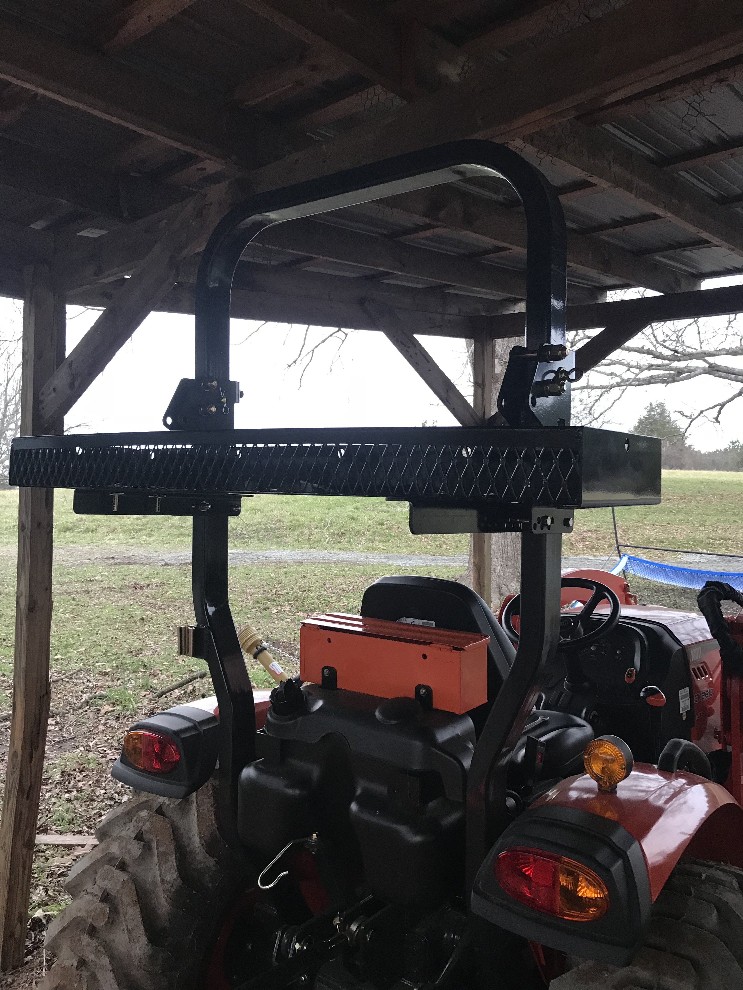

I wasn't at all impressed with that plastic box offering. I ended up finding online somewhere with this little metal tractor tool box. It actually bolted right up to existing holes in both box and on tractor. Wrong Orange... but still good enough functionally for my needs.
Let me know what you find out.

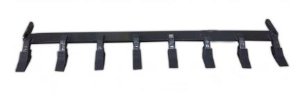

The 'tooth bar' you refer too, is that the same or similar to a 'ratchet rake'?

Toothbar pic attached. Had one on my previous tractor and I liked it. Ratchet rake looks nice too. I'll have to read up on that! Thoughts on it on the rake?
