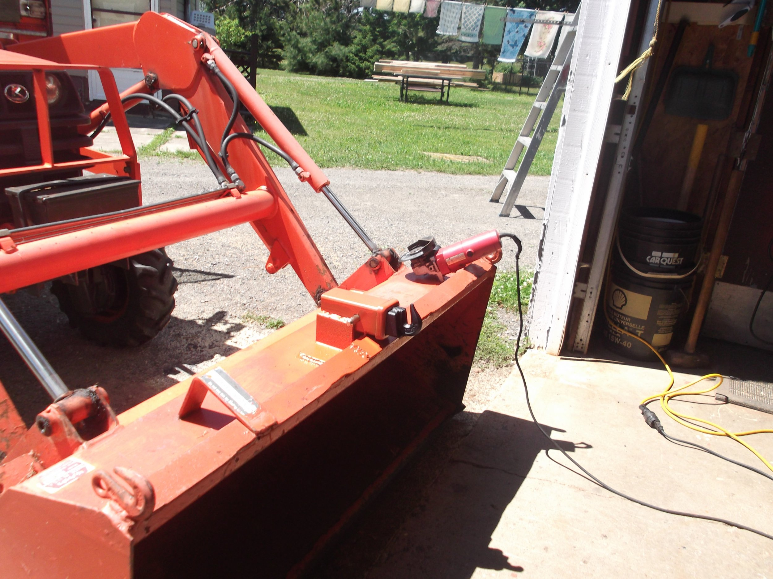

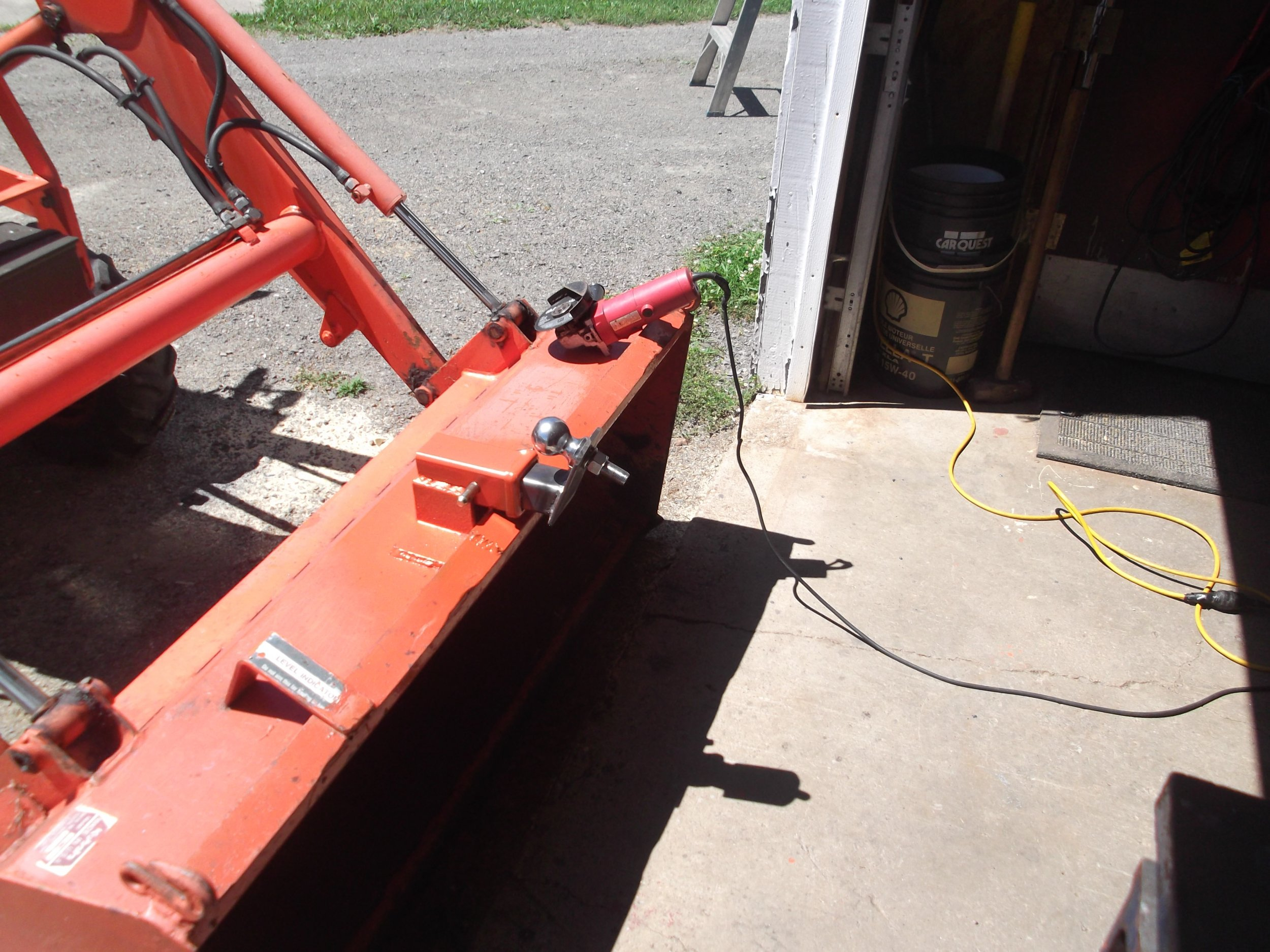

I welded a ball mount receiver on the reinforced top of the bucket and then made a special ball mount to handle a trailer with the bucket tipped forward. I also welded a grab hook to a 2x2 tube to fit the same receiver. Most of the time the hook lives in the receiver, but I can swap in the ball mount to move a trailer when needed. I also made up another receiver tube fastened to the grill guard to store the ball or hook mount not being used (no picture of that).

I would be more in favor of bolt on as in post #2.... Or as some others state 3PH style receiver on rear...
   / Clamp on hitch receiver, whatam I missing? #15
Root Cause, that's a great solution: cheap, simple, and uses the hardware he's already got. And he doesn't have to remove his backhoe.
