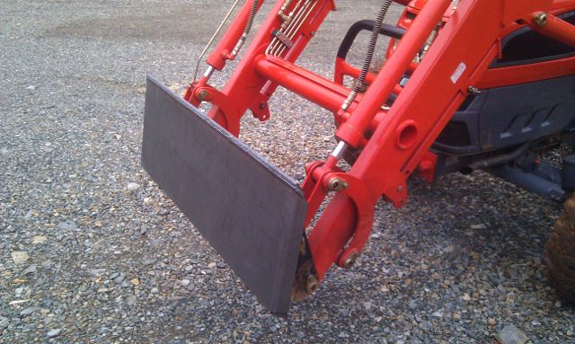

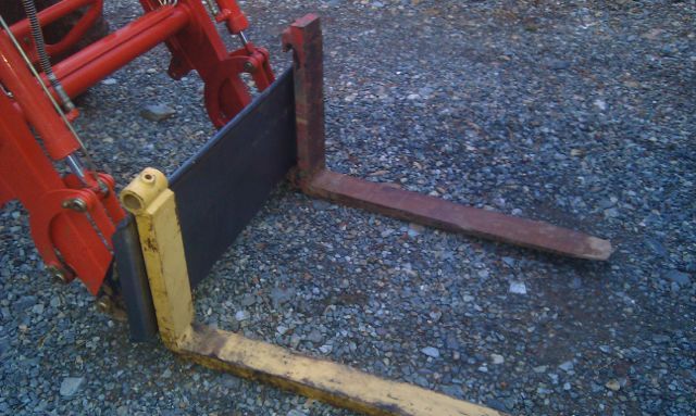

SSQA is the only way to go. Can you weld, OP/Smithy? I bought a generic SSQA plate for $120 then welded on some surpluss forks a friend got at an auction. Heck, if you weren't on the other side of the country I'd sell you the second set of forks I have just laying around real cheap. You could make something similar. I use it for *everything* - lumber, pavers, construction platform. My DK44 can lift a whole pallet of concrete pavers - no worries about a pallet of wood.

Here's some pics of what I was referring to. It's an easy way to make your own pallet forks if you have access to some old forks and have a little welding skills (or can get a friend to weld for you, like I did). The SSQA adapter plate was $120, the forks were surplus, the round rod stock and short metal plates were about <$50 from a metal scrapyard. The D-rings have been very helpful in securing loads.
