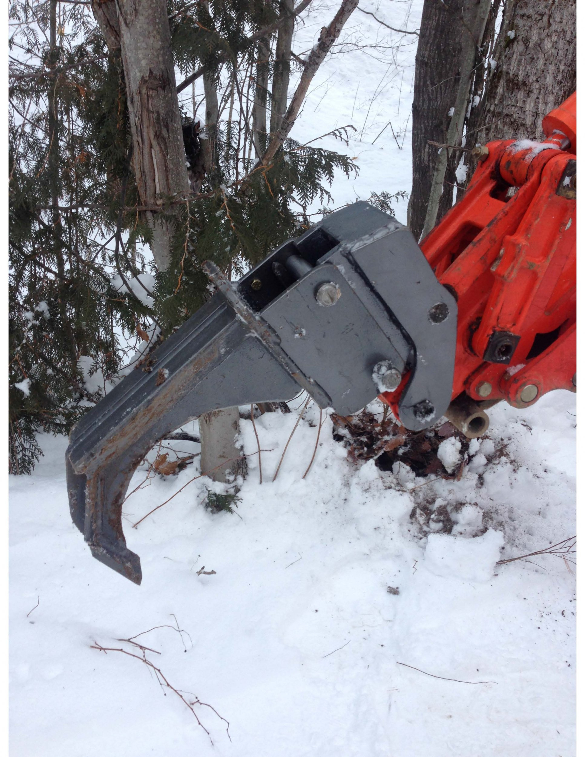

Wow, that is unfortunate. Here is what they sold me for my 2009 Kubota BX25;
