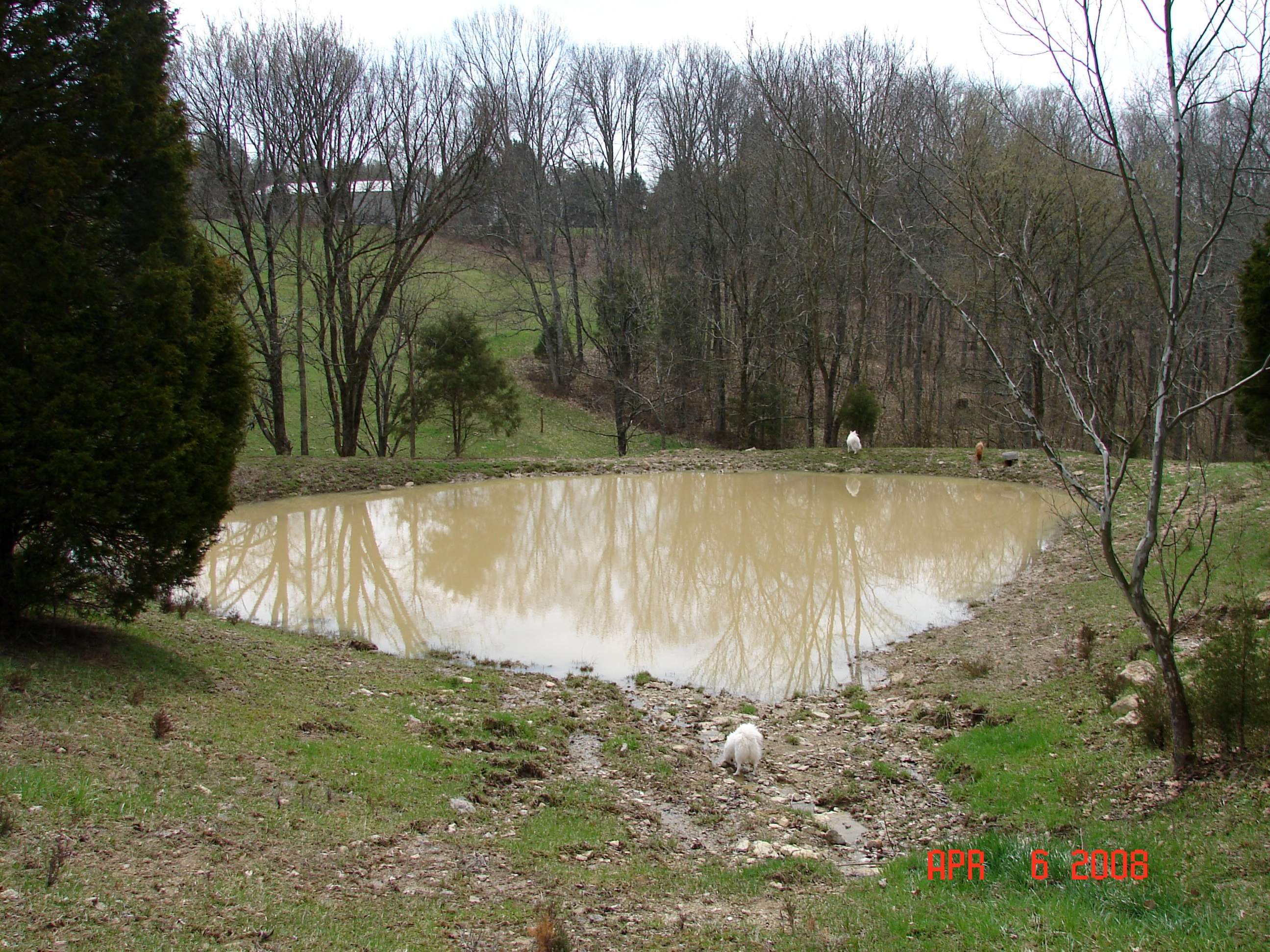

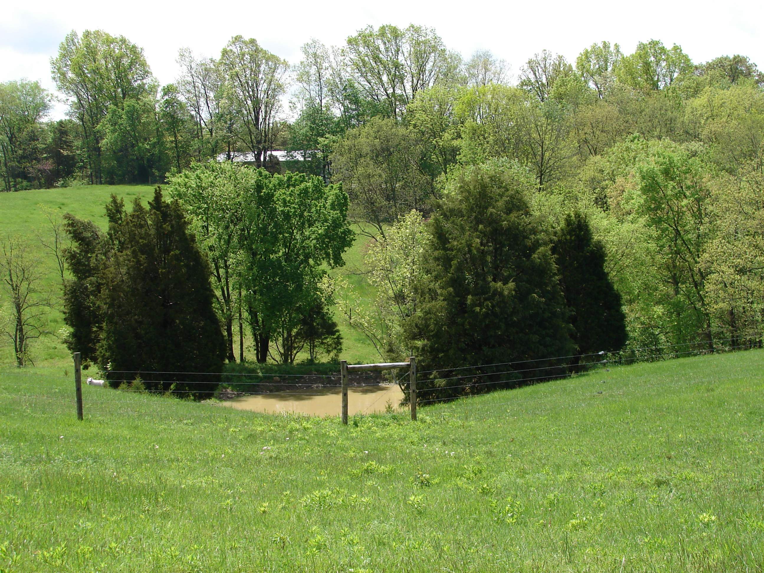

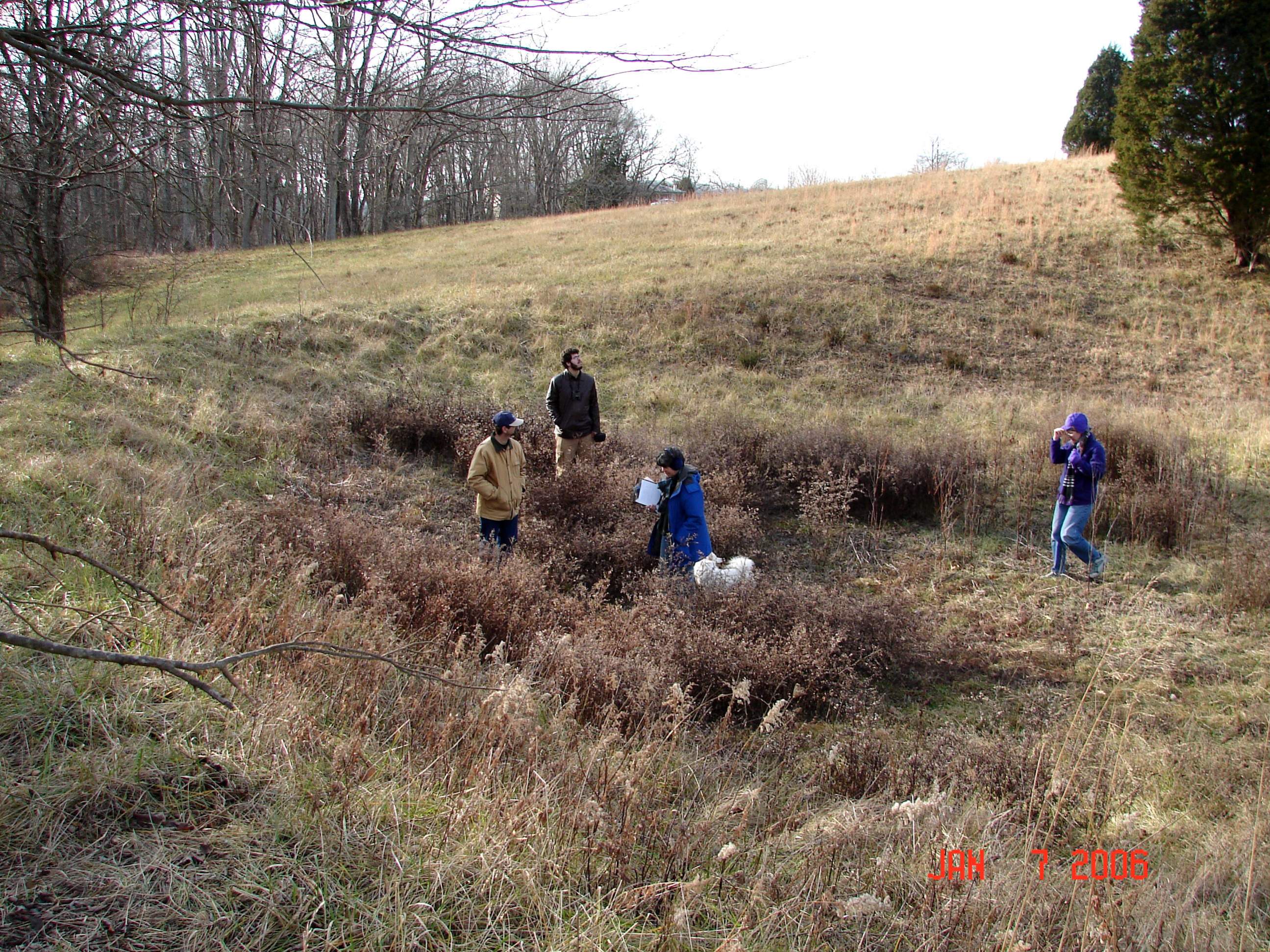

Pictures are worth thousands of words.
People in the bowl for scale.
The pond filled all the way only once in the past three years. (Ofcourse we have had a couple of bad drought years.)

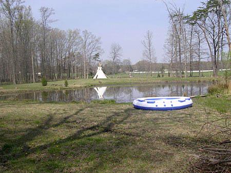

Here are few pics of our pond.
