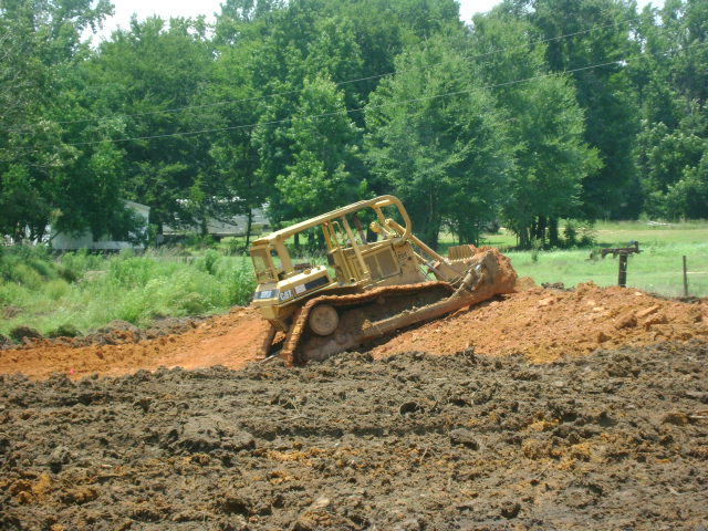

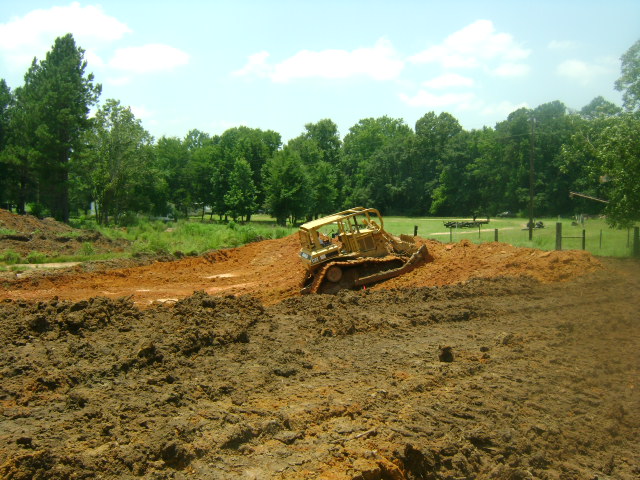

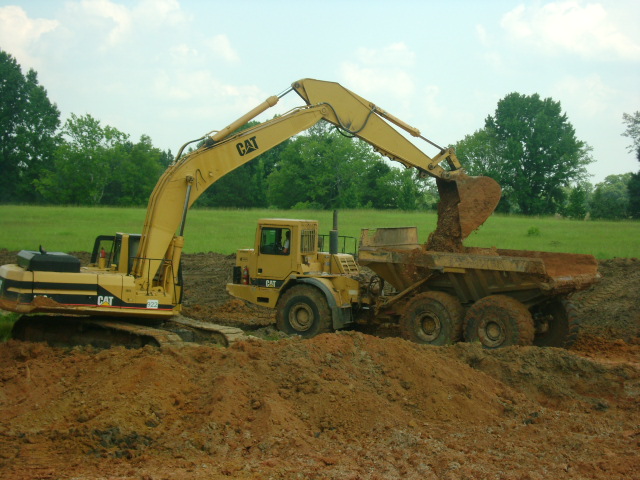

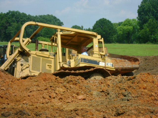

The proper way to core a dam is to dig a minimum of 6 feet below grade and pack with good clay until you build it up to desired height based upon amount of area you want to contain water.

I agree that properly coring the dam is the most important part of building a pond or second only to picking the right location. Remember that a leaking dam may not necessary shown up as a wet spot on the dam. Sometimes a leak will run underneath the dam and it may not surface to several hundred feet below the dam. If it continues to leak, you may want to check the areas below the dam.
Here are a few pictures of my newest pond. Dug in 2010.

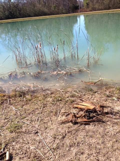

I agree with Paguy all trees should be removed , once they die and rot they cause a natural drain though their root system. Any new trees beginning to grow
on the pond bank as well as cat tails should be removed.
If cat tails are not controlled they will soon take over your pond.
