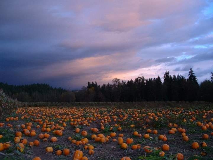

Only 103 Acres here.
I started with contacting someone to pay for marketable timber. Deal was 60/40 giving me the 60%.
I used those funds to rent a 650 Dozer to knock down trees I didn't want. With the dozer I could also pop the stumps out like wine corks with the blade (right side corner tip).
Next I rented a large Excavator to pick up all the trees in one pile to sell firewood, and stumps in another pile for burning.
I put up a post that was free YOU CUT firewood and I got to keep half of the cut firewood.

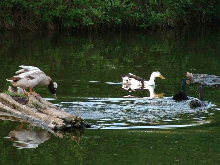

I also used the excavator to dig a great pond.
It took me about a month give or take, (working full time) but the initial timber sales more than paid for the rentals.
Final step was using my tractor with a rock rake and 6 way blade to smooth it all out pretty.
I suggest you plant Clover or something in order to stop weeds from growing back which happens *very* quickly.
Then field mow twice a month to keep it weed and tree free.
This was 20+ years ago and since then I've fenced it all, planted an fruit and nut orchard, a three acre vegetable garden (all goes to local food banks and zoo's, and planted ornamental trees and perennial shrubs.
I also planted 20 apple trees and raspberries at the very back for the bears, deer, whatever else gets hungry.
The wildlife love it here and have never attacked *any* of my animals!
I hope any of these tips help you and CONGRATULATIONS on your new property! 🤠
