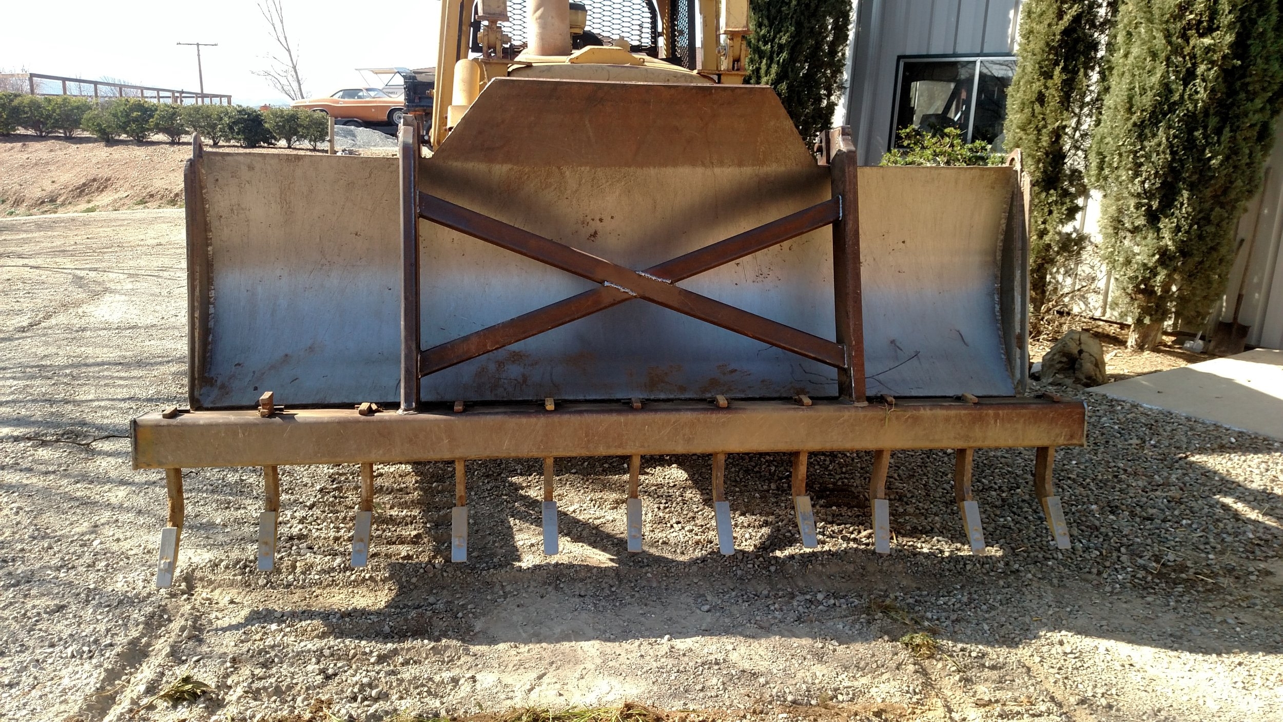

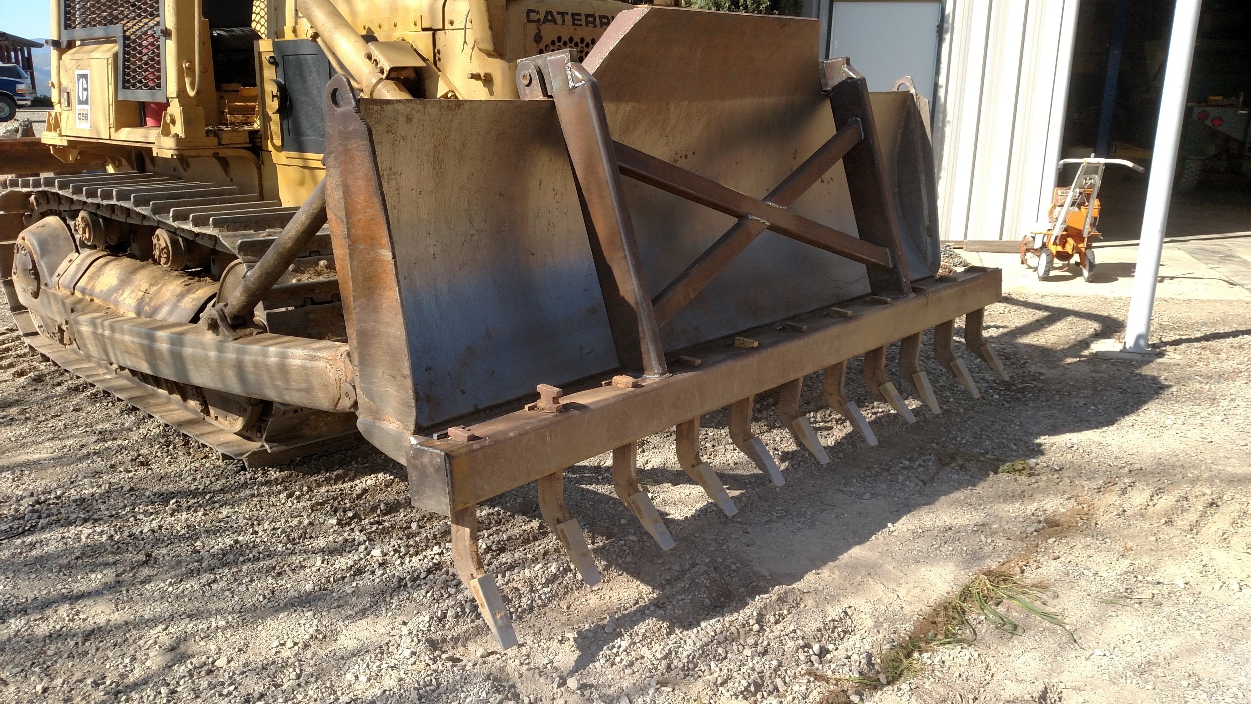

Being on topic, I would get the largest dozer you can afford and a root rake. Others have said to hire it out. Both replies are good advice. We use this one mainly for brush clearing.
