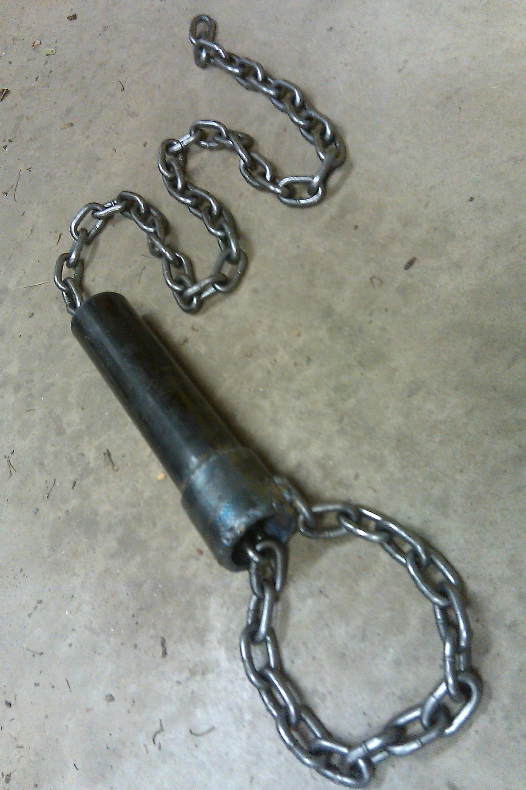

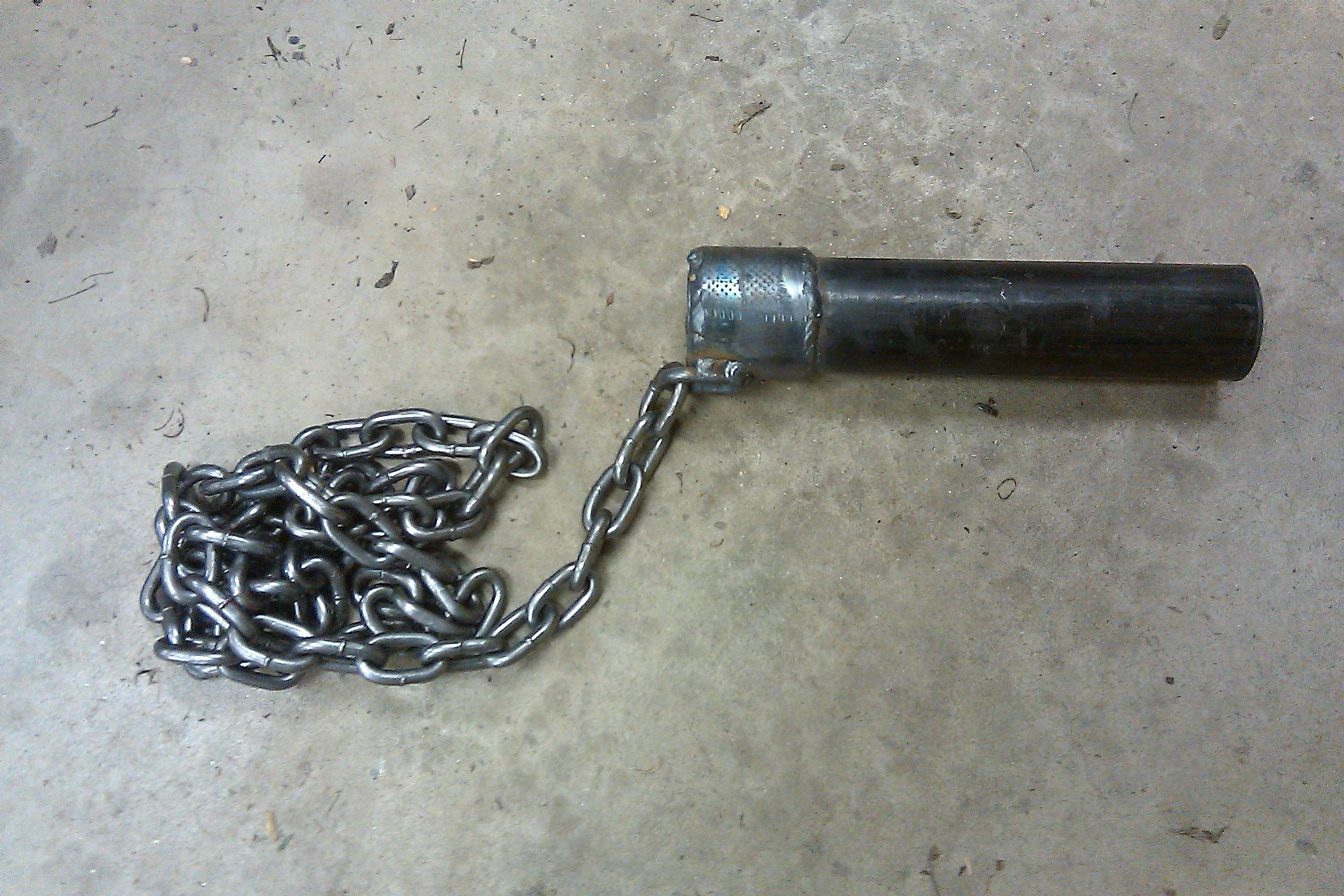

May be a bit too much work for what you are looking to do, but here is a tree puller I built. It's basically a choker that gets wrapped around the tree. It works perfect. I made mine a bit larger to handle brush and clumps of trees.
It's just a piece of 2" SC40 pipe and some 5/16" chain. I added a reinforced plate wrapped around the end.
I usually choke down low on the tree and lift with either the bucket or 3-pt. Takes out the tree, roots, and some dirt - but a couple drops and it usually brakes off.

I have seen this before but like how you have crafted this, I will have to copy and keep in my toolbox for those hard to reach ones!
