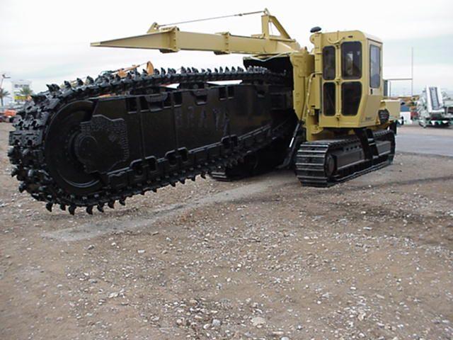

This is what I would use.
/ Clearing brush or blowdowns
the yellow one looks interesting. (laughing), yeah i have a few huskies..but i was looking for something I can drive for miles on end to clear the brush growing in on a road we use for a cabin. If there is something available that is.

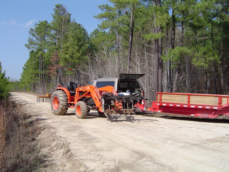

I think a root grapple would work pretty good on them. Your bucket with a tooth bar should also work.
First, push the saplings over, then back up and lower the grapple/bucket into the partially pushed over root ball and push the trees out. A grapple is good since the dirt will fall through, but a bucket will do the job, too.
Here's a pic of my grapple...

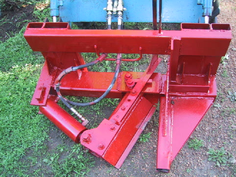

How about something like this.
/ Clearing brush or blowdowns #13
Loader buddy looks good. Pallet forks might also be used to pop the trees out, but would be slow going.
/ Clearing brush or blowdowns #14
The first two are probably overkill for the small saplings and would probably leave sharp stubs. The third and fourth may work well but he is going to have a large brush pile to dispose of. That's the advantage of a rotary mower or a mulcher, they chop up what they cut.
