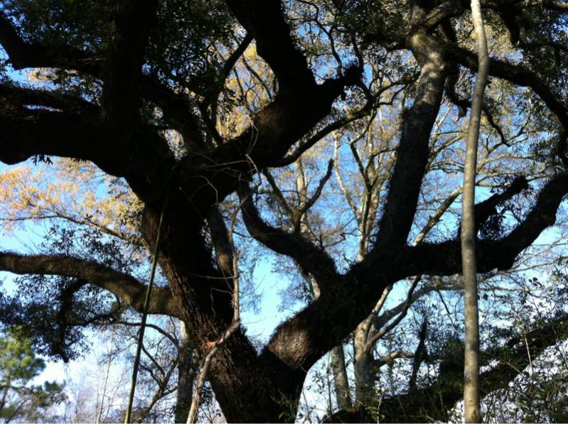

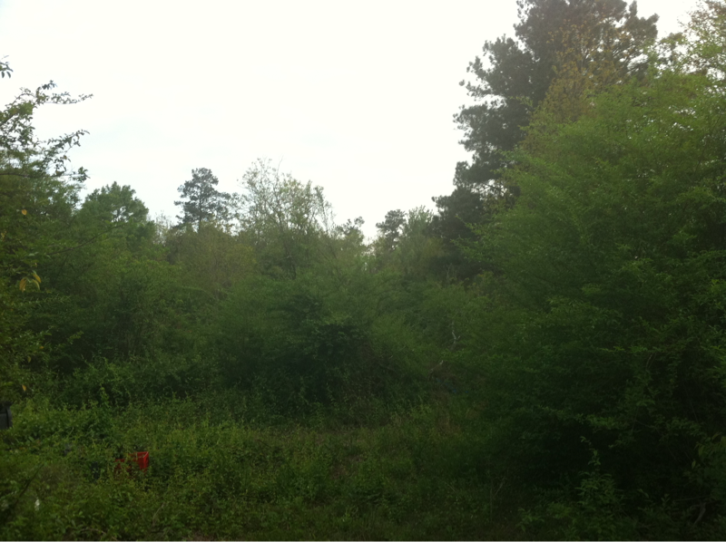

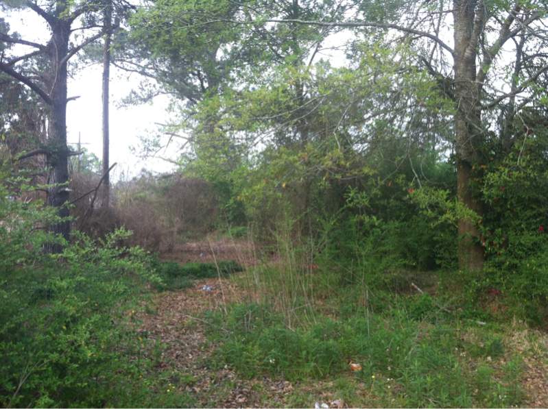

So here are a couple pics, once again I'm just going after the small trees and under brush. Anything the tractor with the bicket or grapple/root rake can't budge will stay. It's an old horse farm, I'm not making it a horse farm so all horse concerns are appreciated but I'm not going that route. I've found a Kubota L5240 HST 4x4 (2008 - 400 hours) with quick detach loader that I'm really leaning towards right now.

Easy pickens, that'll be fun.
Do you know how to up root samplings and bushes? You can do it with the bucket pretty easy, but you'll need a tooth bar to drag them out. Sometimes I use a chain.

I responded on your other thread and stick with my original assessment of very doable. I don't understand why some are getting so testy about all this.

I'd agree with TripleR. From what I see in the pictures, and what you describe as your objective...seems very doable without bringing in a dozer. If you want it done fast, then I guess you can bring in heavy equipment. But it's not like it should take weeks even with your equipment. And if you do bring in a dozer, there's a good chance of losing any trees you want to keep if the soil becomes too disturbed and compacted.
I wish I had some pictures of the poplar stands I ran down with my BX and rotary cutter. Lots of 1 1/2 to 2 1/2 inch tress, with the occasional 3 incher. Not something I'd expect to be able to do several times a year and year after year. But now that it's cut back, I can keep it in better shape.
Go slowly, because you never know where fallen logs are going to be in that stuff. When you find 'em, push them out of the way with your FEL and/or take the chainsaw to them.
