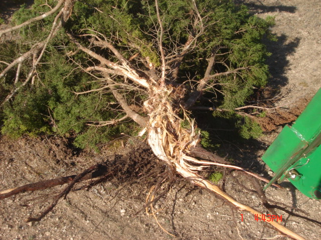

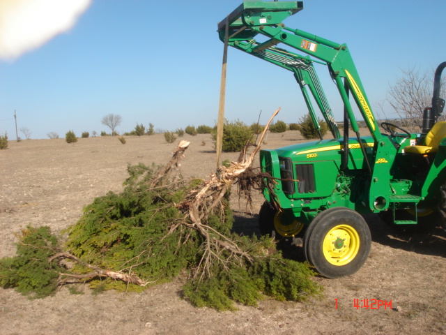

Started clearing my 25ac of cedar brush/trees. I have in the past used my truck and "snatched" them out of the ground with a tow strap. This time around I figured I'd use my tractor. Only down side is when I went to use the tractor a couple of days later I found a flat tire (on the rear of course) so I have to fix that before continuing. Average trunk size is from 3-4 inches up to about 10. The one pictured is one of the largests I've pulled so far.

Those look like they'll come up pretty easy. When I was clearing a little field I had some Hackberrys that were 24-28" dbh. Dug around them with the backhoe, pushed them over and sawed away the logs/limbs. Stumps were rolled to the woodline and holes were backfilled/disked stump holes

There not bad. On the larger ones I have to push against them to break loose some of the roots then I can pull them up. After I get these done and the land disc'd and seeded I'll be doing a cross fence and starting on the other 15 +/- ac. Hopefully withing a year or two I won't be so reliant on buying hay for the winter.

that's a beautiful field!
this gives me even more inspiration to clea off that back field that is all grown up.....

Is that a bale spear up front? It looks homemade if so, and was wondering if you have pics of it? I'm looking to build a complete unit for mine instead of what I made.

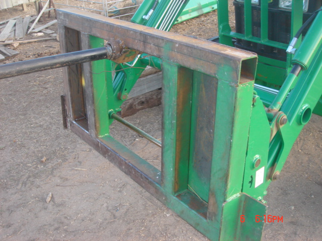

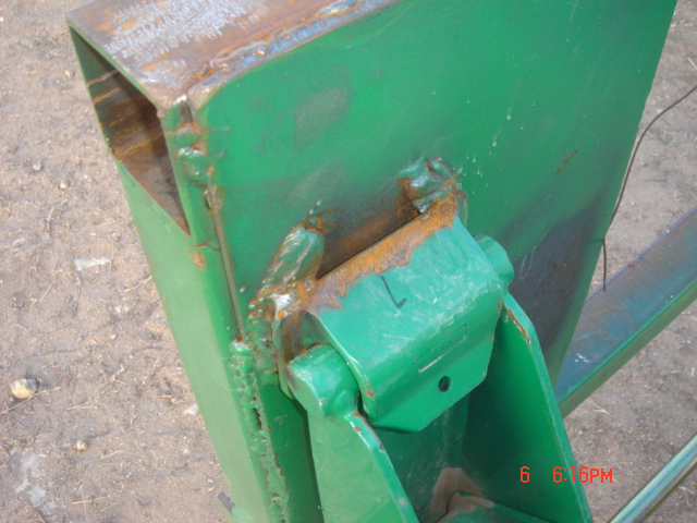

Yep, that's a homemade spear. The spear itself is purchased from Agrisupply but the frame is built in the garage. Used 3x3x3/16 box. I'll post some pictures of the frame as soon as I can get some. So far my JD has done everything I've asked of it.

If you're talking about welding then don't be embarassed. You should see my splatter zones. In building this project a friend of mine did the welding (he was dying to try out his new welder).

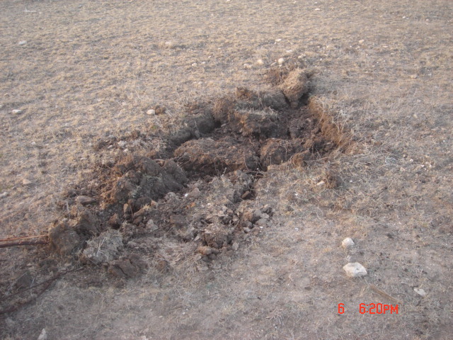

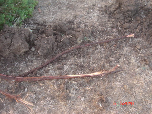

Anyways you requested some more photos so here goes. I've now ran into a couple of trees that I had to basicall break off at the bottom. Most of them don't have deep roots but spread out quite abit. I think the longest that came up without breaking was about 8ft.
Notice in the third picture of the bale spike frame, yes that's a horseshoe. We work at least one into every project we do.
