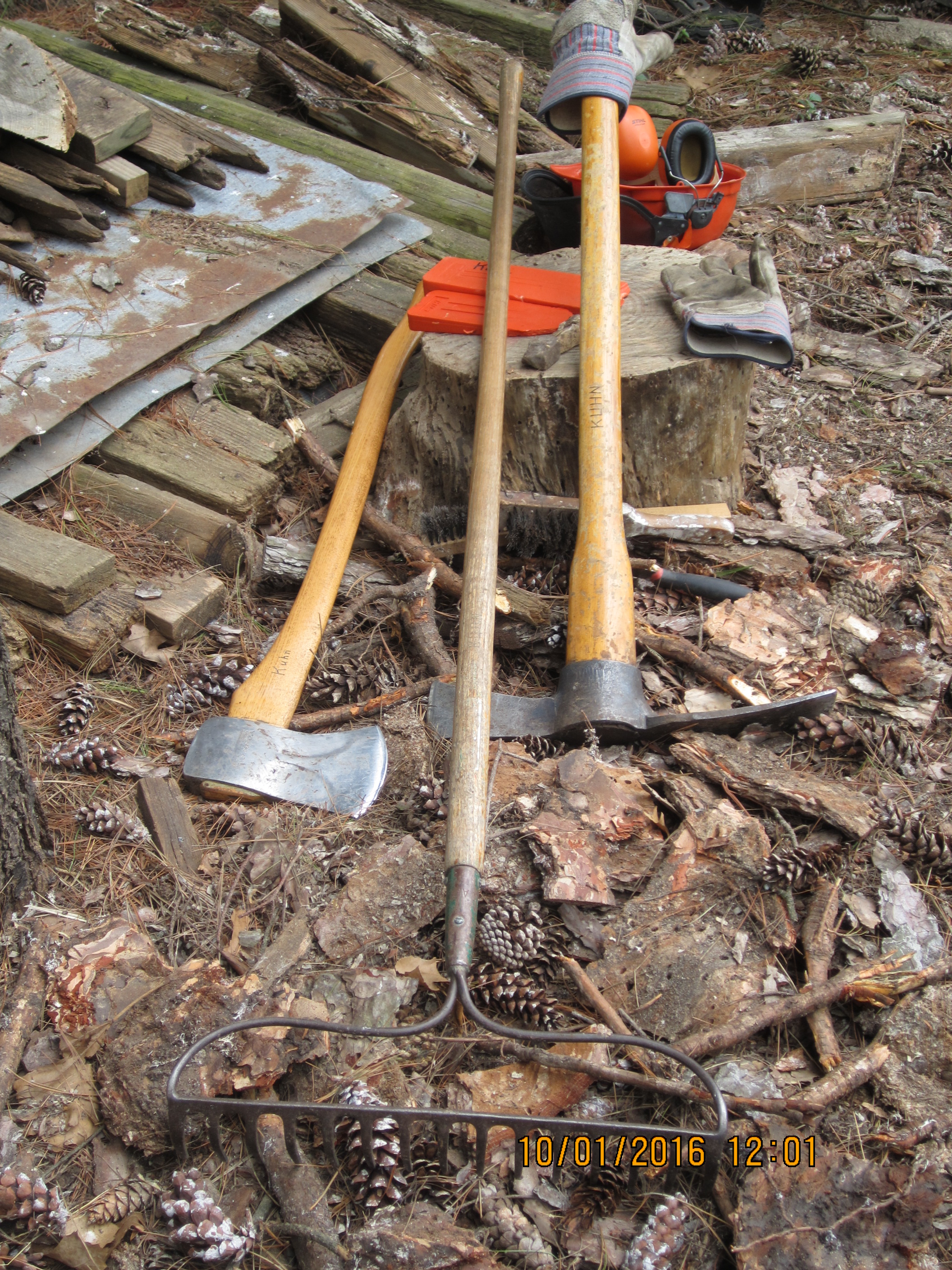

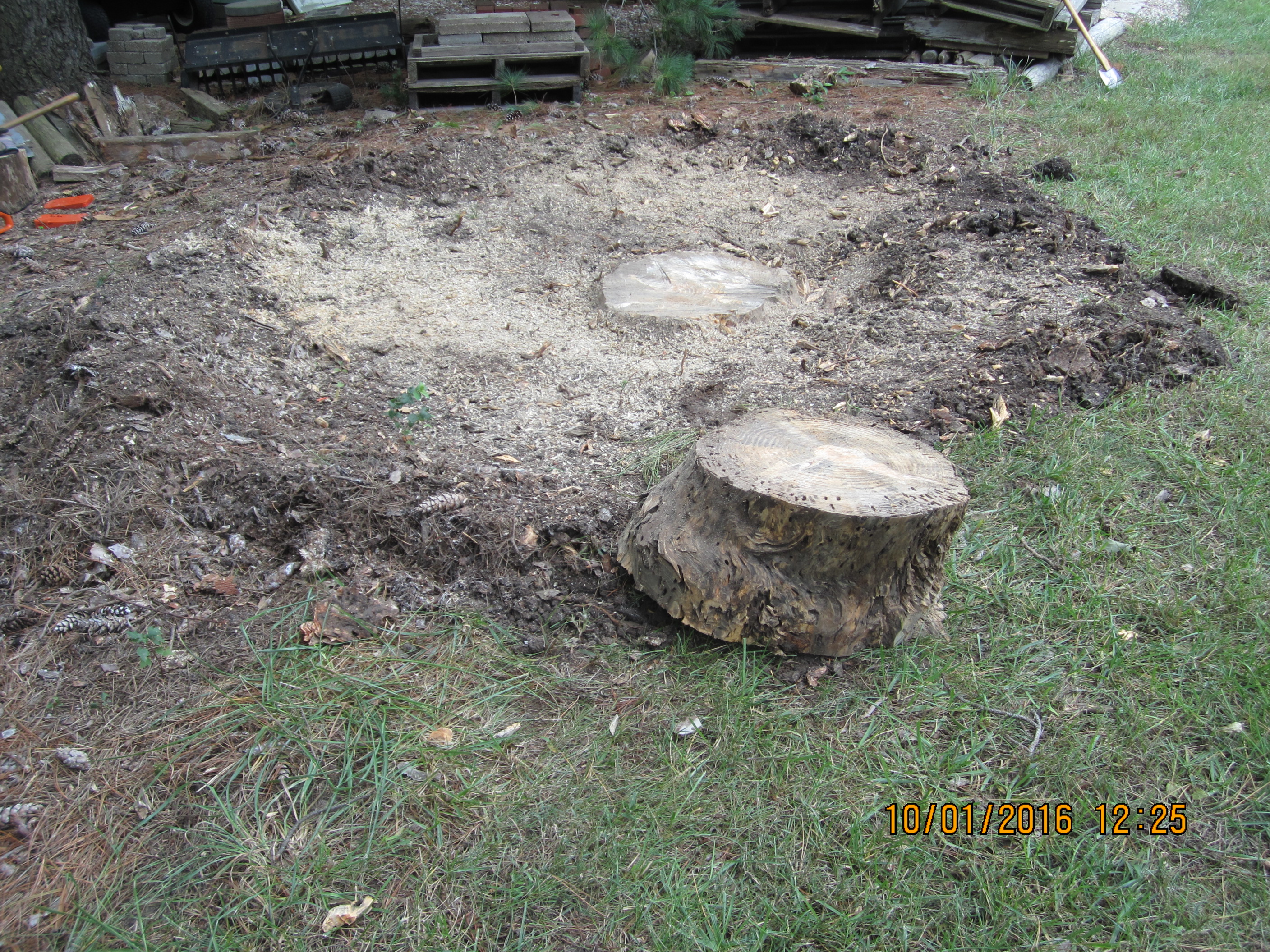

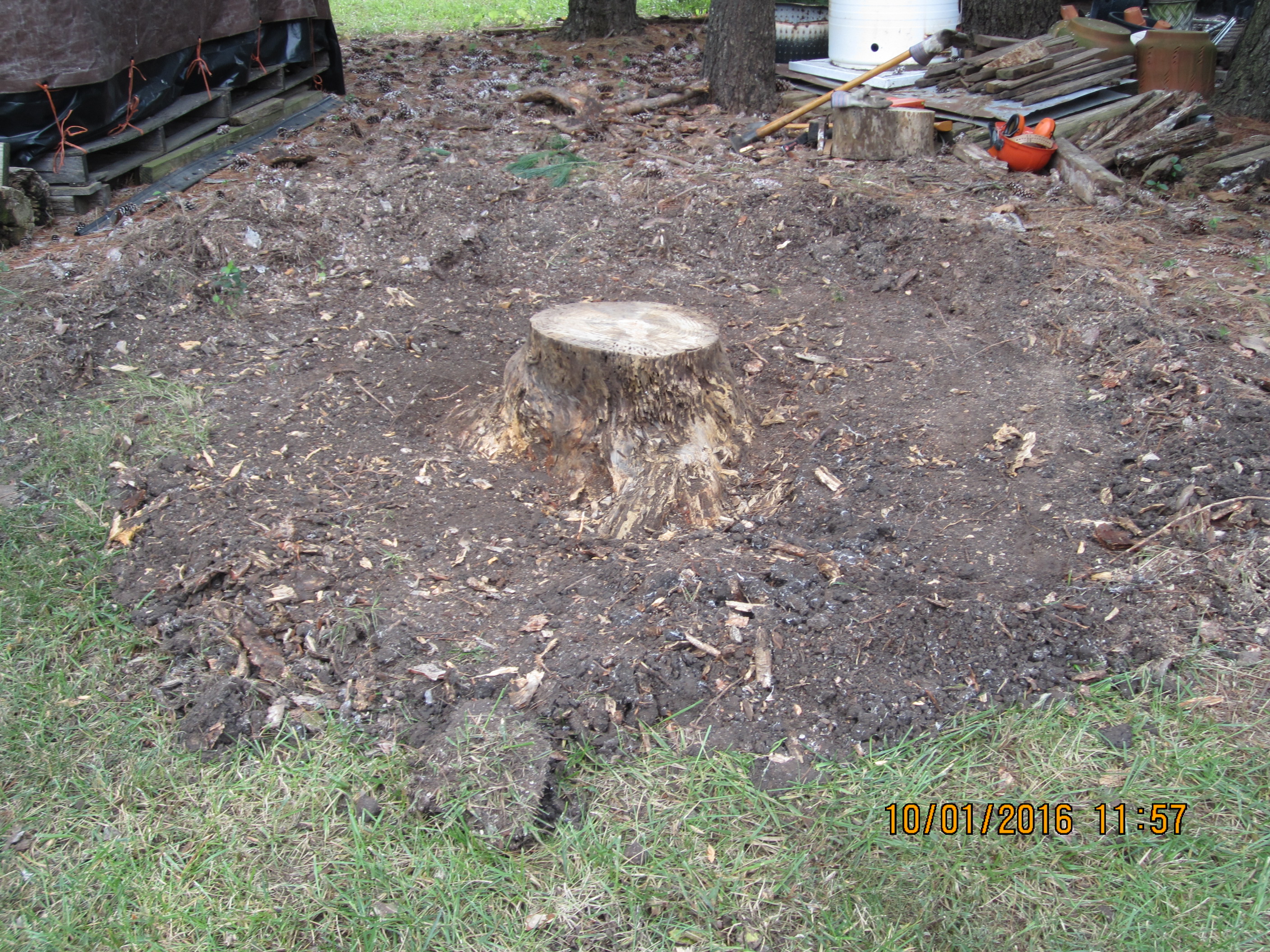

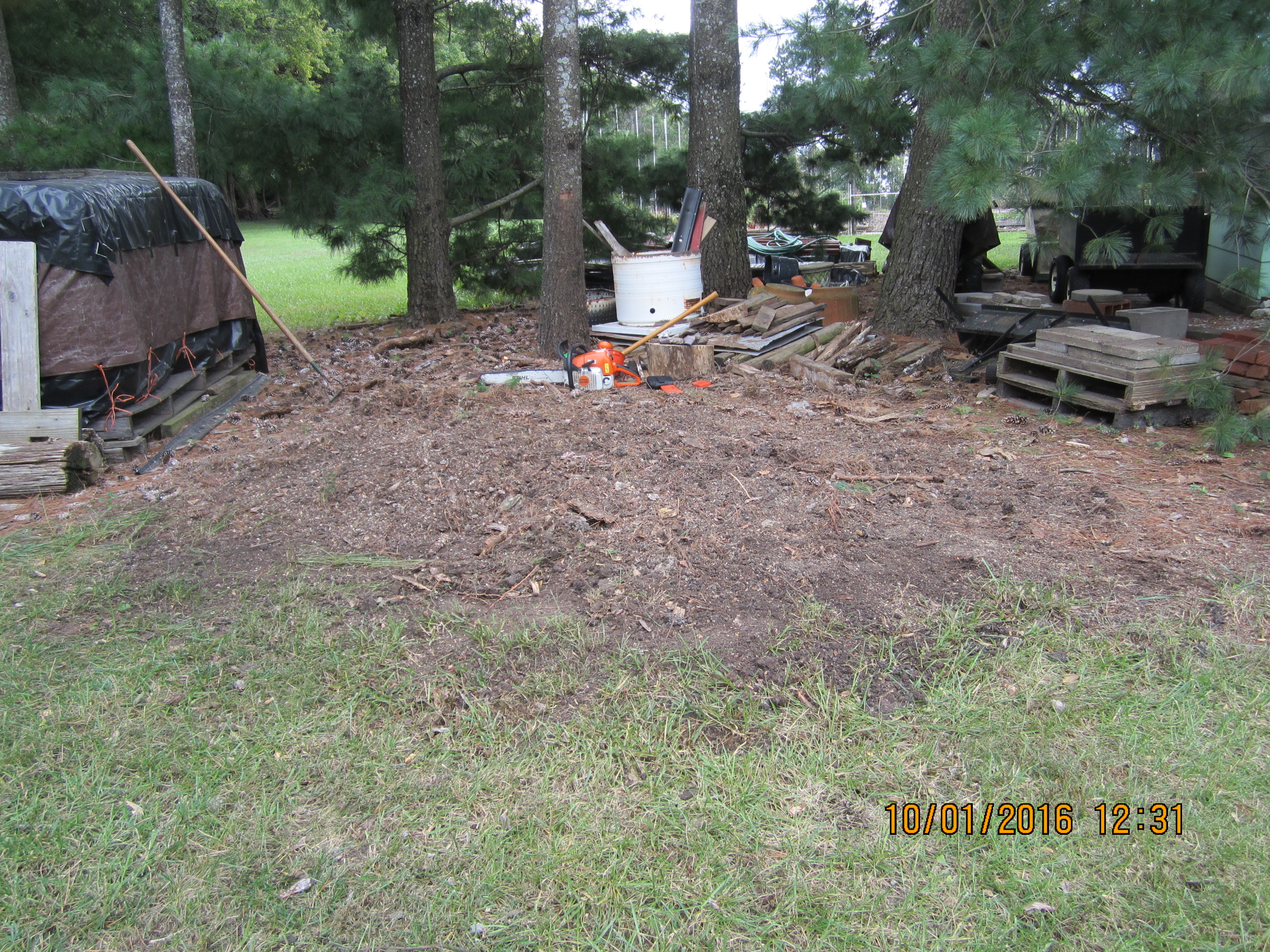

yep this works well. in fact you can use your tractor loader bucket to get a lot of the dirt from around the stump and then just use the shovel to cleanup what it left. It really isn't that hard.
