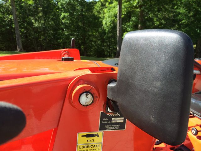

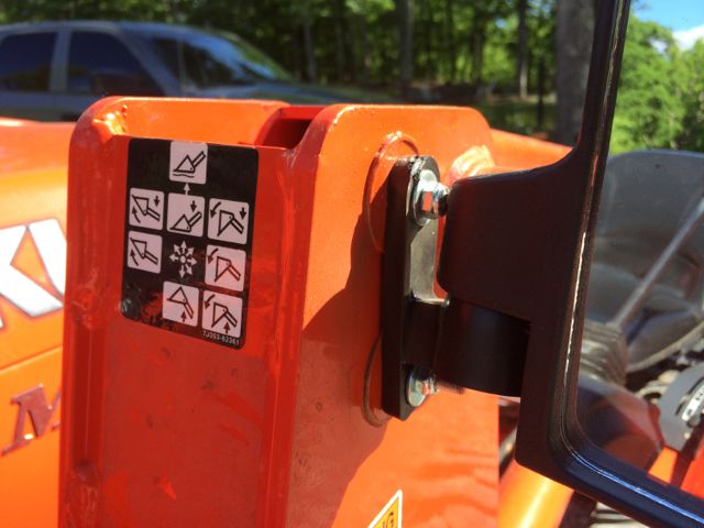

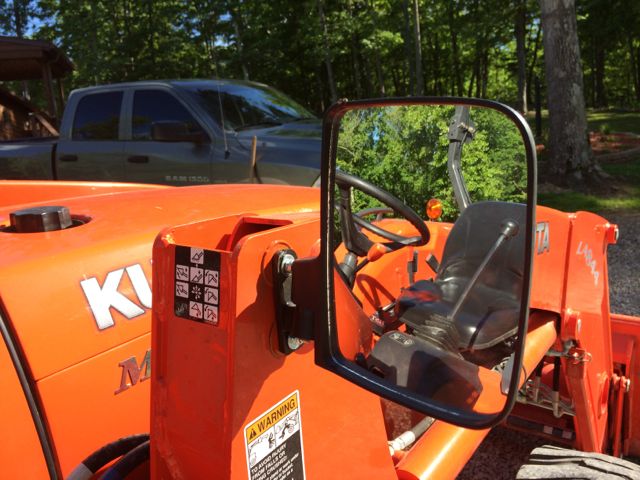

About a month ago I installed some click Bond fasteners and mounted a set of mirrors on my MX5100. Now after a month i can say these are the BEST mounts you could ever ask for or buy. I been brush hogging a bunch and the mirrors often take a limb and get knocked backwards or forwards and it never bothered the fasteners. Most of my brush cutting work is on ATV trails and farm roads so it is some times rather rough and lots of things to catch mirrors on. I personally didn't want to drill holes in the tractor so I went with the Click Bond fasters after reading about them on this site. All I can say is buy some, they are GREAT!
Also want to thank DragonEggs as he was a BIG help and answered any questions I had.

Thanks - The Click Bonds are from Electrical Hub but there is another place called the The Flight Shop Inc. that carries all their products. The Elec. Hub really hit me hard on shipping so I would look around a little bit but the fasteners are worth the effort!
The mirrors were Golf Cart Mirrors off Ebay - Think they were right around $25 dollars. 4Shorts gave me the info and for the price I thought they were pretty nice. I LOVE having them on when I have to run down the road to the other farm, easy to tell if someone is coming up behind me.

Great install, Code54. Did you sand down the surface before installing the click-bonds?
/ Click Bond Mirror mounts
Thank you.
You use something that is like a scotch bright pad that basically just takes off the "gloss" but leaves the paint intact. You can buy a little "kit" that has the epoxy and mixing stuff included for a few dollars. Really a simple install and well worth the money for the mounts instead of drilling in my opinion.

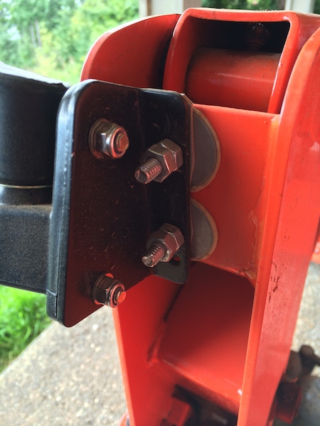

Looking good!!! Glad you like them. I have Click Bond fasteners supporting mirrors, lights, and the wiring on my BX. Of course I am biased but this THE way to mount just about anything to your tractor, ATV, RV, boat, airplane, satellite, ha, ha... I am happy to help anyone with questions you may have.
As Code54 said, it is a light scuff and solvent wipe prior to bonding unless you are going to mount something where you are expecting hundreds or even thousands of pounds of load. In those cases, you need to get down to bare metal.

What size stud did you get for those mirrors?
/ Click Bond Mirror mounts #9
Code54 -
I used CS125 studs. They are 1.25in base diameter with a 1/4-20 by 1in long threaded and I double nutted them. A simple locknut would be a bit cleaner. Probably should cut the protruding stud flush but I got lazy. Obviously you could go shorter but these are most popular size/length and Electrical Hub always has stock of these.

Yep - I ran by our local Fastenal and bought some locknuts and it worked GREAT! The guys at the store were also really interested in that "weird fastener" that I was using and I mentioned they should be selling them!
