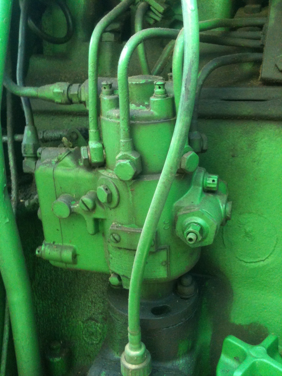

I didn't see the rest of the responses before I went back to my farm yesterday to try and get the tractor running again. I opened the bleeder valve on the top filter and pumped the primer until fuel came out of the bleeder valve. The tractor started right up and ran well for a couple seconds, then died. It did that 4 or 5 times. I then left the bleeder screw backed out a bit and started the tractor and it did the same thing. So, I need to bleed the injector lines?

I said I pumped the primer and then the tractor started and ran well for a couple seconds then died, and "it did that 4 or 5 times." I only pumped the primer one time, before starting it the first time. The other 4 or 5 times, I waited a few seconds after the tractor died, then cranked the engine.
   / clogged fuel lines on 4020 #17
Before loosening inj lines I'd suggest loosening supply line at inj pump and pumping lever on lift pump until air free fuel squirts out and then tighten nut on line.
   / clogged fuel lines on 4020 #18
Worth a shot, but since it's dying, the air is probably in the whole system between the injectors and filters. You may luck out and get enough air out that it will start and keep running till all the air is purged out.
   / clogged fuel lines on 4020 #19
I agree with Tx Jim do the easy stuff first, and the injector pump inlet is a good bet. I should also mention that Jim is a very helpful retired Deere shop foreman and tractor mechanic with lots of Twenty series experience.
   / clogged fuel lines on 4020 #20
There's also another possibility that the fuel return line fitting is plugged with debris. A plugged return line will allow engine to start/die,start/die
