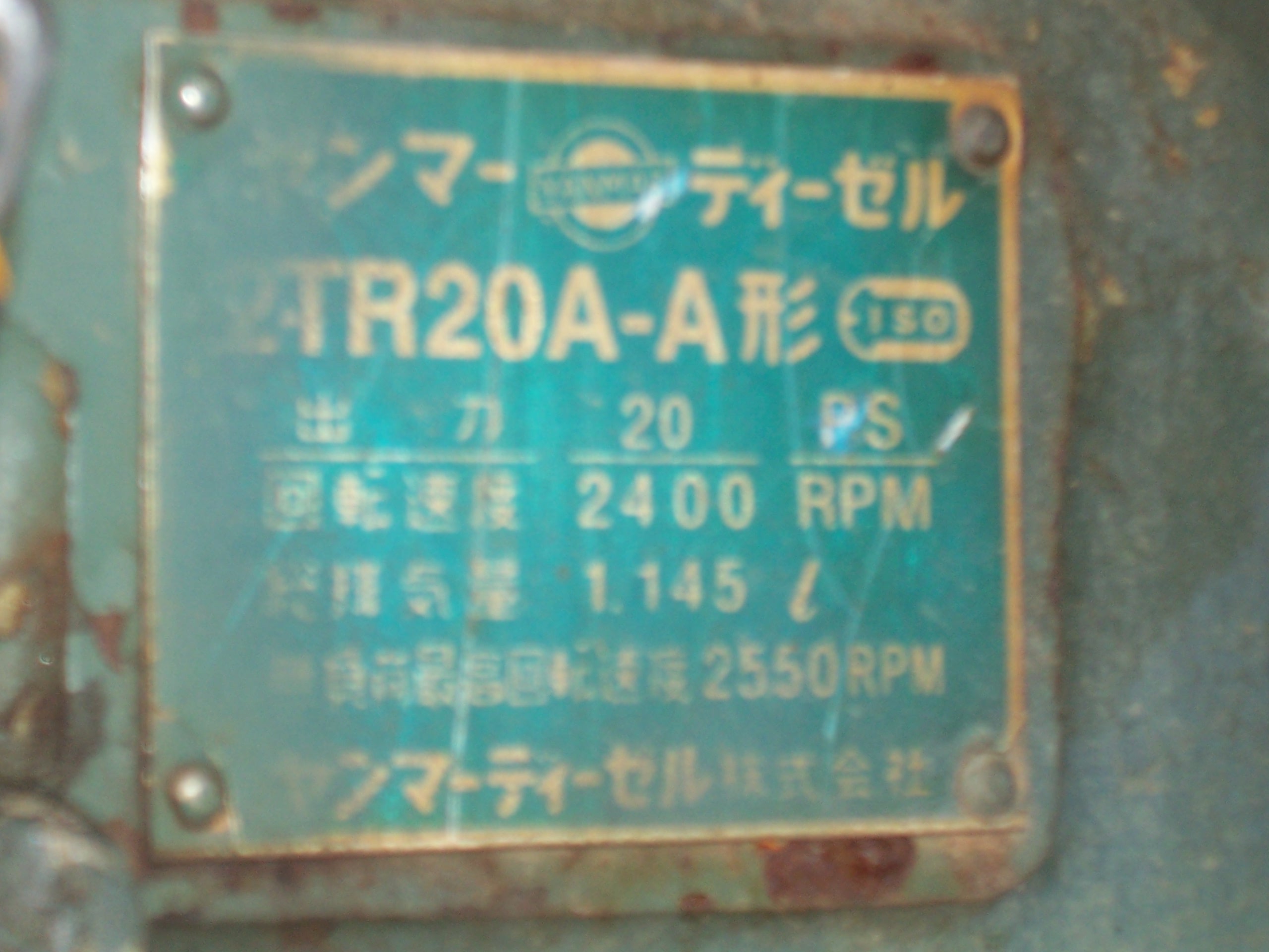

This is on my 2000 And it says 20 then 2400 RPMs. under it. Again :confused3: CL. has a JD 950 doesn't know the Yr. but it's 27 Hp. :D

That means it produces 20hp at 2400 rpm. But again that's at the PTO. So maybe I got the 24s confused? And was thinking of the 2400? Which 2400 is full operating RPM. Yes I admit most of us don't operate all the time at 2400 though.

I know what your saying but look down further. Full operating speed looks to be 2550. Imagine running at that speed.

Yea that's wide open but I guess the power curve max HP is made at 2400?

Ended up finding my manual. On a little zip Drive. YM240 2TR20AX Max Gross HP. 24Hp.@2400 Rpms. so 20 PTO would be correct. At 2550 RPMS I don't think 150rpms is going to make that much difference. I did notice This is for the TR20AX not TR20A-X or -AX
I'm TR20A-A the dash Like I said I've seen 1 other time on the Eng. Decal or Vin# and was like Mine -A. There for a reason?
