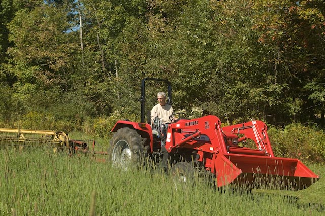

Here's a photo of my 5525 and old NH 467 mower-conditioner mowing second crop hay today.

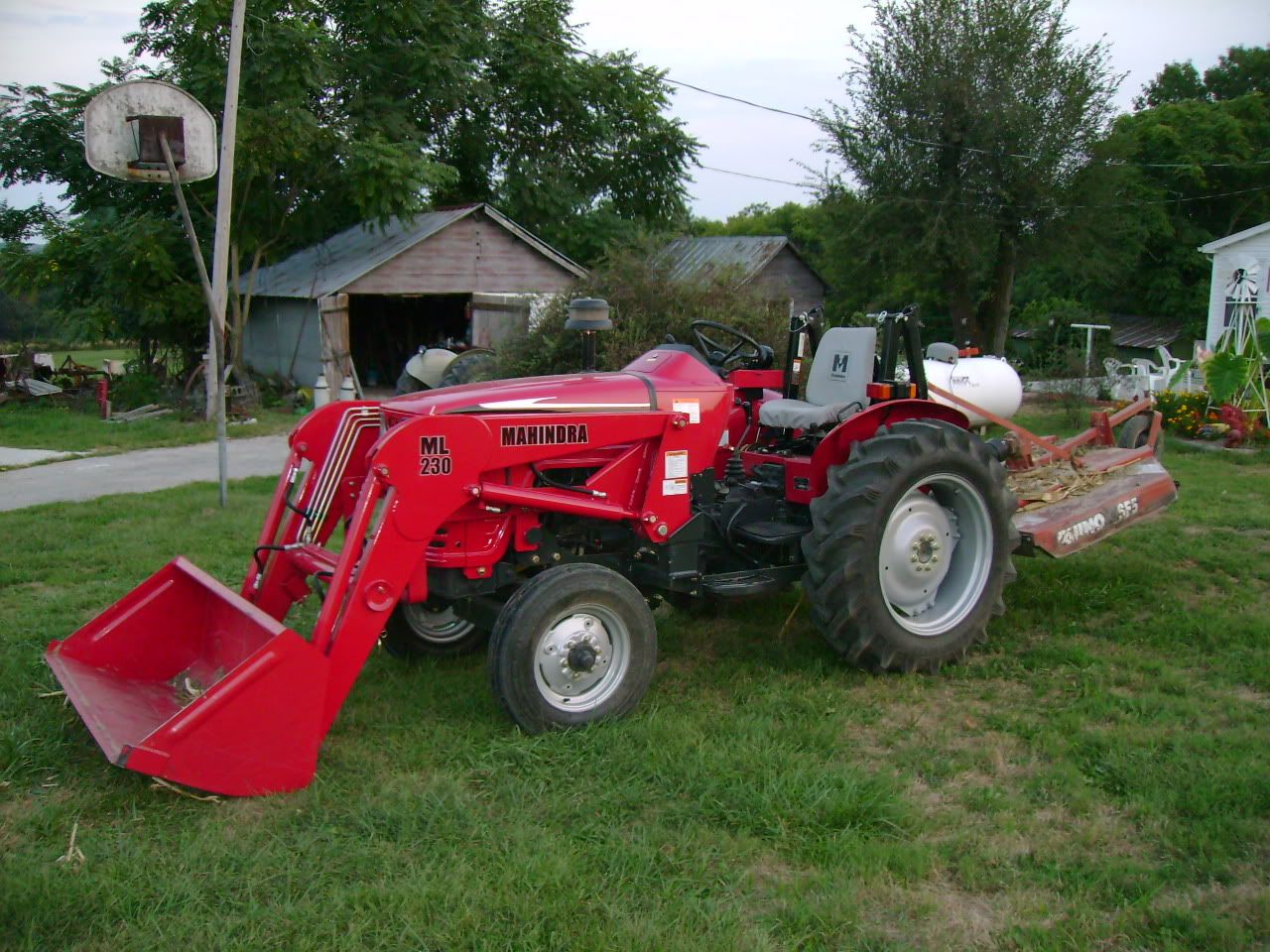

Here's a pic of mine from last Sunday after a few hours of clearing 4 wheeler trails, etc for this year's upcoming deer season...29 hours on the clock now. I took the air hose to the tractor and blew off all the dust, otherwise it would have looked a lot like the 'hog:D It wasn't too dusty until I got out into the cornfield to make a trail (shred the stalks so they won't puncture the ATV tires). IT'S DRY... WE NEED SOME RAIN!!
The 'hog and the FEL make a deadly combination for all the briars, bramples, multiflora roses and other nasty stuff that grows up back in the woods throughout the year. Now I can put it in reverse and back the 'hog over the stuff first... couldn't do that with the 8N.
