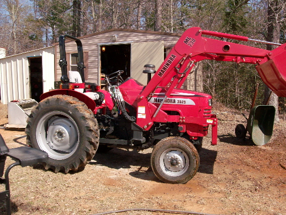

Just noticed something... where are the stands for your FEL? Normally they're stored in the torque tube between the loader arms... but I noticed that yours is empty.
Also, did you get the big red wrench?
   / CLUB "25" #62
The weight box is a storage box off of one of my old semi trucks. I have about 800lbs. of concrete in it. The loader stands are on pins under the arms. It looks like all you have to do is pull a pin out and they will swing down. and yes i got the big red wrench it is in the shed. didn't want to loose it when working in the brush.

Going to post the only other picture i have of loader right now Will get another picture when i can and show the stands. I went and looked at your picture and i see what ur talking about. My loader was made by buhler so that could be the difference
Midsouth,
I can see your stands in that picture... My loader is a Buhler also. Different method of storing them.
Is your tractor/loader a 2007/08 model, or is it an earlier year?
   / CLUB "25" #70
Morning Brian both tractor and loader are 08 models. Hoping to get some more done on the yard today while the dw and i are waiting on dispatch. We team drive for a small company here in MS with runs to the west coast and back. That lets us get home every week for a day or two. I'm going to wait till we get home next week to try out my weight box i want to make sure the concrete is set up good. I have braces in side that the lift hooks to so when i pick it up i'm picking up with the concrete not the box.
