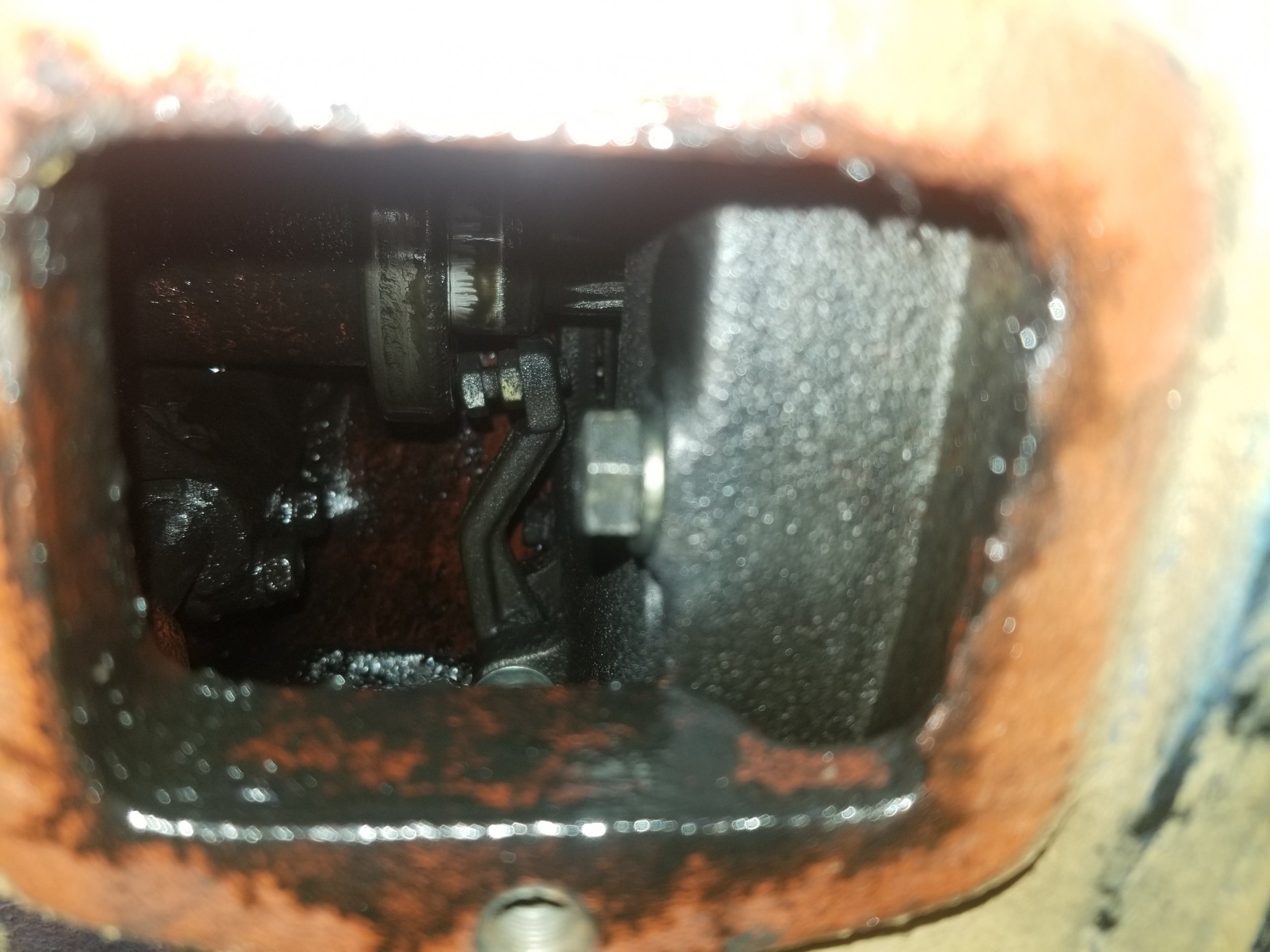

I have an LK3054. I have the field service manual which was posted here. It however is for the LK30. Most everything seems similar in it compared to the tractor although I have found some differences. Without knowing the history of changes/packages/whatever that kioti has done I don't want to make a change without verifying on here.
ISSUE.
When using the post auger, depressing the clutch to any position doesn't disengage PTO. Unless throttle is in lowest setting PTO grinds slightly when engaged.
Looked in FSM and found clutch peddle and plate adjustment procedures. Although the black and white picture doesn't entirely match what I see.
Side note, there is engine oil in the clutch area? Bad rear seal? Or kinda normal? Tractor has 740hrs but experienced a stuck thermostat and fried head gasket before I bought it and fixed the head.
If the small bolt and lock nut inside is what I'm supposed to adjust, which way? Has anyone else done this?

did you get tis resolved? When i have the PTO engaged on my LK3054 it won't stop turning either when i push the clutch in. I'm pretty sure it is supposed to stop turning and it has something to do with the clutch adjustment Radiation provided in his post. I would think somebody has done this procedure.

Did you have an implement attached when you say that the pto doesn’t stop turning? Also how long has it been since you actually used/operated any thing on the pto? Sometimes the clutch plates are stuck together from sitting…

I took the two inspection plates off the right side (when seated behind the wheel) my tractor last night to see how difficult this adjustment is. One of the plates is probably 3x3. The second plate was a few inches forward of the 1st plate and only creates an opening of 1.5". I could get a wrench in the larger opening and spun the pressure plate with a pry bar. Based on the manual, I could see the clutch adjustment bolt head/screw, but the locking nut is not accessible through the second and smaller inspection hole. Is there another inspection plate i need to remove to make this clutch adjustment? Based on what i was looking at last night, the clearance between the traveling pressure plate and the bottom of the bolt head was 1/8 or .25". The manual indicates the gap should be no more than .039 in.

Based on the above info, clutch adjustment looks like a good place to start…
/ Clutch adjustment #11
Thanks robin. can you tell me how to get to the locking nut on the adjustment bolt? I can see the bolt head that needs to be screwed in, but i need to get to the locking nut the manual describes and there is no access to the locking nut.
/ Clutch adjustment #12
I’m not familiar with your specific model, but is there an opening on the underside of the tractor? Sometimes there’s an opening in the bell housing for water/debris drainage or servicing…
/ Clutch adjustment #13
ok. I'll check for an additional or larger inspection plate.
/ Clutch adjustment #14
another contributor to my question advised there was no way to adjust the clutch without splitting the tractor. He advised you could only adjust the PTO clutch through the inspection plates.
