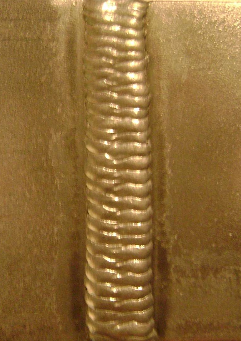

I have one machine set up with dual shield flux core and straight co2 and that welds like a dream, may want to look into that set up, think you would be happy with it, I wouldnt steer you wrong bud. Blows through dirty and welds like a dream on clean, some spatter though.
   / CO2 for MIG with beer regulator? #13
I love dual shield, best of both worlds:thumbsup:. Been quite sometime since running any with CO2 tho.

BUTT CHEEKS? Have you ever tried dual shield with a straight co2, if not give it a try, it is the smothest nicest welds you can get out of a mig, espescially on clean steel. Makes a beginner look good. Give it a shot and well see whos sniffin butt cheecks. :( LOL!
Are the edges good on that?
I was referring to Shield Arc's weld. That's what we call that pattern around here. Looks like butt cheeks hanging out. Nothing against you or even Shield Arc's welding ability.
:ashamed:
   / CO2 for MIG with beer regulator? #20
Yes, Most Dual Shield cored wires are spec'd out with CO2 and Mix'd gas. The post was about Hard Wire. I too enjoy cored wires but they are on their way out, Why? Pulse and Twin Pulse. No spatter no slag. Dual Shield doesn't seem to perform in the wind any better than hard wire. Plain Flux Core yes..Visit a big iron production plant and they have switched from 71T1 (dual shield) to 80SD2 and they run it on Pulse. Cool Butts on these welds too. Don't get me wrong, I loved the 71T1 wire..Sold millions of ###'s.
